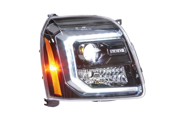

I've been looking to perform this for a couple years, have found a few options and one was the Morimoto XB Hybrid but are only available with the black interior.

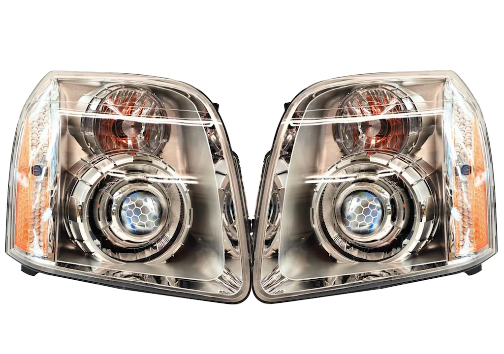

I did reach out to HID Retrofit and was pleased to hear they have the Bi-Xenon LED conversion for the 2007-2014 Yukon and looks very close to a factory product. I wanted to share the link if anyone is interested. This includes the new housings, parts and labor..basically plug and play.
These lenses have an optional honeycomb but you can get them without it. Color temp is 5K which for me would be the upper limit and likely much easier on the eyes than 6K.
What is the benefit of the honeycomb?
Pretty much for aesthetics. They can laser etch different things in the lens with no adverse effects. You can also leave it alone and keep it original.

I have had the Morimoto XB headlights in my 2010 Yukon for 2-3 years now - and they're great. My truck is silver - and I think they look fine. I can say I think the Morimoto's are probably the best headlights I've had in any vehicle I have owned. They're a definite upgrade over the OEM lights.
I wanted to customize my own headlights with the Morimoto projectors, but ultimately decided on the XB prefab. With the additional LED switchback turn signal bulbs, they are second to none. I have had them over a year now and they are awesome, possibly the best upgrade I have done.
I was a little hesitant about the C shaped DRL but it really fits well and hides the ugly of the original ugly of the weird Yukon shape.
