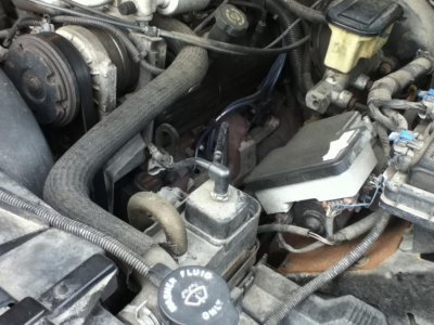

Alright so here's what I just did:
I unplugged the relay and tried to start it, no beans.
I started it and pulled the relay, and it died out. (hold in mind it wasn't warmed up yet, but oil gauge read 40 psi) I did however unplug what I think may be the fuel pump switch, there is a black block near the front drivers side that has a fuel line from the frame going in, and a line going out to the injectors. on this block is an electrical box with a plugh that has what appears to be a weather ridden grey and orange wires. I unplugged that, it had no effect on the engines behavior whatsoever. Let me know if you want a picture, i took one because it's hard to explain.

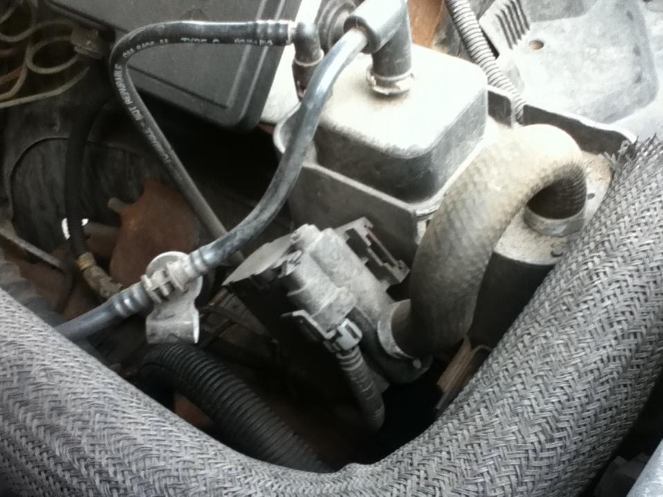

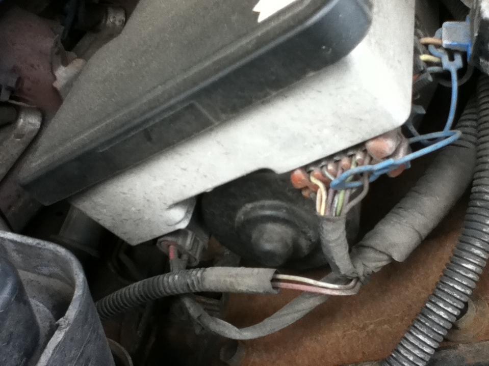

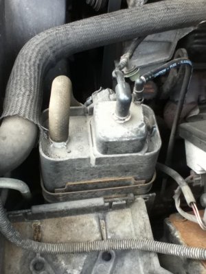

Okay here ya go. The first two are of the actual unit I'm talking about with the fuel lines in it. There is a feed from the tank connected to the top and a line coming out the bottom that goes somewhere on the intakemanifold. The third picture is of the plug I'm talking about, when unplugged it makes no difference with the starting/running behavior of the truck. And the last pic shows where that connection goes. If you need any more explanation etc. Just let me know.

Sorry to burn yours beans but that is the Evaporative (EVAP) Emissions System for fuel vapors which does not address the pump issue. I am afraid we are back to square one.
---------- Post added at 07:53 AM ---------- Previous post was at 07:50 AM ----------
So before the pump you hear the prime but after fix no. Silly question do you hear it from the back of truck when running. Trying to see if it is just really quiet now and perhaps a check valve or regulator is flipping out.
---------- Post added at 07:56 AM ---------- Previous post was at 07:53 AM ----------
We know the relay works and disconnecting the evap vent valve is not applicable here.
