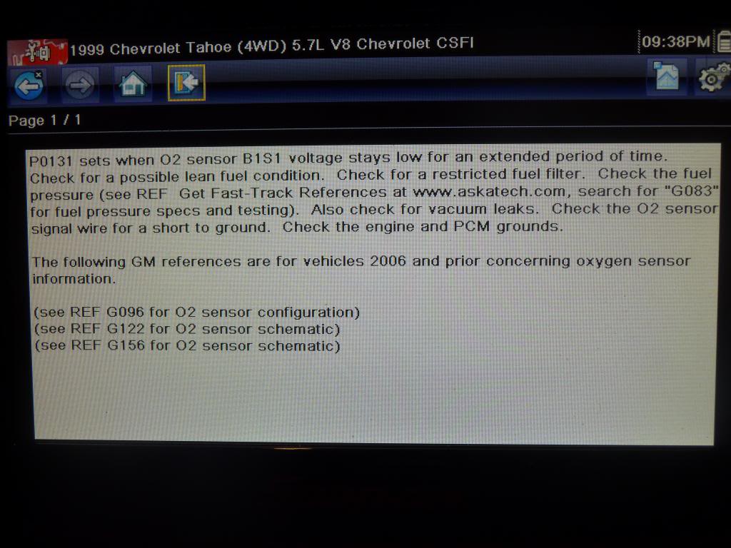

So what did the code say?
Besides O2 sensor ??????
Heater, circuit high voltage, low voltage, etc... bank 1 sensor 1, bank 1 sensor 2, etc....
trevcda
trevcda
Oct 12, 2013
101
11
Vehicle details in signature. As I said, I cleared it before writing it down, but Bank 1 Sensor 1 rings a bell. At this point I was just hoping to do a little light reading within the forum on the subject, was unable to perform a search using "O2" as a parameter.
kcb37
Oct 31, 2013
169
Your sig does not tell much.
This is one out of 4 sensors. See why we ask?
Also any modifications, this scanner is thinking everything is stock, no aftermarket muffler, air filter, etc...

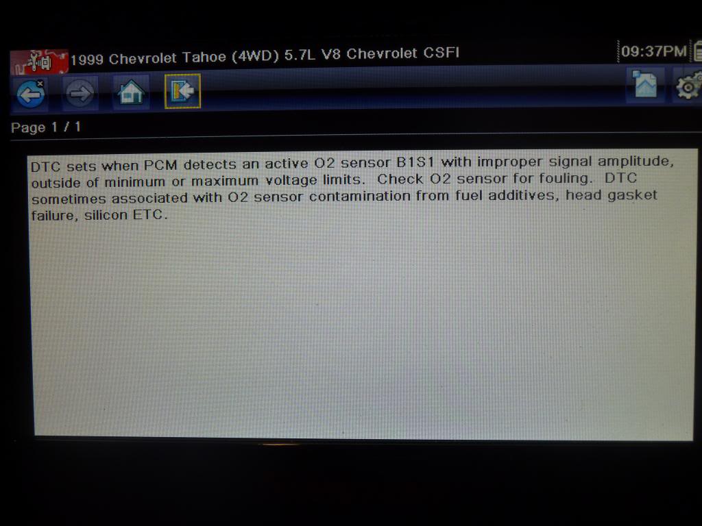

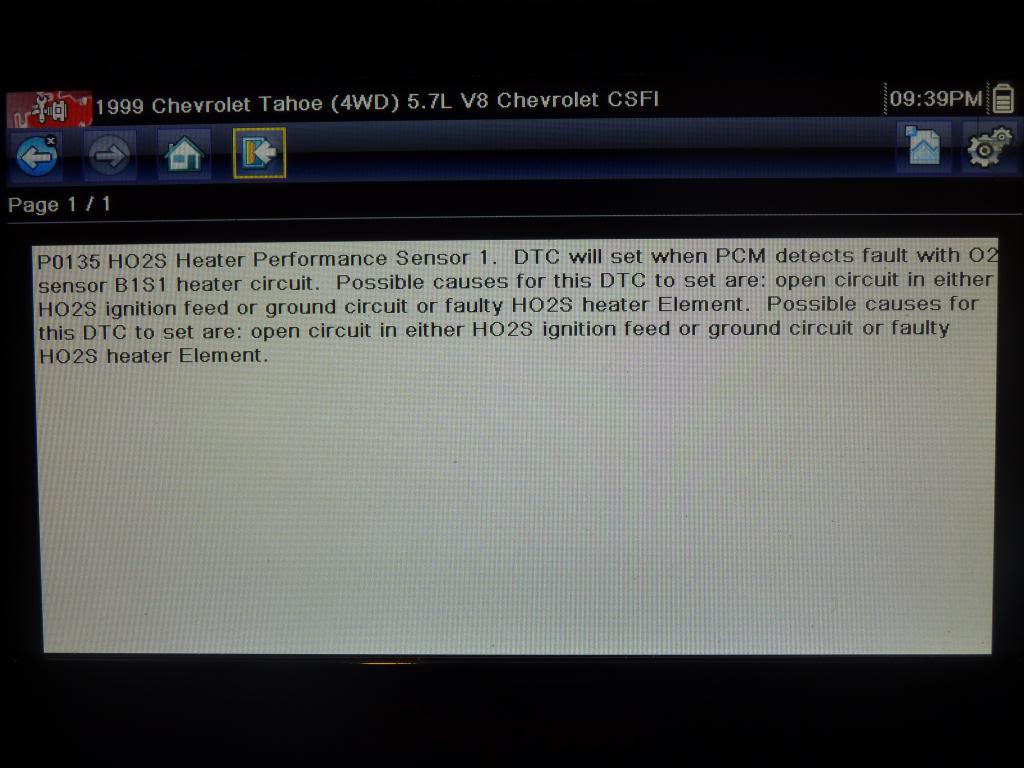

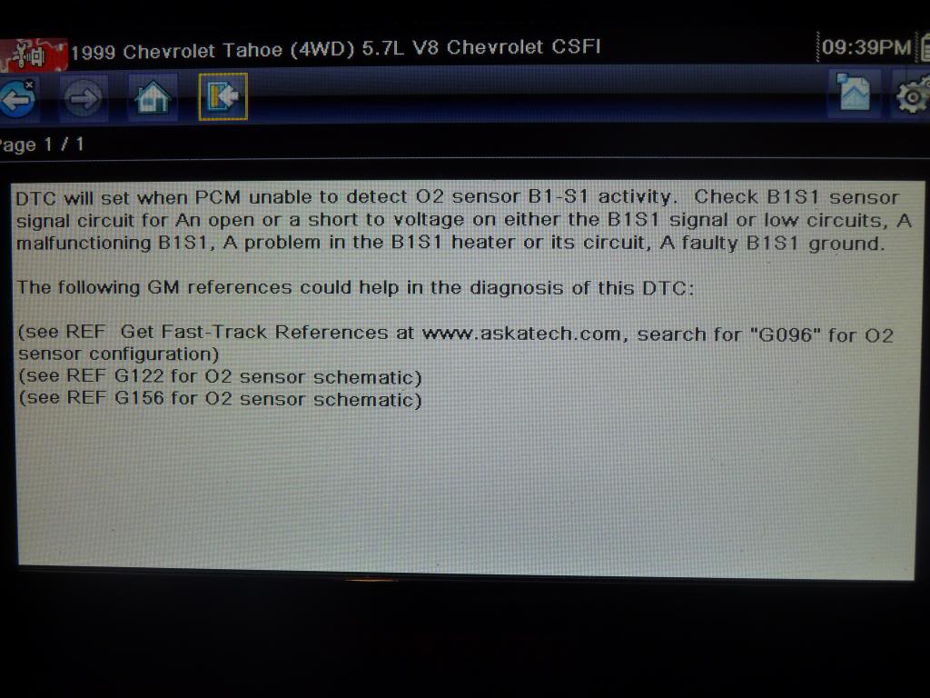

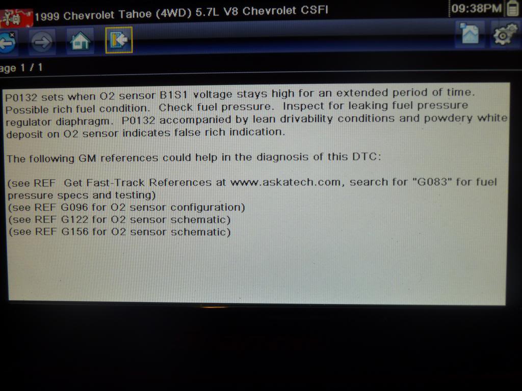

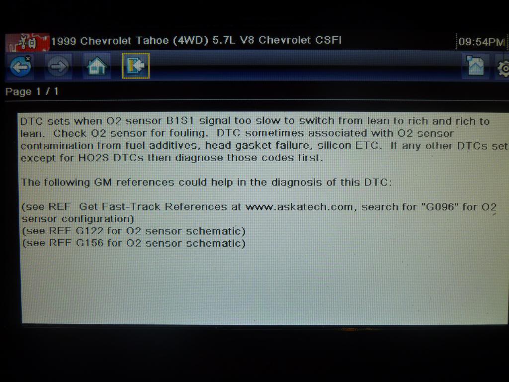

My scanner asks for
Chevy
1999
Tahoe 2wd/4wd take a guess 4wd
5.7 or 6.5 Will take a guess more then likely gas so 5.7
Air pump or no air pump, will take a guess no air pump
P0130
P0131
P0132
P0133
P0134
P0135
2000tahoeZ71
Jan 13, 2014
236

If it does come on, the askatech web page does work, just search the reference number.
You can thank Snap On for the info, straight off the scanner.
Keep in mind all of those codes are for the bank 1 sensor 1 O2, you still have 3 more sensors which none of those codes relate to.
Other then it would say the same thing just a different code and sensor.
