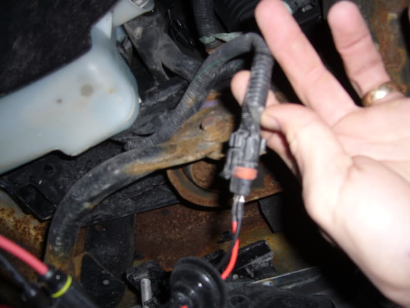

I have not finished assemply yet as seen by the ballast on the ground. However, I have come in to some questions for those of you who have down this mod.

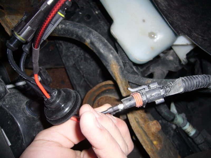

Ultimately, the part that goes into the factory wireharness is two spade type connectors, as there is not a female adator that fits into with the kit. i have tried to illustrate in teh pic. It works, but the harness where it connects to the factory wiring now has two exposed spade connectors slid into it. Not water proof in the least. Is this normal? did I get the wrong kit. Ultimately I could just clip it and solder or connect the proper wires but I might want to reverse this some day.
your thoughts??

Looks like it might be the wrong kit. SOme come with both, send it back if you can otherwise you would have to splice it or wrap it up real good with tape

That's exactly what I got, too. It works fine, fellas, just a different setup.
All I've done to seal it was wrap it real good in electrical tape. You could probably get some silicone and dab it around the connections for a better seal, too, but even then I'd still tape it up. Try to mount the ballasts and wiring as high as you can, though, to keep as much road muck and water off it as possible.
It's break-up in Alaska, and we've got some monster puddles going on, and thus far everything is working fine.
When I got mine installed, I didn't question the connection. The tabs go right into the slots, easy enough. Didn't even know there was a plug-type setup until later reading some of the other HID threads.

Oh boys, I have found an even better solution. So, the reason that the harness does not fit together is that the male end of the OEM wires coming from the source(engine bay,loom, wherever, has the prong receptacles(maybe its female) too narrow. On top of that, there is a small semi-circle tab that does not allow this plug to slide into the DDM Ballast.
Solution, use needle nose and move (bend) the metal prongs from within the ballast receptacle so that they are narrower. It barely needs to bent. Now, shave off that semi circle. Now the factory wire plug can slip right into the ballast. No need to use the Jumper supplied by DDM. I will admit, the fit is not perfect and you cannot get the tabs to lock. But, it is easier to seal this up with electrical tape than the 2 exposed spade connectors.
