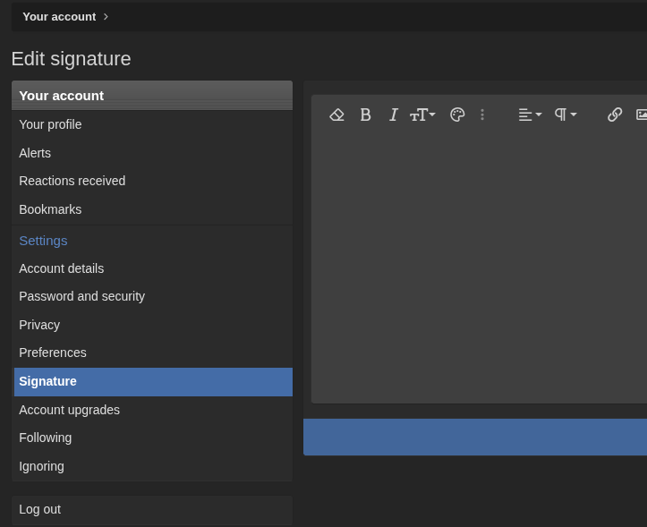

Go to your "account" and put all that vehicle info in your Signature. That way it pops up every time you do a response or post.

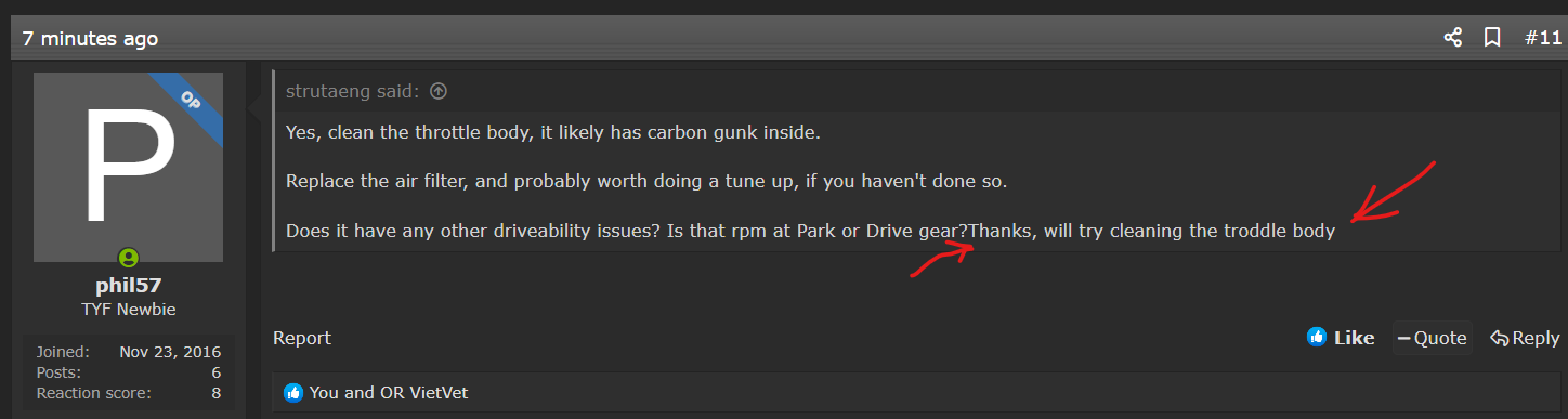

When you quote someone, you need to type a response.
It looks like he did, but his response got put into the quote itself:
Oh...strange...I can't do a muilti-quote, so I did a snipit.

Do you add the specs in the update status? Not sure where to add the specs.
