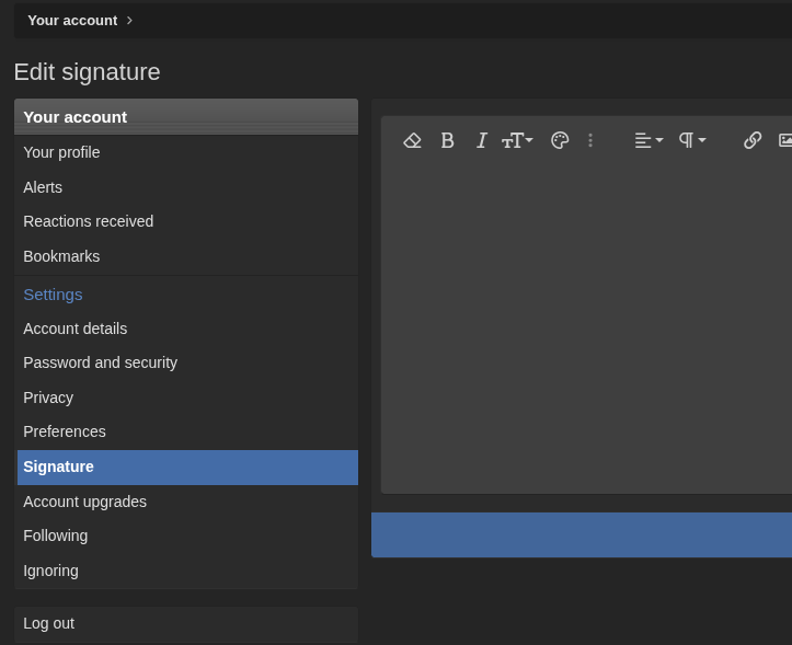

Thanks, added specs but not sure I have limited slip on diff., Think it would be labeled as G80 but don't se any reference to it in my info.
The absolute first time I have seen someone put the RPO code, in their signature, for the A/C and Trailer Package. I love it!!!!
I am a little peeved that you did not include exterior and interior colors though. ;););)

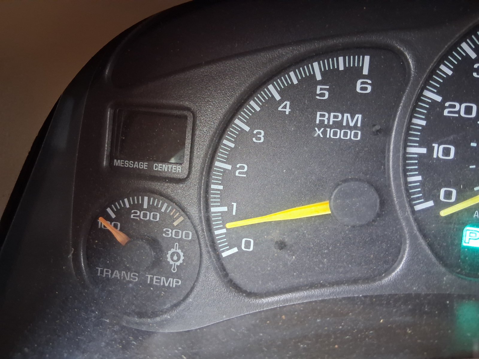

I paid a little attention the to the tachometer on my 99 Silverado yesterday...looks like in P.
Have you hooked up a scanner that has live data? That will show what the actual rpm is. I don't think the cluster has super high resolution TBH. Maybe the needle on the tach was removed to replace a burnt bulb and reinstalled a tiny bit off? You are not the original owner, right?
I'm still not convinced you have a problem? You'd may have a CEL light on if you had a problem with idle RPM?
I believe on these engines you could alter the idle RPM via that screw on the throttle body? I can't remember now. Or increase the RPM on the tune.

I may have missed it, but how does the idle value compare when using a scan tool to read it?
Engine RPMs read 550 on scan tool with engine temp 195 after warm up. Engine idles higher at cold start (seems normal for cold start) and comes down to the 550. Starting issues seem to have gone away, seems like no more none starts when key turned so far. I have no engine codes on scanner either. The intake side of the throttle assembly had a black carbon film on it. Some on the throttle flapper edges and hole (on engine side) but not any on the intake side between throttle body and MAF sensor. Looked like the intake chamber on engine has a slight carbon residue build up on it also. Is there any additive I can use to try to clean or eliminate it?
Thanks for the input. Did use scan tool with live data and RPM's at 550 w/temp at 195. I'm thinking I'll try the adjusting screw to see if I can hold the 625 RPM's with running temp and no cold start issues down the road. Otherwise I'll see if the PCM can be programed to hold the 625 idle in the future. Thinking after 25 yrs of having the throttle resting plate hit the adjusting screw could have warn to the lower idle position vs the PCM being off. Seems the no start issues went away once I cleaned the throttle body and MAF sensor. So could be the low idle is a non issue. Only time will tell now. Don't have any stalling issues or rough idling issues and no codes on scannner.
