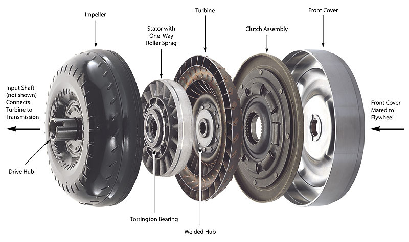

Offhand I'd say that is the torque converter. But you should get a proper bi-directional scan tool to accurately tell you what the problem is. The Tech-2 and the shop manual go hand in hand. You can get shop manual by subscription through AllDataDIY probably and pick up a Tech-2 from China.
The vibration could also be from the clutch in the torque converter.

There's a clutch inside the torque converter?
