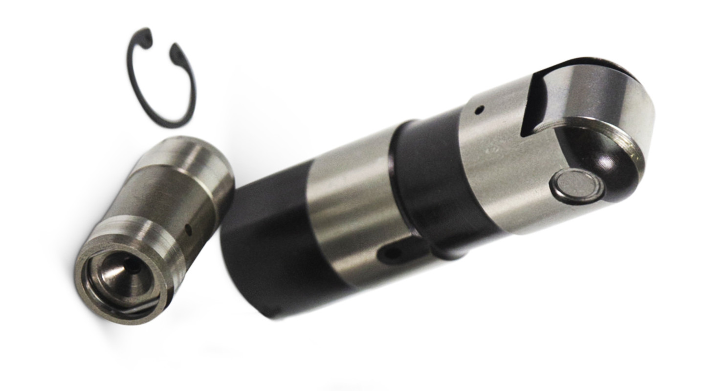

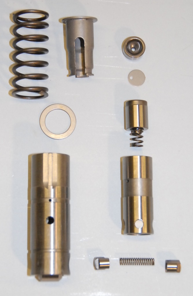

The early lifter failures are probably due to the heat treatment issue noted above, but it's much more common for the lifters to fail after 80k miles or so, almost a sure thing. Looking at the actual parts and studying the operation it's pretty easy to see why. And to add to the misery that AFM and the programmed slipping of the torque converter lock up clutch destroys the clutch, and the transmission with all the debris. Comparing the lifters:
Standard type lifter"
GM AFM lifter:
GM AFM lifter:
Good photograph of the lifter. I find it interesting that the almost never shown component related to the failures is the little oring that seals between the block tower for each cylinder, and the volm assembly. If this oring is damaged or re-used, a leak of oil occurs and the lifter cannot maintain the locked-in condition.
