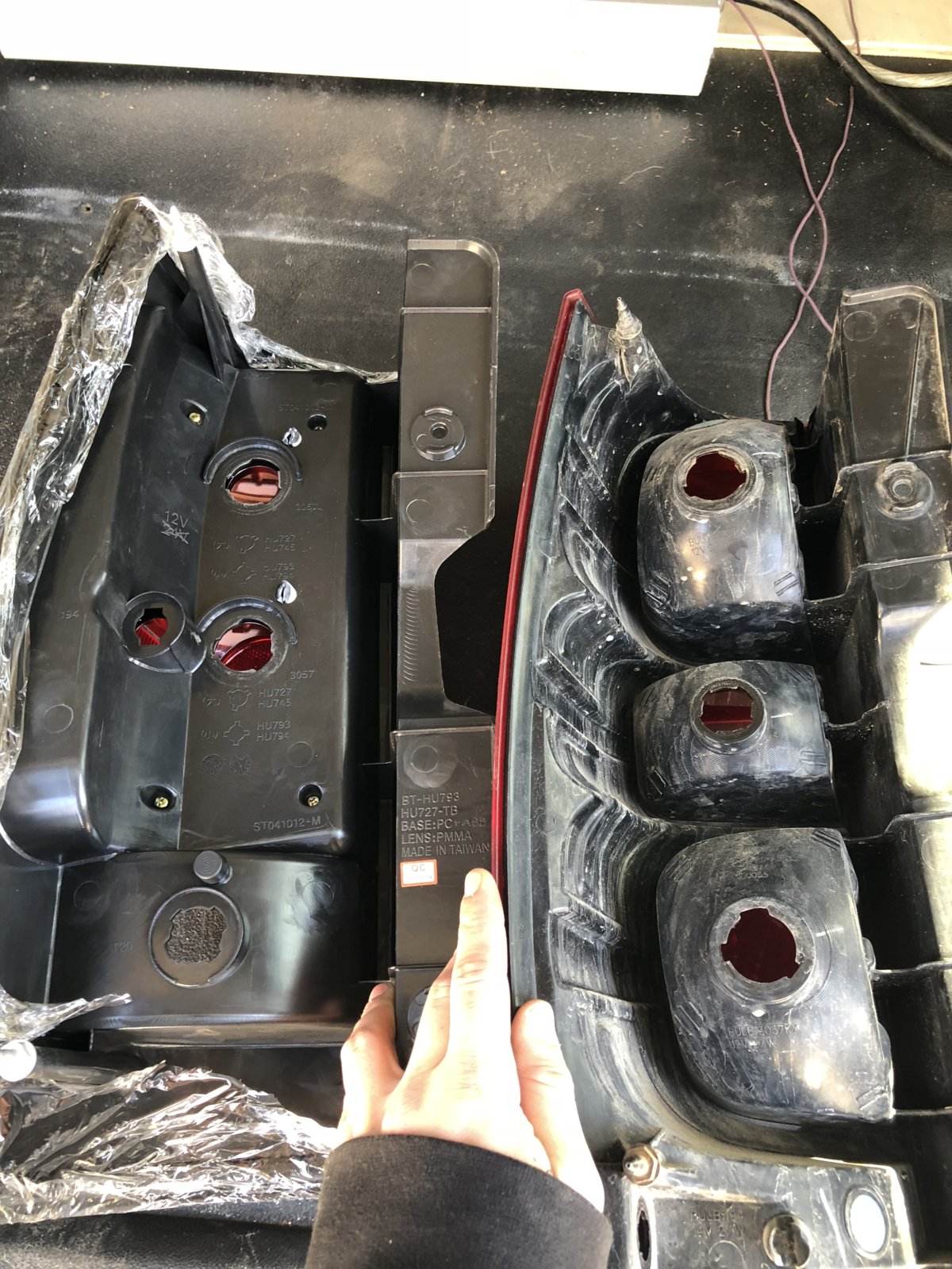

I bought some spec d tail lights off eBay. They fit the truck but where u twist the bulbs into the tail light housing doesn’t fit. The bulbs don’t go into the hole.. I could cut the holes out and glue the lights in place but who wants to do that to tail lights that should be plug n play.... anyone else deal with this problem?

I’m prly just going to return the tail lights. They should be plug n play and there not.... I don’t wanna have to cut them up and glue the bulbs in because when u twist them to lock them in they don’t lock. I bought spec d tail lights but the lights don’t say spec d on them they say junyan so I think eBay got me ripped off

use them, the bulb sockets being a little small is normal for repops, just use a box cutter and trim the holes just enough to fit your socket in, it's just plastic I've had to do it numerous times.
