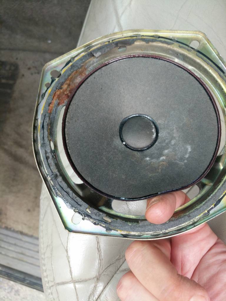

One more question - is this speaker okay, still? [emoji23]
New Sony's are in. I can now listen to music! That sub still needs addressed but one task at a time. Thanks for the advice, gang!
Happy father's day, if it applies to you as well!
Sent from my Pixel using Tapatalk
That speaker is NOT okay. It is ready for the trash.
