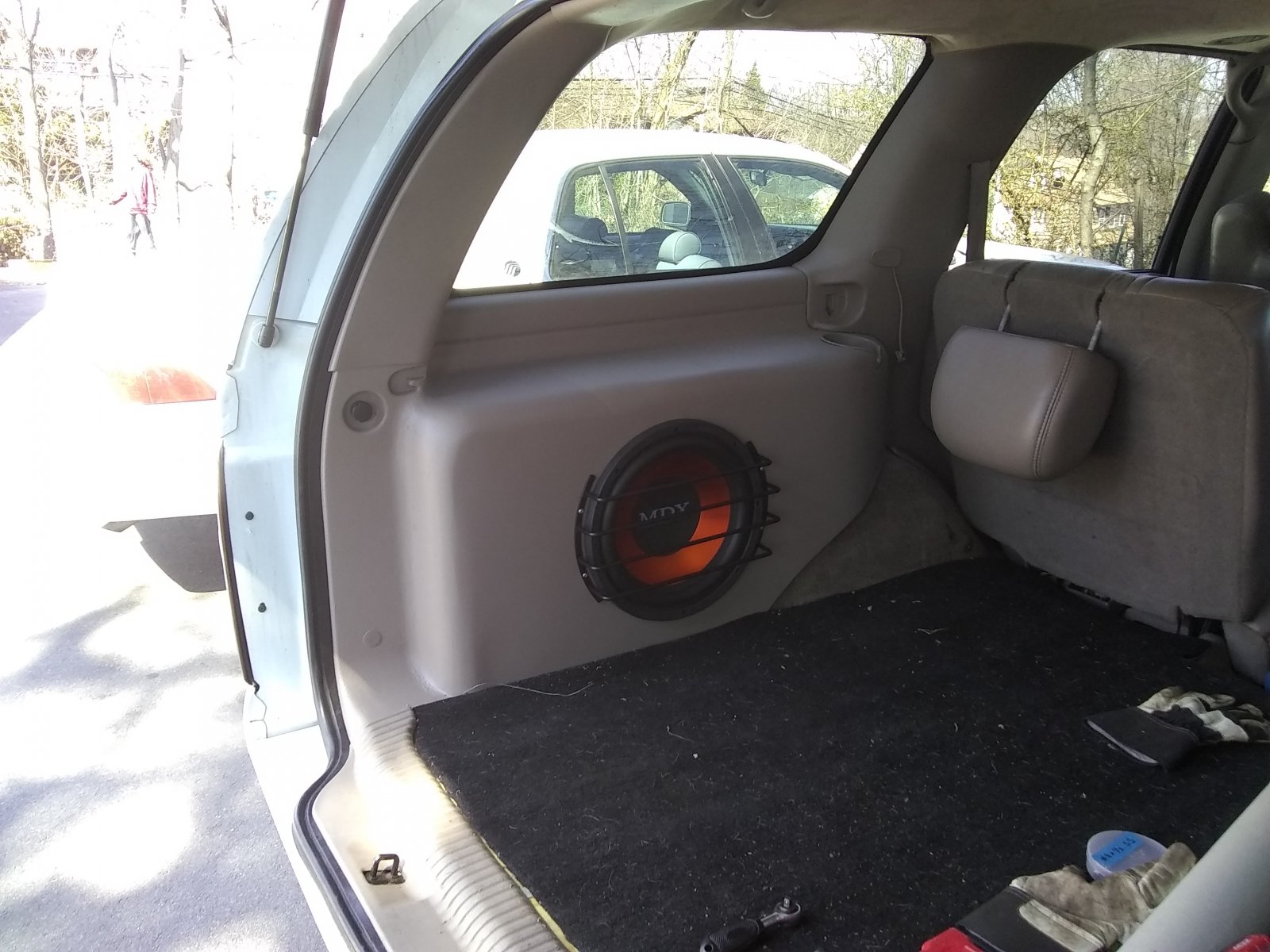

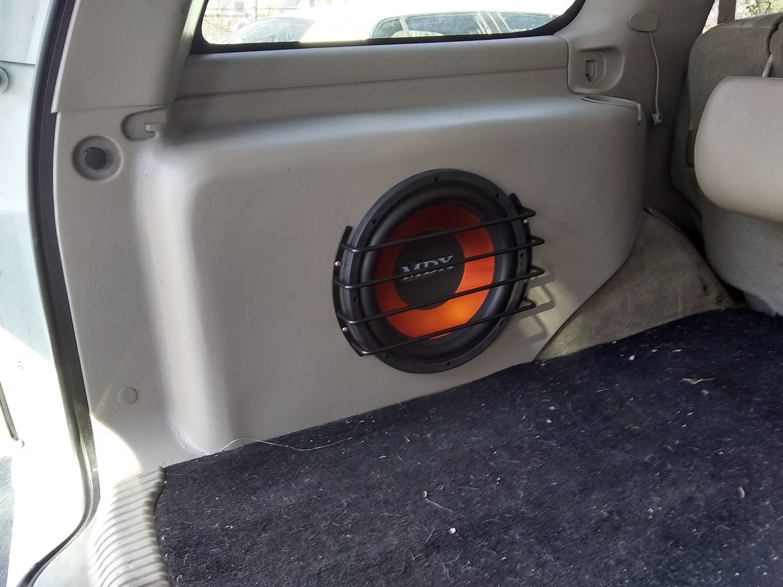

FIRST AREA: Rear panel on the drivers side. On 01-02 NBS, there was a factory subwoofer option for an 8" subwoofer. This will fit in all years, you just need to move the mount. Here is the best thread I know of that will discuss what will fit in the factory enclosure.
https://www.tahoeyukonforum.com/thr...woofer-drivers-to-fit-in-01-02-oem-box.74175/
Later on it was moved, and the only mass produced enclosure (that I know of), is the MTX thunderform. They are incredibly rare to find. If you go to the Man Mall/junk yard, take a quick peek for one, and you might get lucky..
Your last option for this location is to make a custom box. Here are a couple threads that should at least give you enough of an idea.
https://www.tahoeyukonforum.com/threads/stock-location-subwoofer-set-ups.76441/
https://www.tahoeyukonforum.com/threads/custom-box-replace-factory-location.20475/

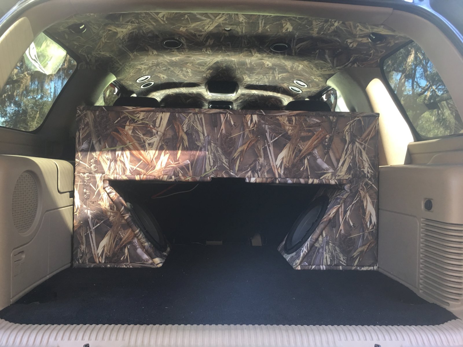

Apr 17, 2019
51
44
Very nice looking box Motorsport. I did a similar box in the same area with two JL audio W3’s in a custom fiberglass sealed enclosure wrap in grey vinyl. Although mine is a 05 Yukon xl it still didn’t effect cargo space much best of both worlds in my opinion. Hits hard and still have total cargo area intact.
Apr 17, 2019
51
44
Very nice box Motorsport. I did a similar box in the same area with two JL audio 12 W3’s in a sealed fiberglass enclosure. In my opinion best of both worlds, great bass without sacrificing cargo area.

I didn’t think it posted apparently I am wrong...lol I guess this is a good way to get my posts up
