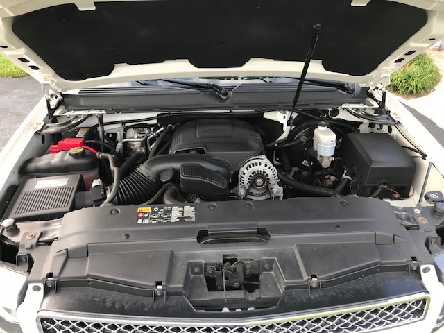

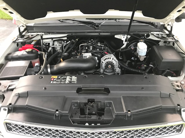

@JCope79
Here are a few pics of my 2013 Suburban with the
AIRAID 200-996 MIT installed on the stock air filter box.
Not sure if there is any difference between the years and trim levels.
OEM
AIRAID 200-996 MIT
