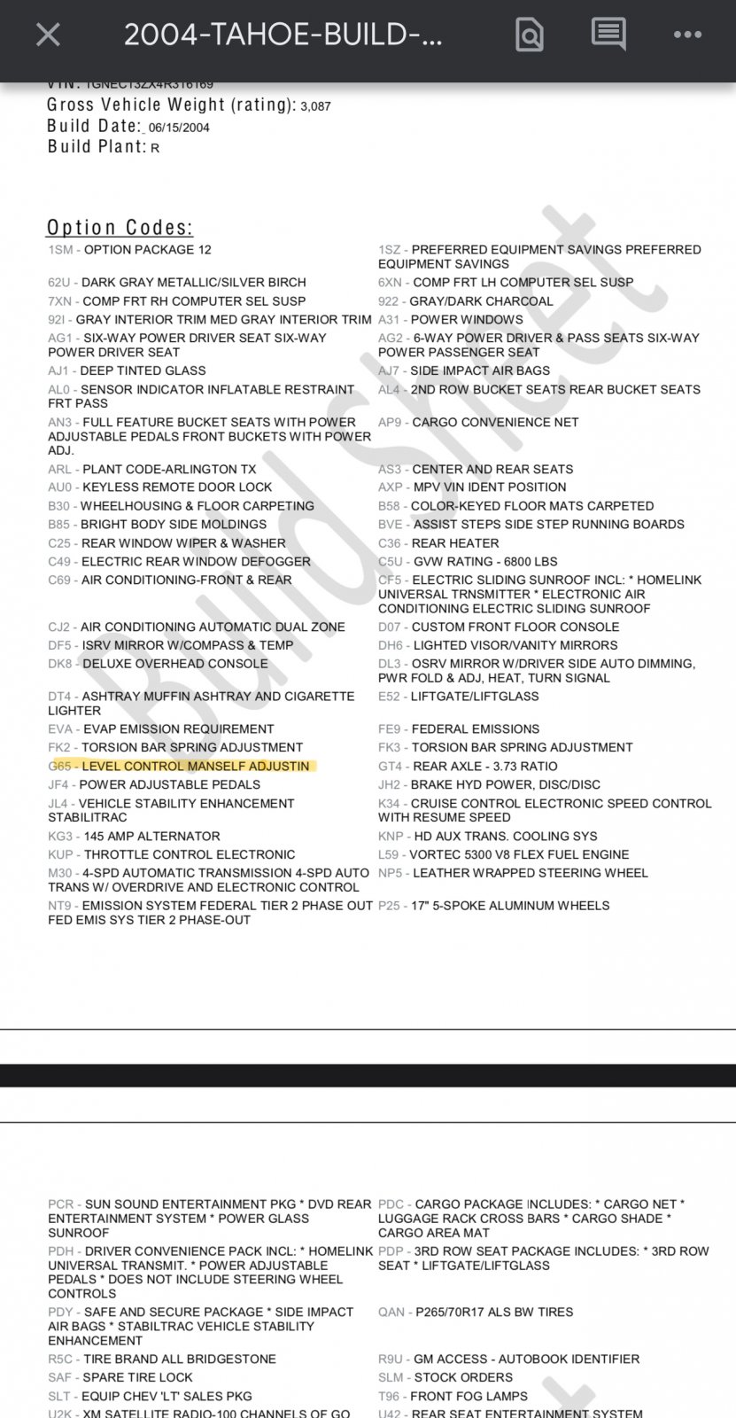

Is your XL 4WD? You didn't say.
Do you have RPO code G65? If you do, those are Nivomats. If not, then non-Nivomat.

G65 is the Nivomat self-leveling shocks. ZW7 is Premium Smooth Ride, which can be a number of suspension parts, and isn't always the Nivomat shocks. Which is why the G65 code is for the rear Niv shocks.
Post a pic of your RPO codes if you want.

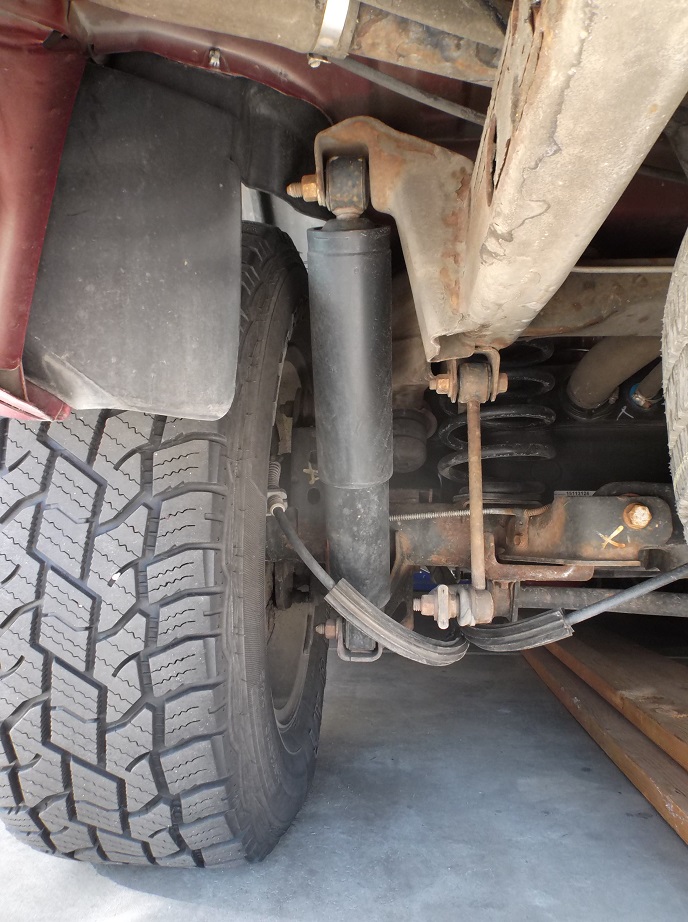

Checking the Monroe site.... It appears, Nivomat shocks have a thinner - lower - looking shaft on the bottom. The photo I took of mine, seems it has a larger diameter?

No G65 RPO code on the sticker, so you do not have Nimovat shocks.

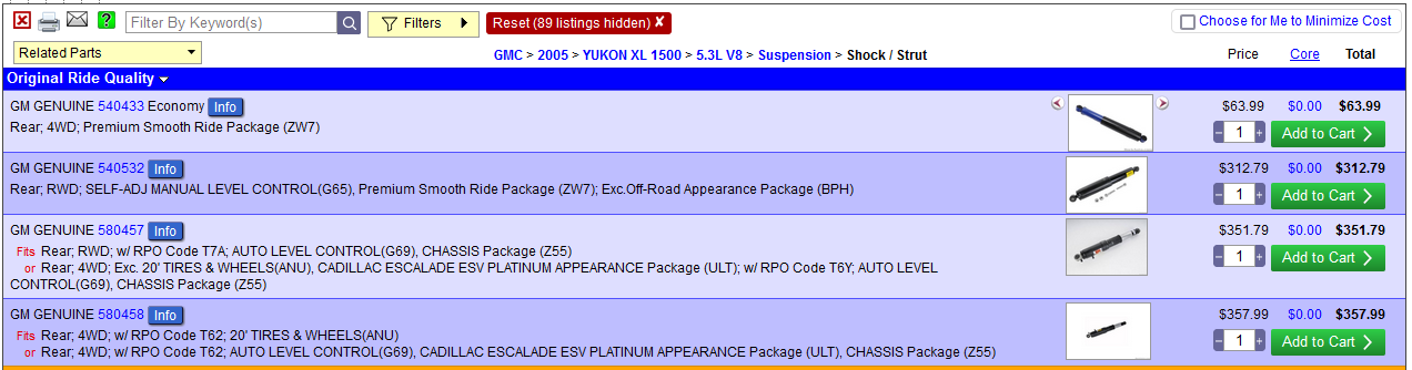

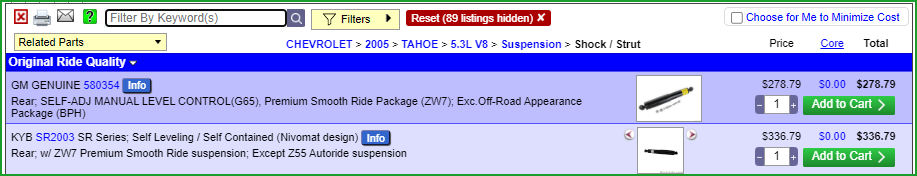

Based on your pic in post #8, I think your 4WD has regular shocks in the rear, first item on the RA list (filtered for GM & rear). The other three are self-leveling shocks and yours do not appear to be that. The RWD chassis seems to have the Nivomat shocks (2nd item on list below).
Can you read any of the characters on the stickers that are on your shocks? Post a pic? How about on the coil springs?
Here's what one of my Nivomats looks like (2004 short WB, 4WD Tahoe); not the same as yours.

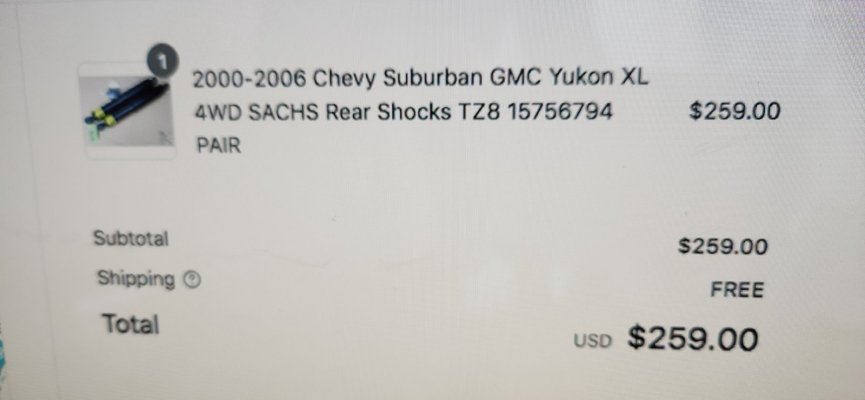

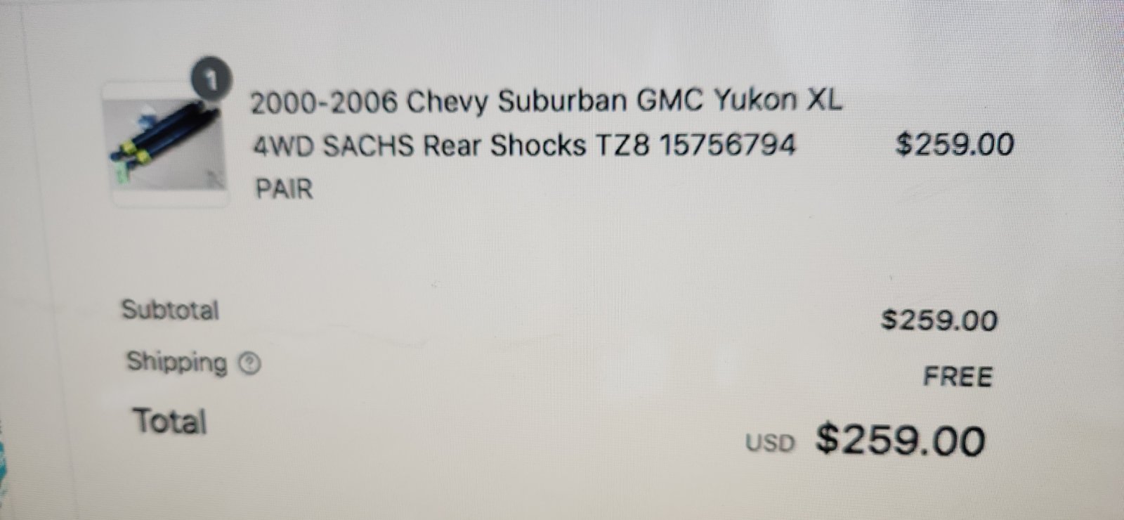

I found & purchased a pair of Sachs " Nivomat" shocks......
Nivomat is the old description of these shocks.......
Sachs stopped using their label..... KYB, etc., sells the "Nivomat".... Made by Sachs.....
I found a SMART guy, who sells only shocks..... I spoke with him for a while..... Buyers get frustrated, due to the multiple "terms" of how the shocks perform..... By the different sellers.

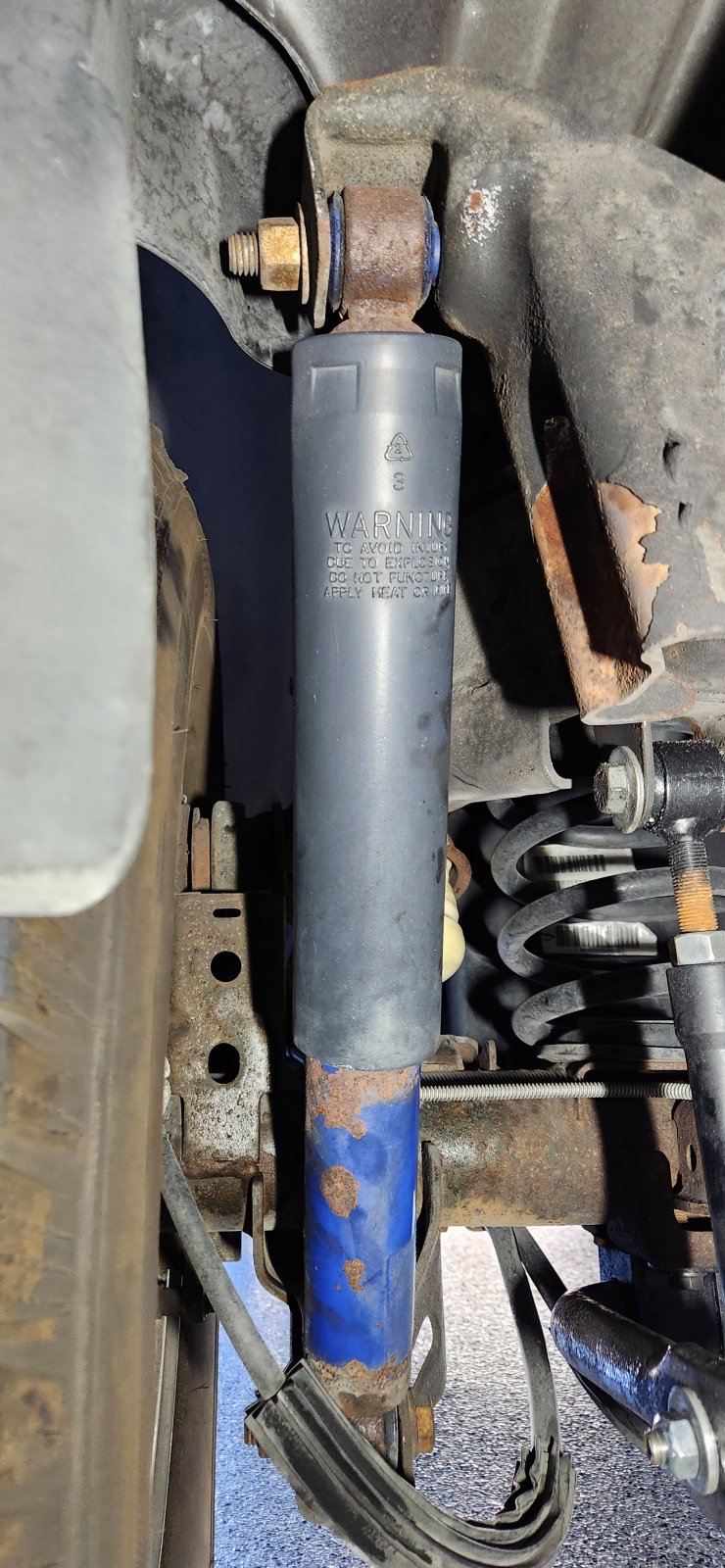

The shocks, on my Yukon.... ( the photo I took )..... Are NOT the correct shocks. They are not the original Nivomat. ( I sent the guy the photo )......
He said, the Sachs shock also supports the rear suspension, in a way, regular shocks don't!!
He said, I am going to love the Sachs..... Much better ride.....
He sells 'used shocks', but they are checked & tested... He spends his time, pulling good / used shocks from vehicles..... Many are low mileage, etc. ( He can tell ).....

Ok, good luck with that; I hope it works out. Nivomat is the technology developed by SACHS, and doesn't necessarily show up as a descriptor on every brand that offers it. Based on what I've seen I still don't think yours came with Nivomat technology for the rear shocks; I could be wrong.
I'd be curious if anyone else with an '05 or '06 4WD XL on this forum has ZW7 AND G65 on the RPO list, or if only the ZW7 code shows up.
If your rear shocks were changed, then, perhaps so were the springs. Better start researching those.
