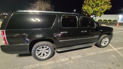

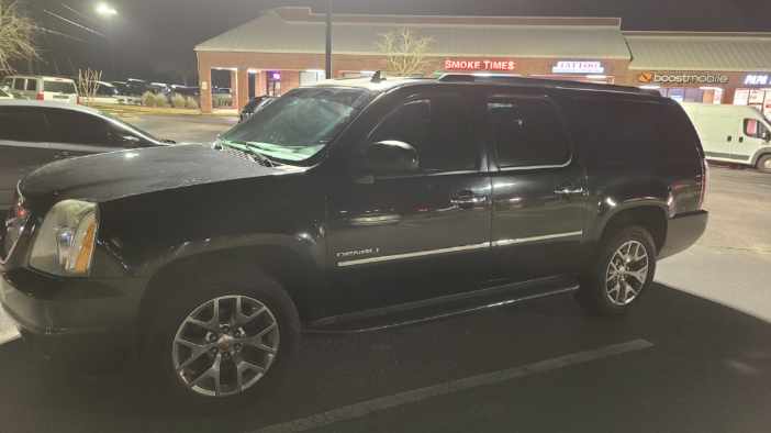

Good afternoon all,
Yesterday I drove from NC to TN to pick up my 2011 GMC Yukon XL Denali, which I bought sight-unseen (never did that before!) from a big dealer in East Tennessee. 174,9xx miles, paid $14850 for it.
Drove the truck home afterward and said to myself "this feels right."
It's like... every time I say I'm done buying GM vehicles, another one pulls me in.
Drove great across those freeways, and I'm especially glad I went for the 6.2. Between that long drive and some short jaunts upon getting home, I'm averaging 17.8 mpg.
I have a few quibbles with it though, mostly due to its age, some due to the salespeople not noticing. Any quick advice y'all might have for me would be appreciated.
1) The passenger side mirror doesn't move with power. Upon quick inspection, it's not even an original mirror. I plan to replace it.
2) While the stock radio comes with a USB input, it can't read all the songs on my flash drive. I'm guessing it's because 16 GB flash drives weren't invented when the truck was built. I do plan to upgrade the head unit, but is it possible to do so and keep the rear entertainment?
3) Went for a drive today, and when I turned the vehicle on to come back home I got the "SERVICE SUSPENSION SOON" message. No difference in ride height or quality though.
4) Why did GM change their garage door opener system starting with MY2011?
5) The reverse camera activates, but there's no image. I hear this is a common issue.
Other than that, so far I'm enjoying the big family/equipment/furniture/trash hauler. Looking forward to participating for (hopefully) years to come.
Obligatory photos below.
