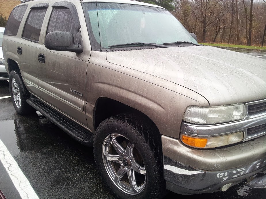

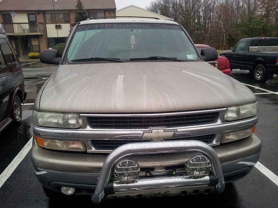

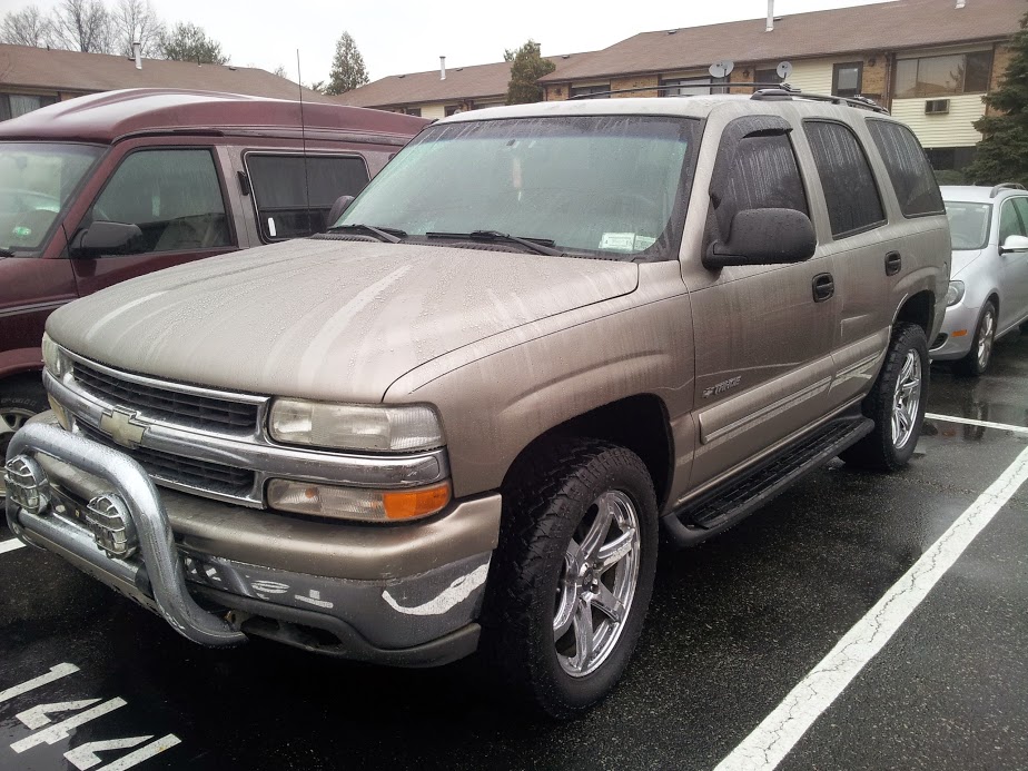

2000 tahoe 4wd, biggest issue no power to the driver door/window /mirror- power lock works for all doors except driver side- broken wire or bcm? stumped- anyway pics-

welcome looks nice.

Welcome. Good looking truck.
Plan on doing anything to it?
Thanks,plans - change the entire interior which I have already from a 2005 z71, electric fan, Bilstein shocks,2008 front brakes
