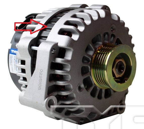

Sometimes the alternator amperage is stamped into the alternator housing, so you may be able to see it on yours. If you post up your Kxx RPO codes we may be able to tell you what came with it as OE.
The 145A alternator will have the center spacer in the case (see arrow below) but the 105A will not.

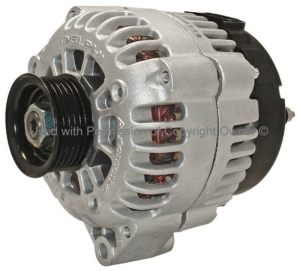

105A:

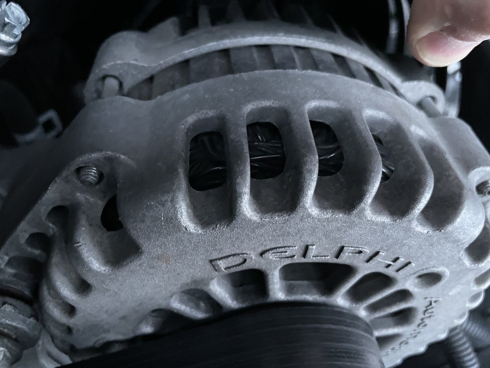

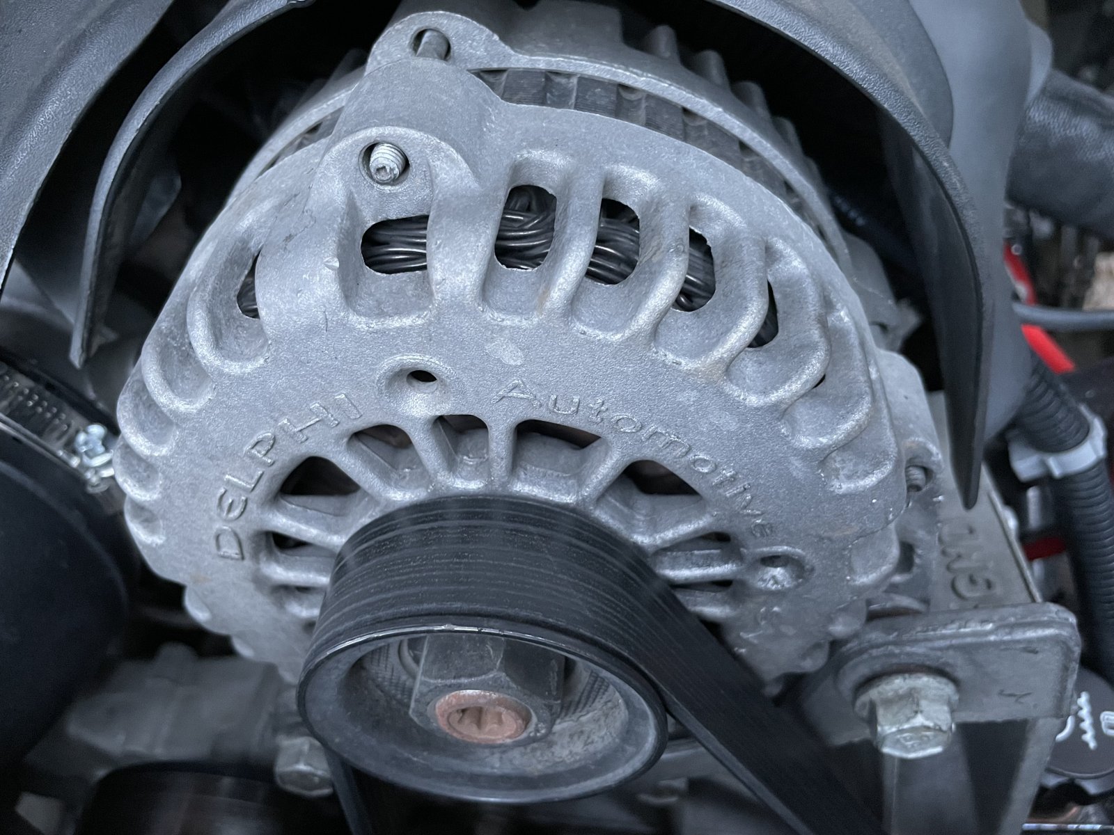

I’ll also look at alternator to see if it has the gap or not. Could have been replaced in the past 20 years.

Good to know I have the 145a alternator. Can anyone recommend a decent amp clap meter or another way to measure what my alternator is putting out?
