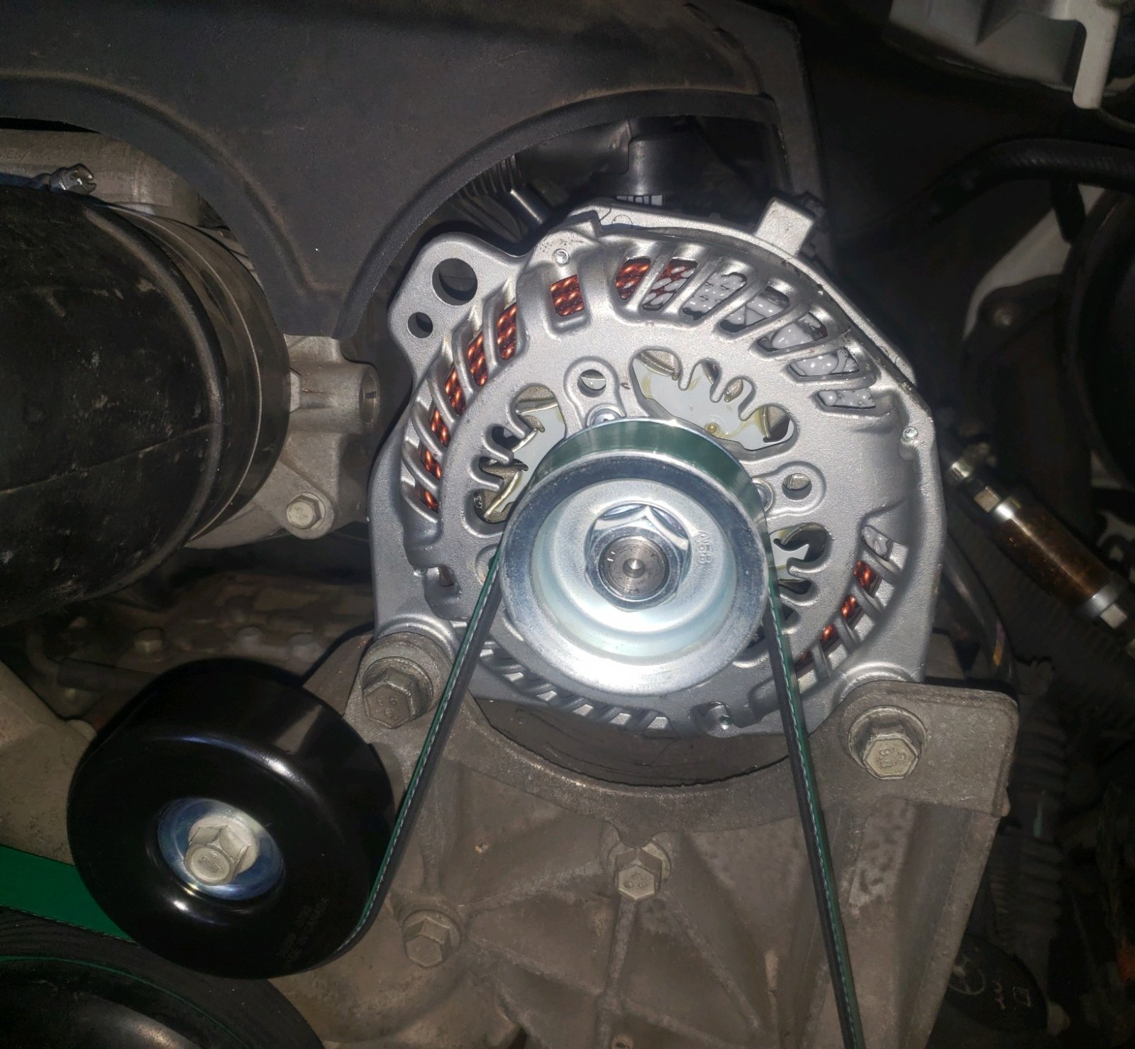

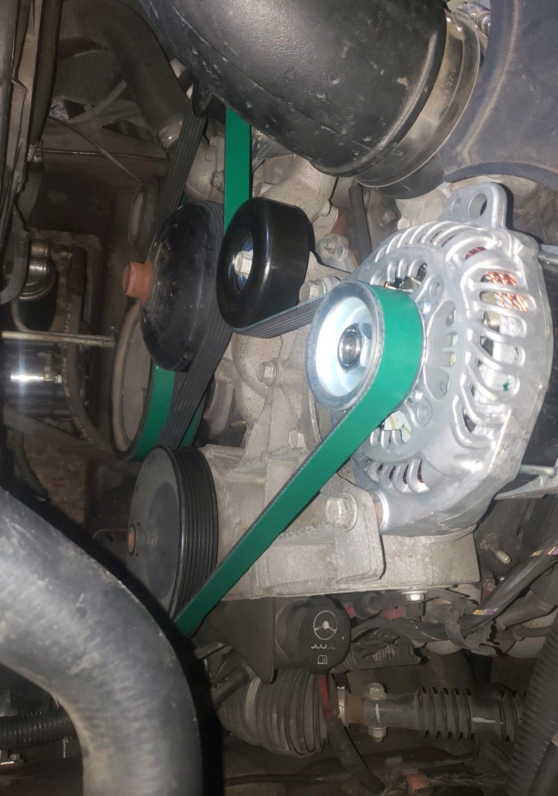

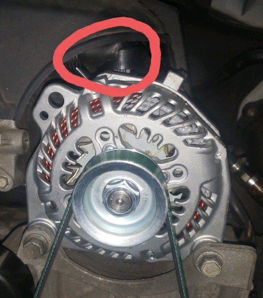

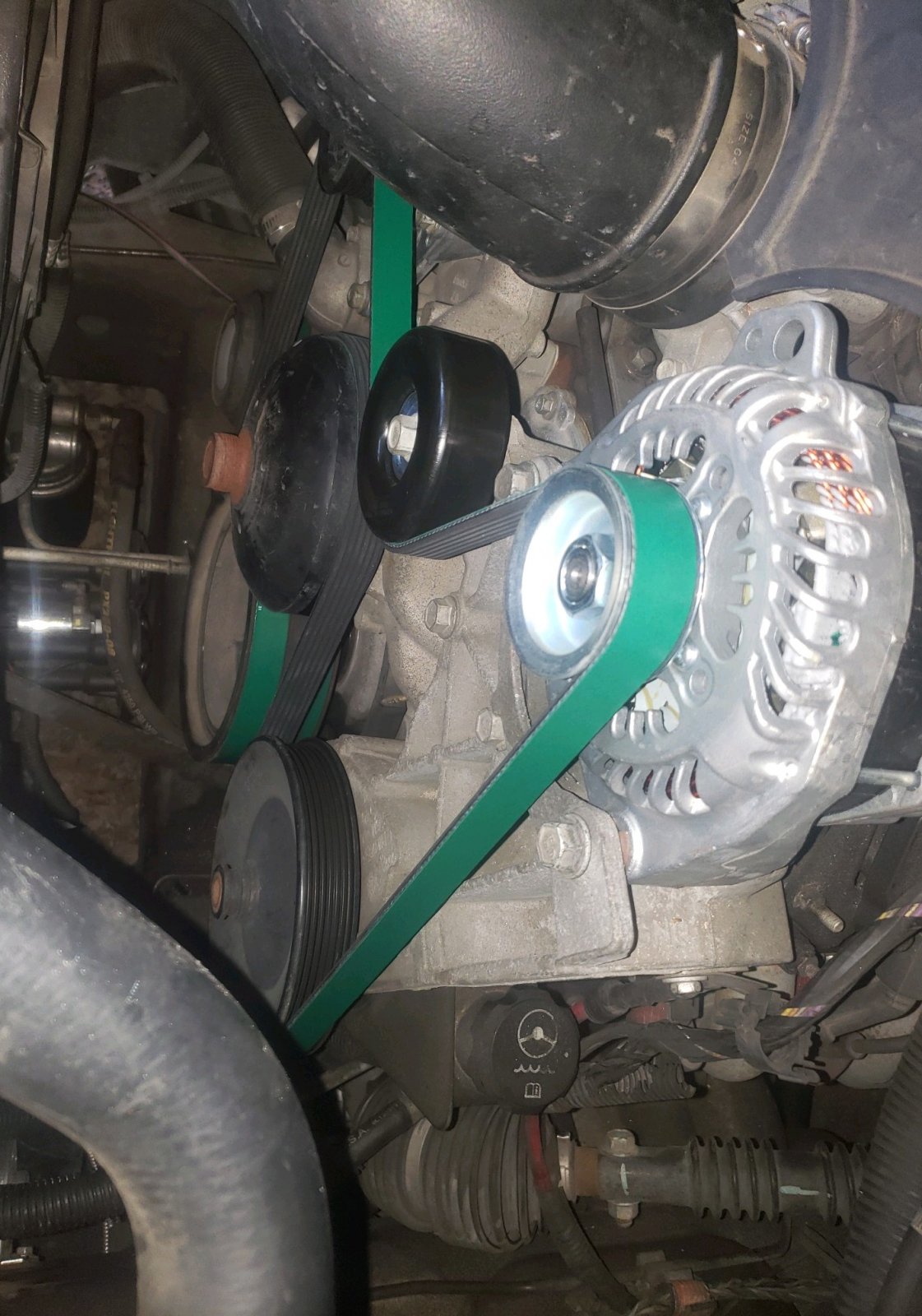

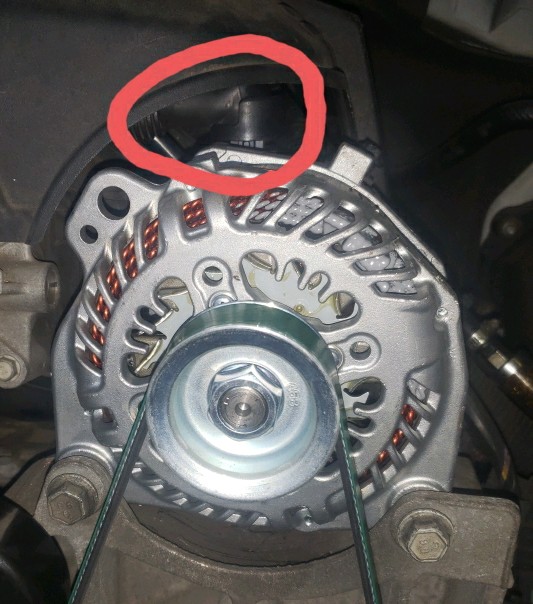

I have a 2008 Suburban, but same thing.
@iamdub did kind of a write up on it in his build thread. It plugs in and bolts up, the bolt holes on the back side are ever so slightly larger than the holes toward the front and you can put a sleeve in them to take up the slack. But in all honesty, I was kind of in a rush to get mine put on since the truck was down and my sleeves had not arrived yet so I just bolted mine on and haven't had any issues with it as is. The sleeves arrived later and I will probably eventually put them in but I'm in no real rush.
Here is a couple pics...
You can see there is an extra "Ear" in this pic, Dub shaved this off of his but it is not in the way of anything and again, I was in a hurry to get the Burb back up and running since the original one took a crop.
And another pic...
I realize this doesn't really show much as far as the mounting and such but as you can see it just fits.
In this pic you can see there is also a 90° adapter on the back which bolts to the output lug/terminal of the alternator. The bolt would be sticking straight up in the pic with the cable coming off and going to the left/passenger side in this picture. DUB took his off, I left mine on and it doesn't interfere with anything and I have marine grade 2/0 cables I built for mine just for reference.
45,016
@kbuskill Interesting, I didn't know that. Just curious, when you say "basically a direct bolt over"...what did you need to do to get the alternator to fit in your Tahoe? And you installed it on your 2008 Tahoe? Seriously thinking going this route now...
As Ken said, it's a direct replacement. I can't leave anything alone and saw room for improvement in fitment, performance and appearance. So THIS is what happened. I destroyed that 90° main lug tower during experimenting so my charge cable makes an odd (IMO) loop. Meh- it's under the cover so it's not visible. Even though the rears of the bolt holes are 4 mm wider, it'll bolt in and be fine as-is. I had stuff to make the rears 10mm holes like the fronts and it only took a few minutes longer to do. I just used some spacer sleeves from an old set of Moog sway bar end links, like the ones standing vertical in this pic:
And another pic...
Awesome! Very helpful Thanks!
Thanks!
