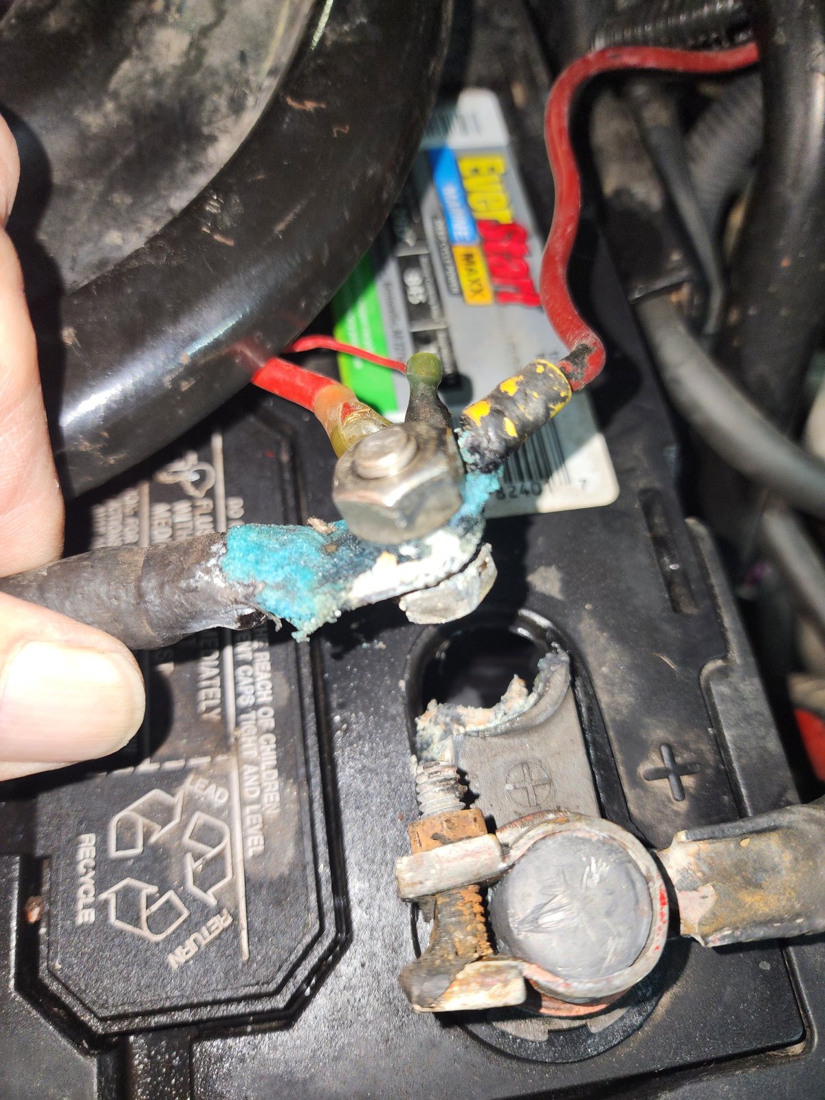

I installed a 350 amp H.O. that had a smaller pulley. Required a one inch shorter belt. Napa parts man figured it out.
I like the smaller pulley for better proformance at idle and improved cooling. Set up for overlanding my power requirements are ridiculously high.
Keep your cables clean.
