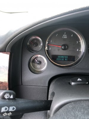

And the nightmare continues. After deciding to have the motor rebuilt in my 2007 Yukon Denali (6.2) I am dealing with an issue that has not been able to be solved so far.
The shop I paid to remove and rebuild the motor has taken the motor out several times since the original rebuild. The problem is when engine gets to operating temp the oil pressure only stays around 8-10 PSI. Seems very low for a supposed rebuilt engine. The rebuilder called me last week and told me it was fixed (wrong cam bearings installed) so I drove 4 hours north to pick it up. After driving about 15 miles I noticed the oil pressure dropping at low RPM’s and check engine light came on. The truck seems to run fine with the exception of low oil pressure at operating temps under lower RPM’s. Any idea on what the issue could be?
$4,100.00 later and I still dealing with this headache. Any help or advice would be appreciated. I do need to manually test the oil pressure to confirm the problem. Do the in dash gauges ever malfunction or give false readings or is that not real common?
Is this safe to drive given the apparent low oil pressure readings?

Let me expand...the low oil pressure is typically at idle and low RPM situations. Typical driving conditions usual oil pressure stays between 30 & 40 PSI.

Yes, gauges and sensors can be faulty. The screen under the sensor may have become clogged or any number of other problems may have arisen during assembly. From not using the right parts to not having cleaned the motor properly prior to assembly. Even the dumbell in back needs to be put in right along with the pick up tube o-ring and on and on.

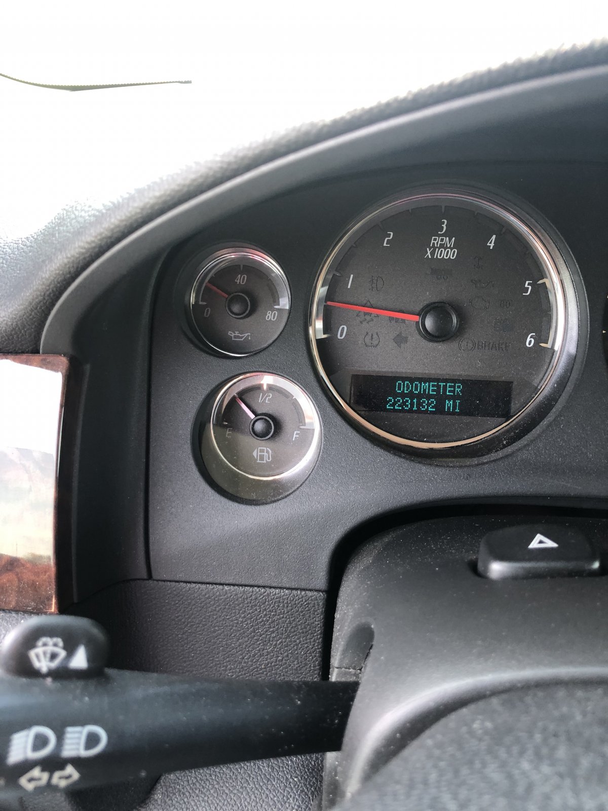

So the idiot engine shop out of western MI did not fix the problem. I still have low oil pressure (15-20 psi) hot idle, & 40 psi idle at 1,500 rpms.
I will withhold their name until this situation is fixed and/or if I need to get legal representation. Their solution now is to change the block to a cast iron block and their claim is that the aluminum block is defective. Do they even make a 6.2 liter cast iron block?
This is the third engine that they’ve installed and the fifth time the motor has been removed and reinstalled. I have spent almost $1k on rental car expenses in addition to the multiple times I’ve had to drive from Indiana to Michigan.
