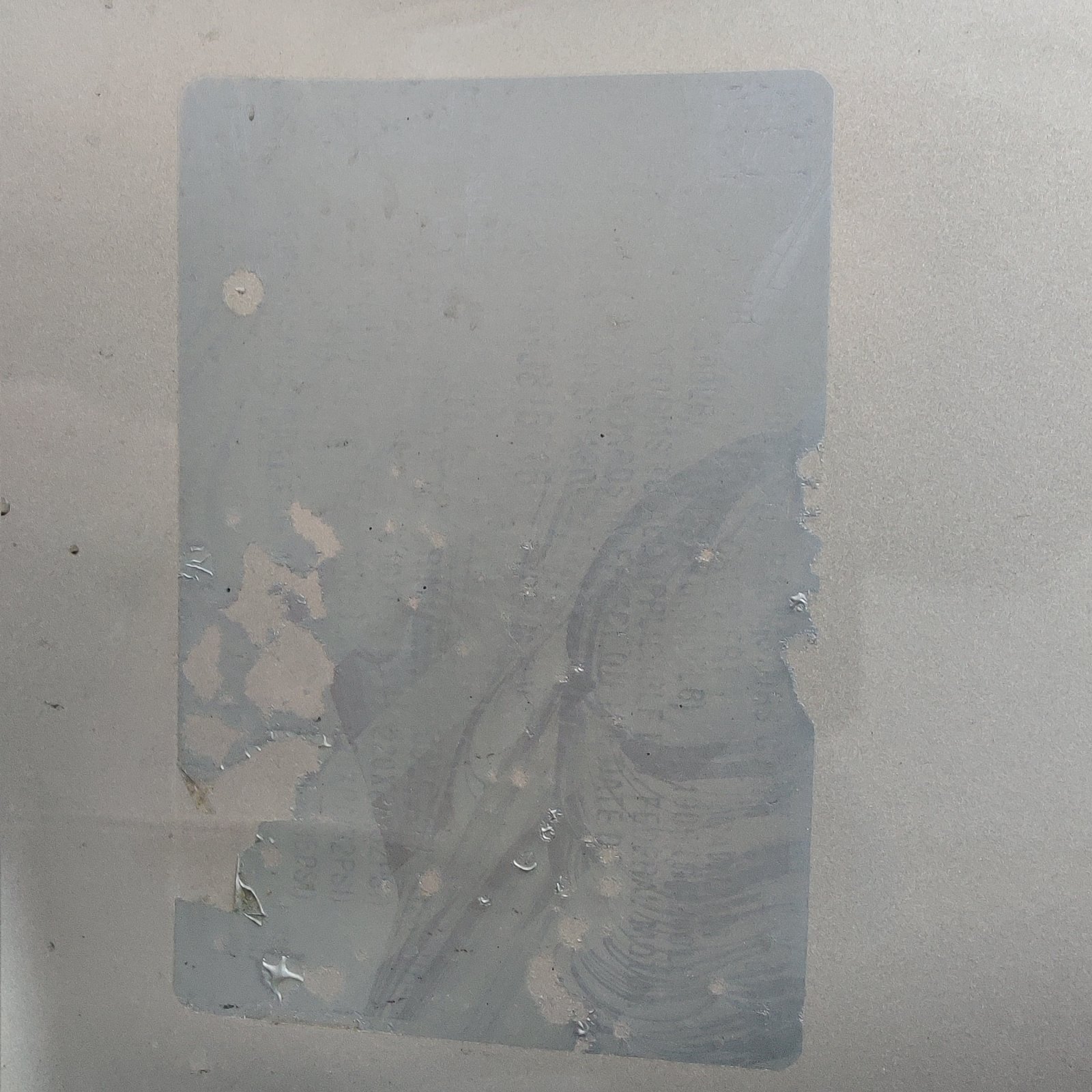

I think I might know the answer to this (im screwed), but hey, I figured id try the forum, maybe theres hope.
I need a new door sticker, the one with the VIN and the vehicle weights on. Im trying to get my XL Denali correctly registered here in Europe. At the moment im only permitted to tow 3300lbs with it, and I want to get this increased to the normal 7900lbs.
Part of the paperwork process requires info from the door sticker. My current one is *****.

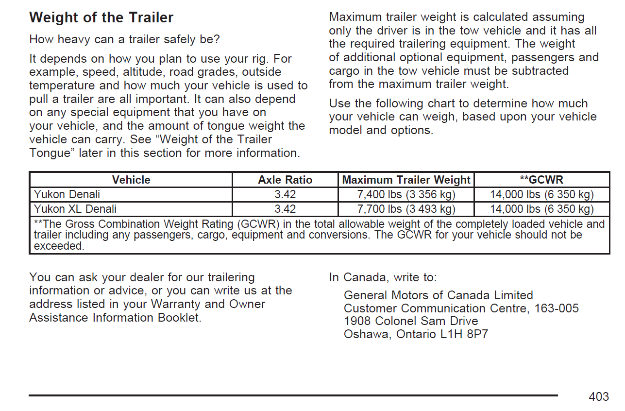

That label does not say your truck can haul 7900 pounds. Also, in 2007 a Yukon XL Denali was rated for 7,700 pounds. Only your owner's manual states what the maximum towing capacity is in that year and the Gross Combined Weight Rating (14,000 pounds) as well.
From your owner's manual:
