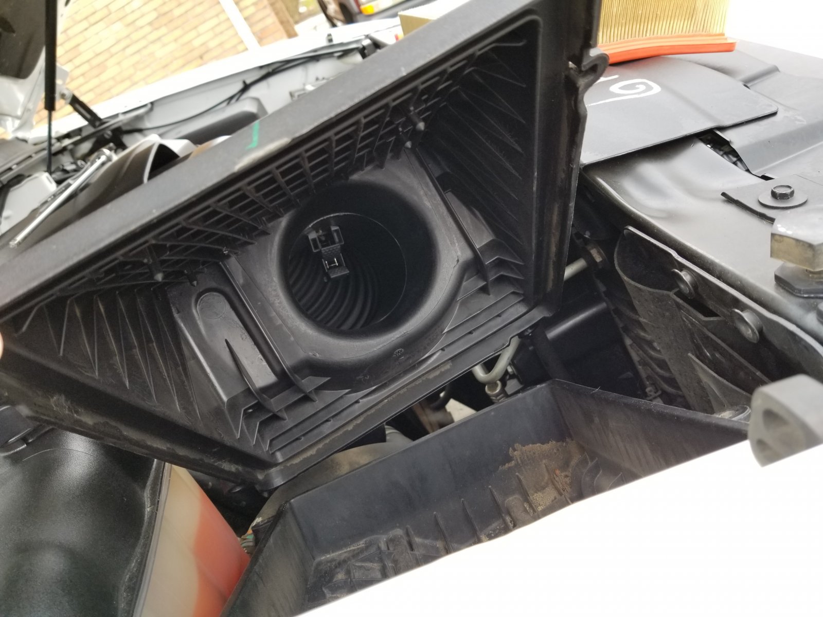

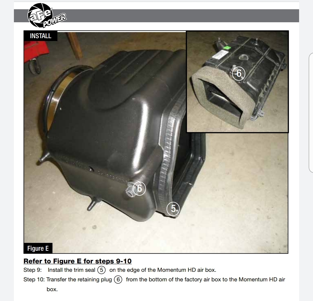

Yes the end is open and there's a hole in the inner fender it goes up against.

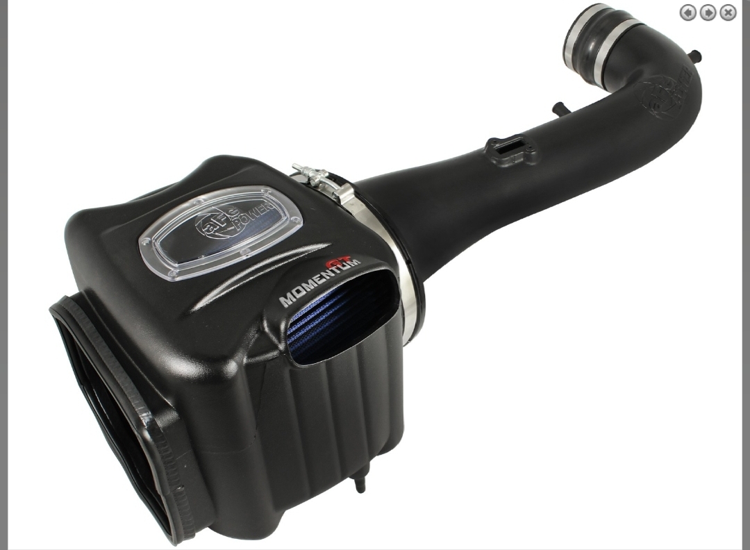

Yes, they do supply a plug for it and I'm not sure if the dyno test was with or without the plug. I figure the more air the better, I know what you mean though because on my old cars my air scoops are above the hood.

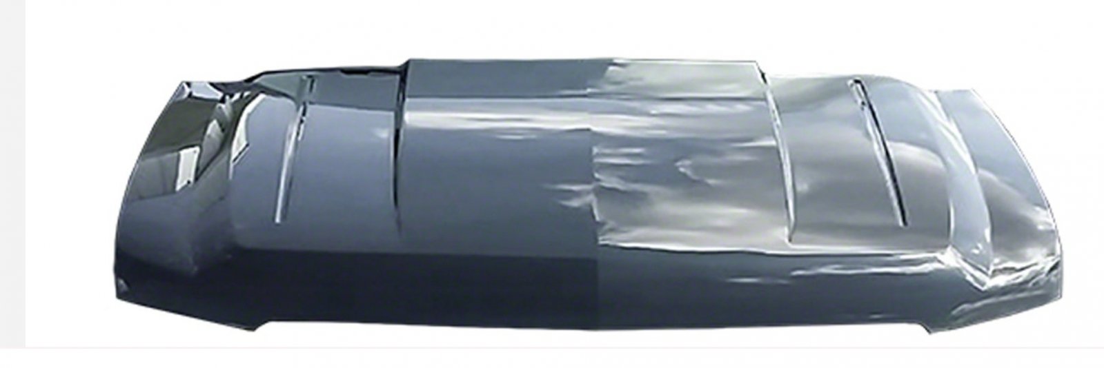

Hopefully the cowl induction hood I have planned will eliminate some under hood heat.

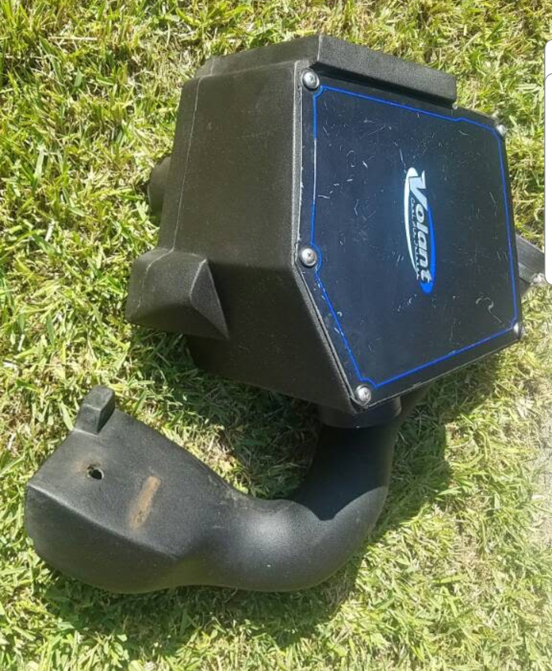

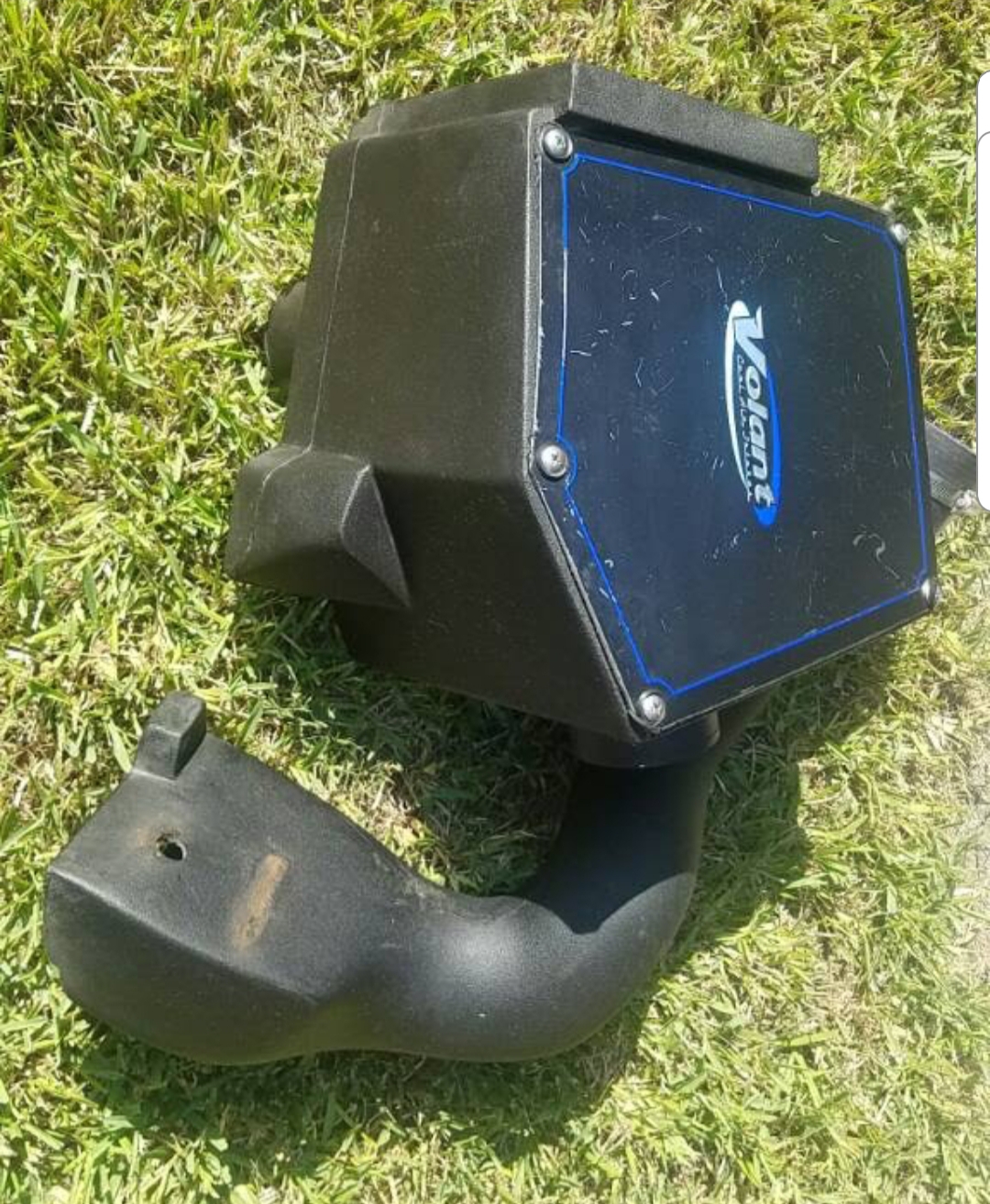

Ok, found most of the pics. I have over 6,000 pics lol!
This is the complete kit:

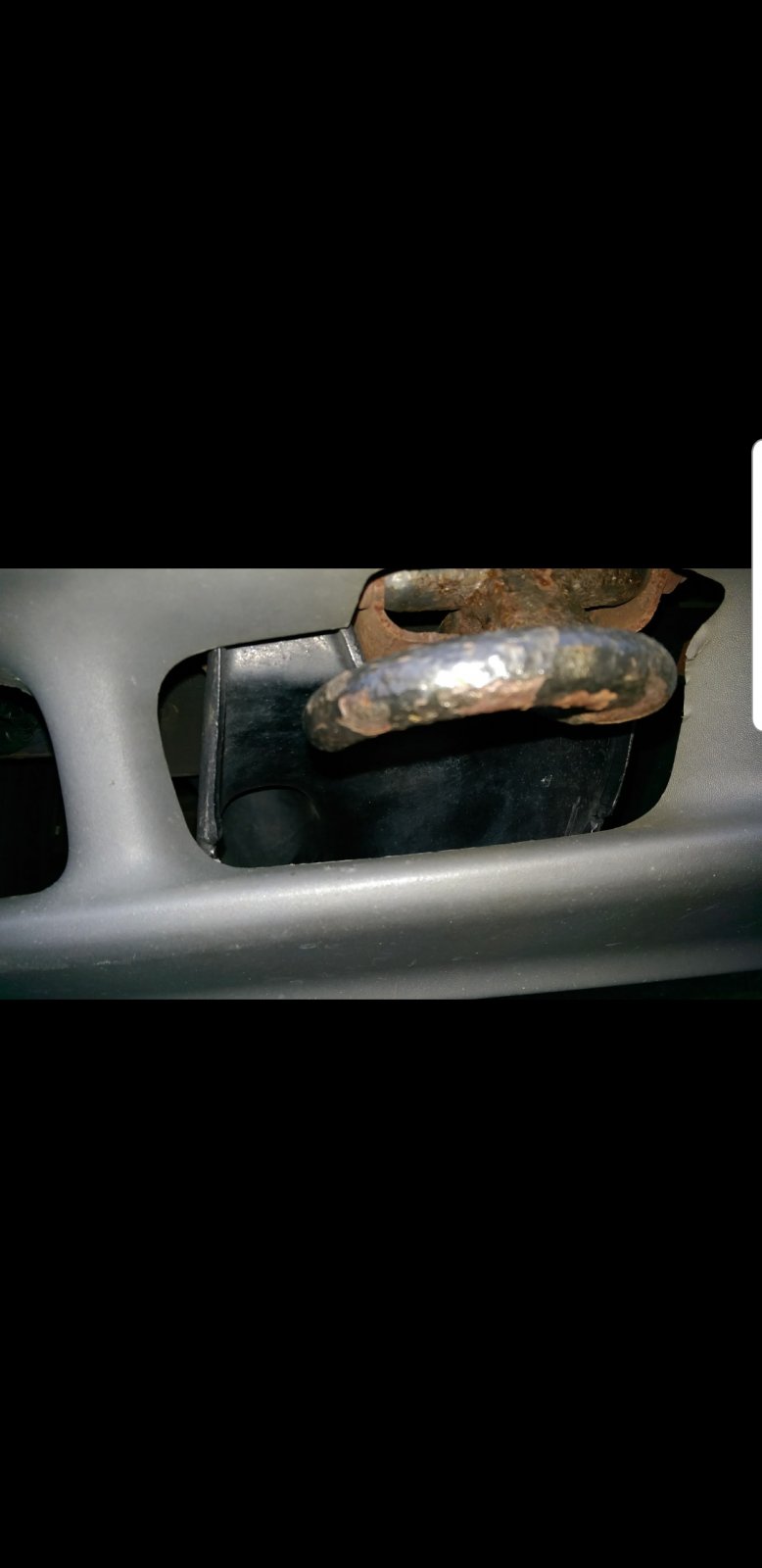

The square box is the snorkel piece that actually bolts behind a tow hook:

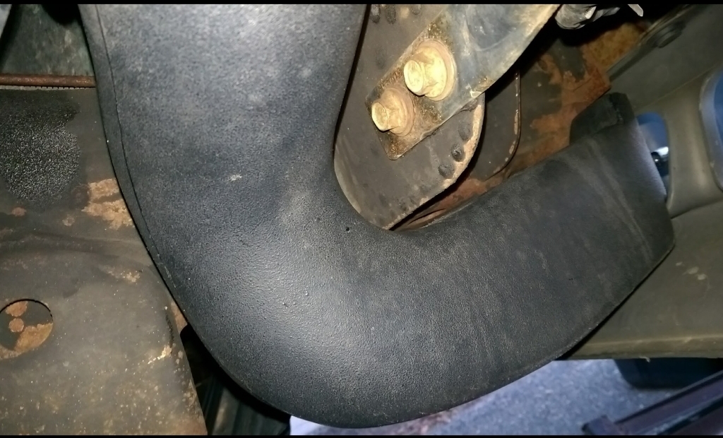

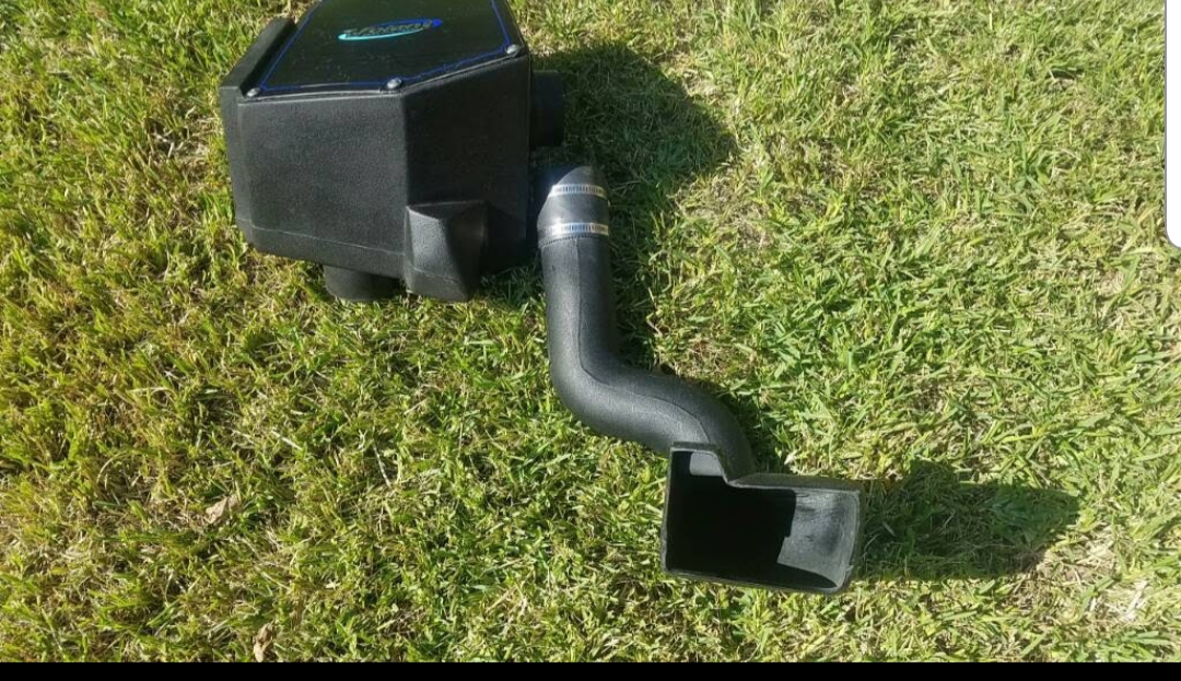

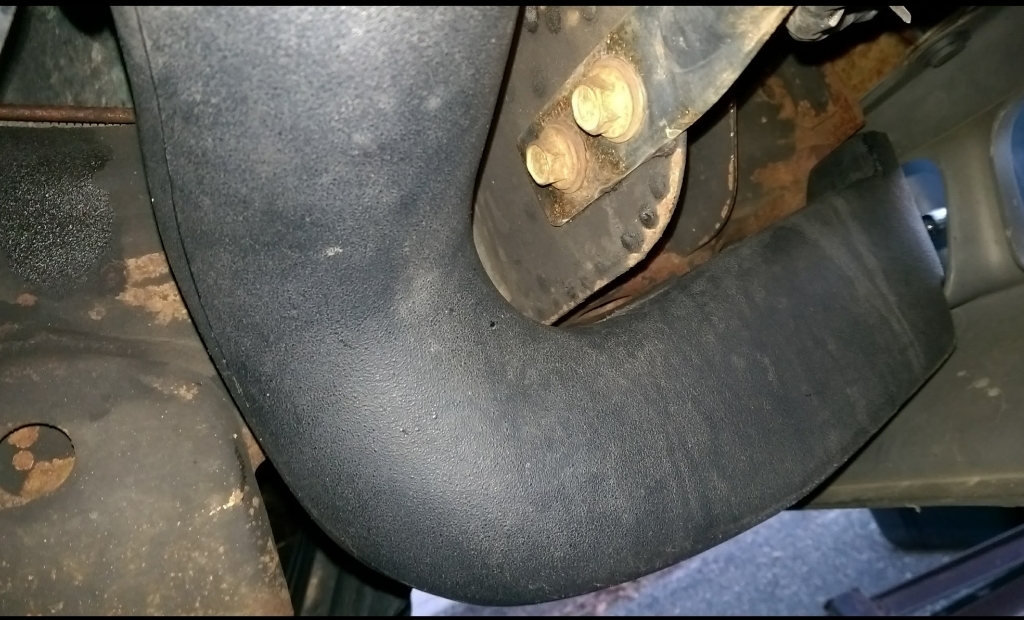

The hose/pipe that's inside the fender that feeds into the bottom of the air box:

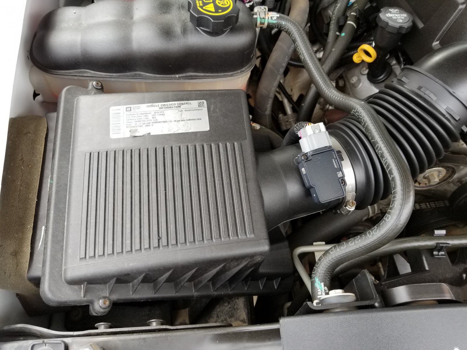

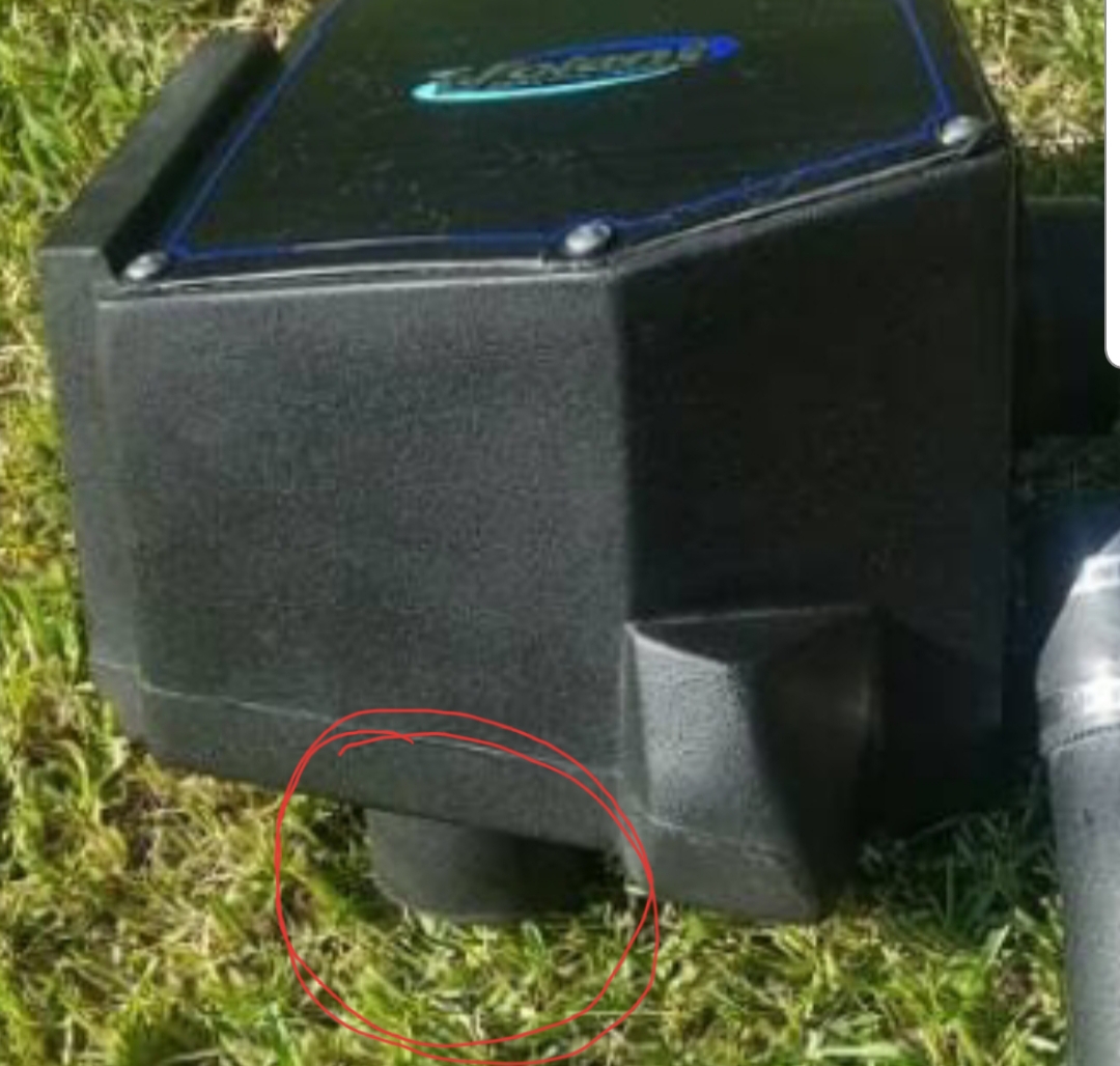

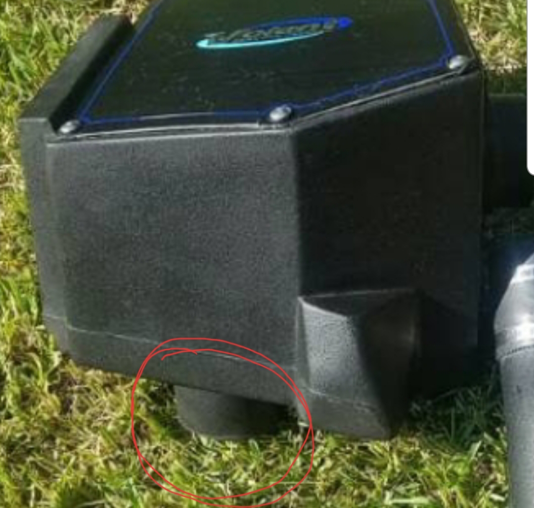

This is the inlet on the bottom of the air box that the hose connects into:
It's a very nice setup. I have a dry high flow air filter with some sort of high flow nylon type cover on it.

That's pretty neat, I chose the AFE because of the dyno results, if I get bored one day I might start digging around in there and see where that hole in the inner fender leads to. Maybe there's a way to get a similar ram air tube up in there, as long as it's above snow level for winter.

I'm also really close to ordering that damn hood but the extra hundred bucks for truck shipping is a hurdle I just can't seem to get over...lol
