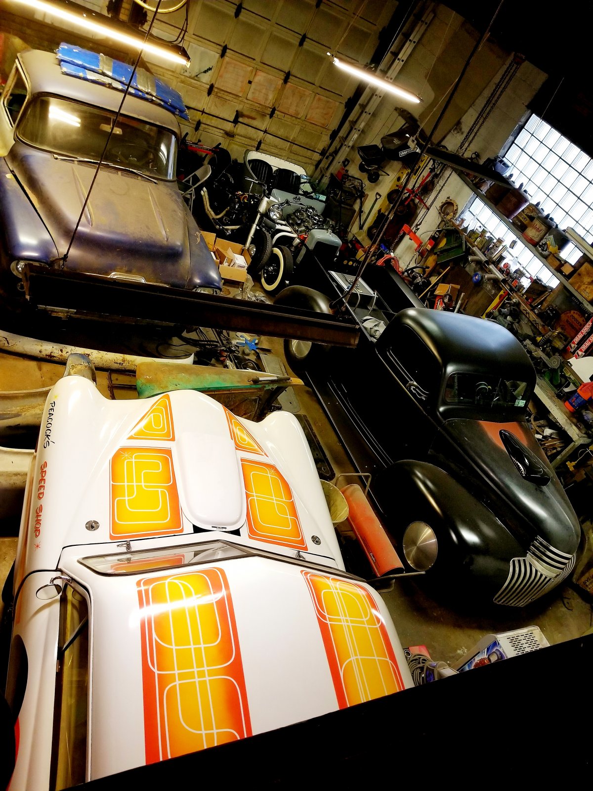

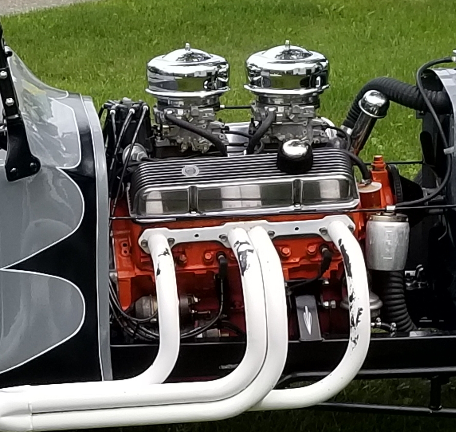

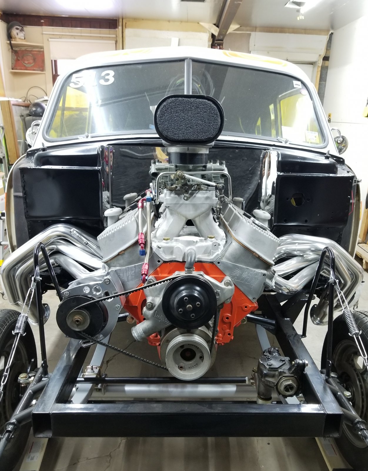

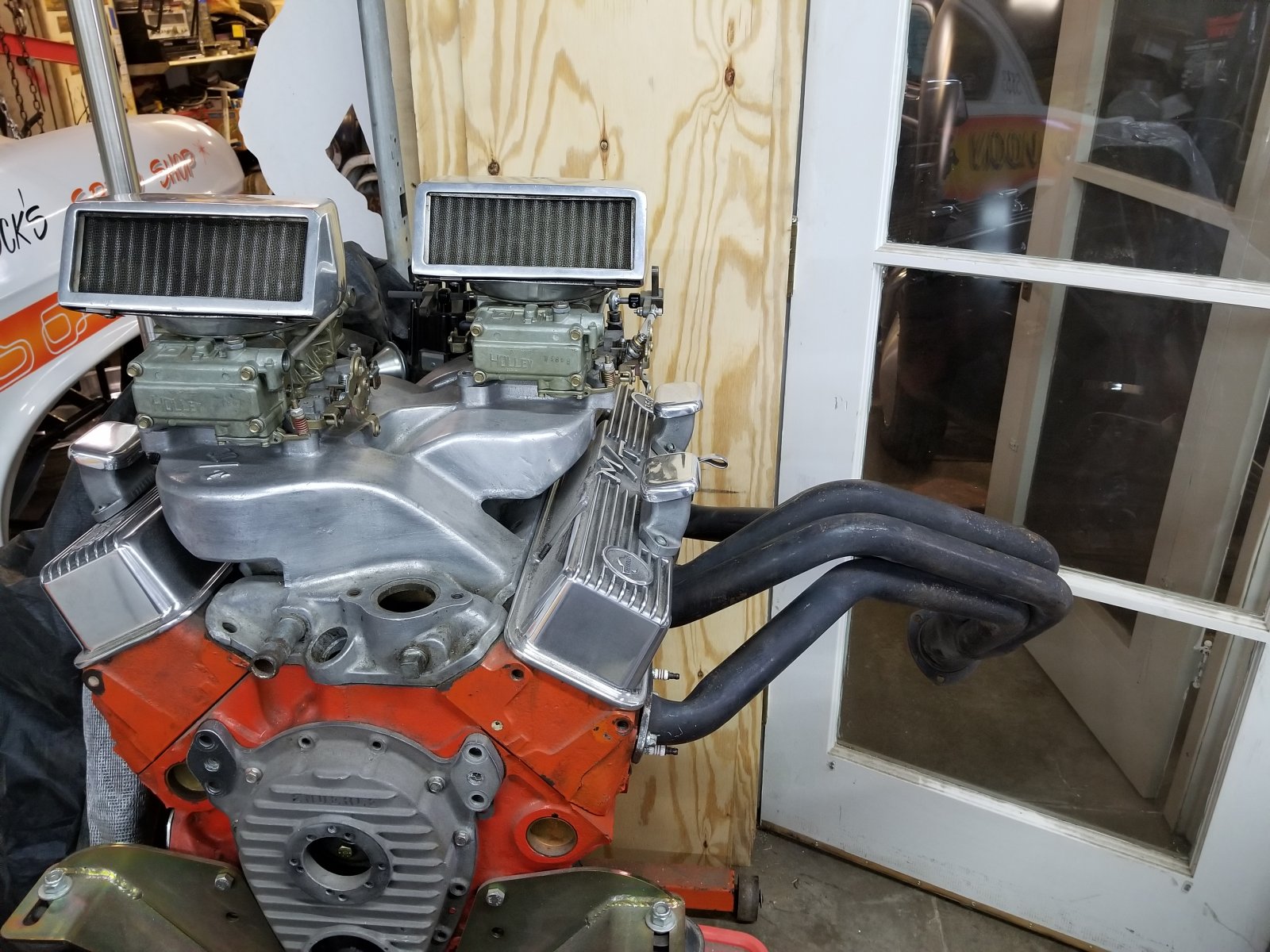

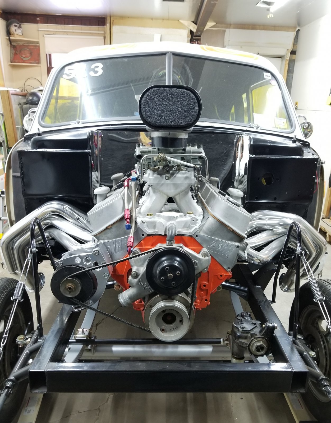

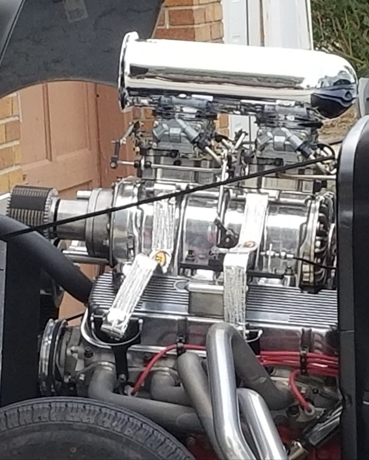

Not sure if off topic photos are allowed but here's a quick run down on the engines in those pictured
T-bucket , old school 355 solid flat tappet, double hump heads, this went 7.30's in a 66 nova, t-bucket weighs 1840 lbs which is about 1,000 less than the nova
41 Chevy p/u, big M based 540 that made just shy of 800 hp, currently getting a bigger blower, bigger carbs and bigger fuel system
51 Henry J, AFR head 489 stroker, full roller that made 600 hp and 600 tq with a pro comp intake and a worn out 850 single carb, should do a little better with the tunnel ram
What the engine will look like for the blue 57 Chevy p/u, still need a set of heads and a cam for the 11-1 355 short block I have for it
I also collect 60's vintage speed parts and wheels, one of the reasons I chose the Tahoe because it can haul stuff in the back...lol
Definitely time for an intervention ~ your'e hoarding horsepower. Beautiful machines Bro!
Shovelhead 80 ci that goes potato potato potato

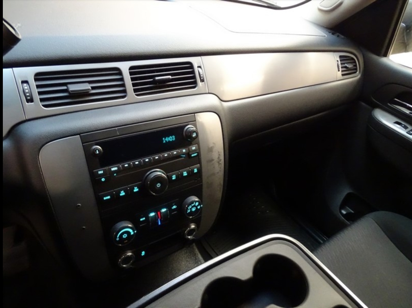

I see my name but I've missed the question... what's going on...? I see the horn wiring post so is this the issue...?
Peacock
Peacock
Feb 17, 2020
169
223
Buffalo,NY
Yes, what needs removed to access those wires that need put back together ?
I seen in another thread the guy said he got to them without removing the console, asked the same question there but no reply.
PPV12HOE
Sep 20, 2019
388
493
NC
Okay... so you have an inoperable horn I'm taking it... since you have a jump seat and not a full console it will be easier for you... you will need to remove the lower heater box cover from under the passenger side dash... from there you should be able to access the wiring shown in the picture... it's under the dash directly below the radio and heater controls... look for a light tan wire that has been cut in two... just connect them back together and you should have working horn...

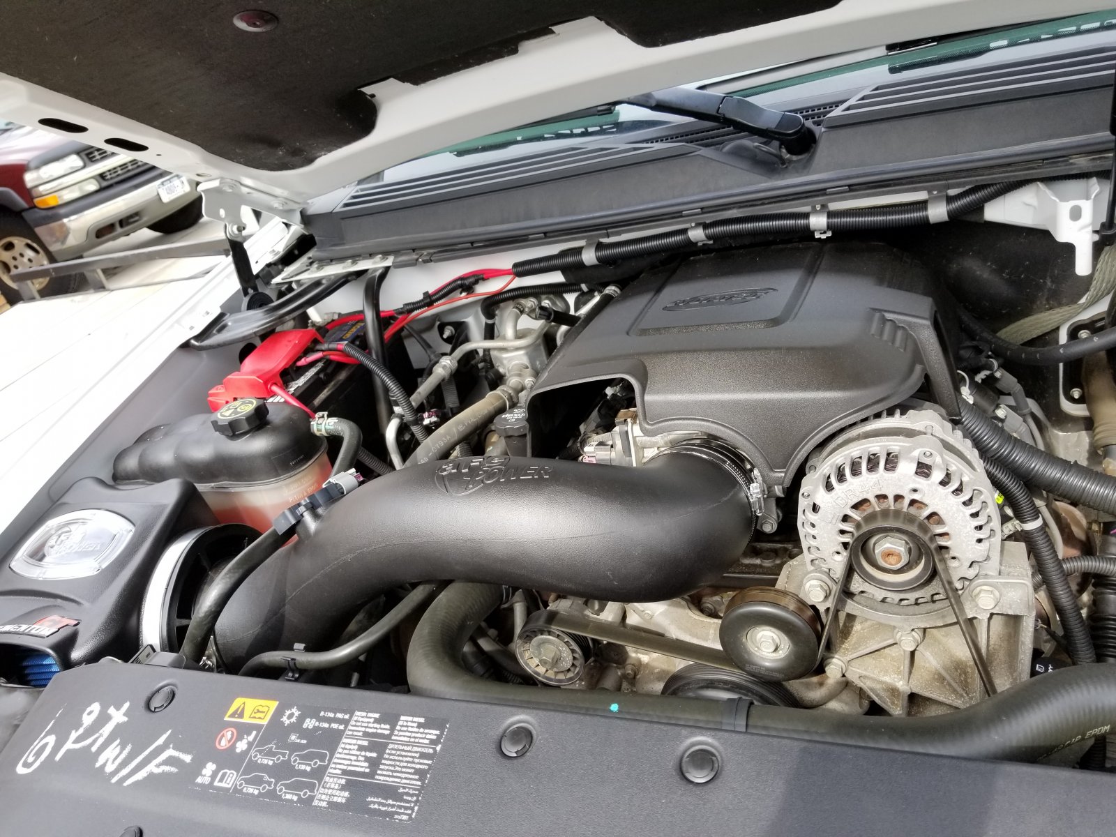

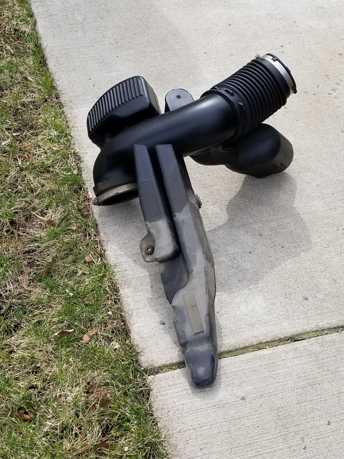

I didn't know there was a mod, so I didn't, but it goes vvooouuuummmm now, just like when I flipped the lid on my old cutlass as a kid...ha ha
View attachment 243334 View attachment 243335 View attachment 243336

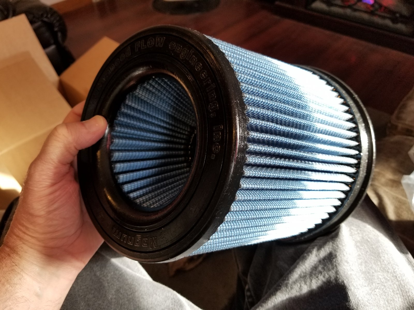

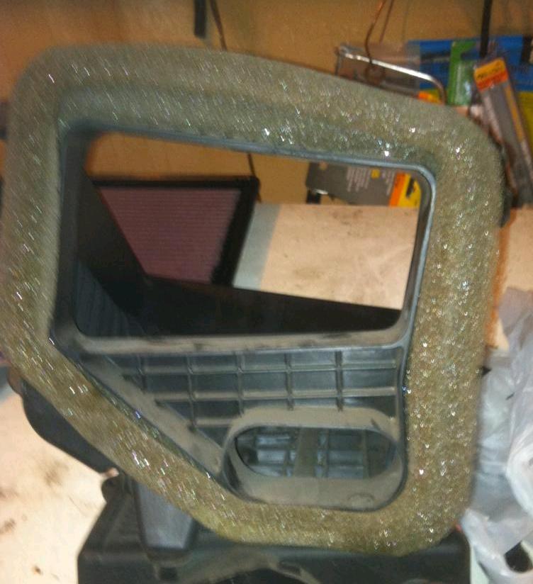

Is the front of that air box open???
I was referring to modding the fender and air box to make the hole bigger...
If the front of that new air box is open then I guess this wouldn't matter... seems like it would draw hot under hood air in though.
If it is open and you have a way to look at live data, like the Torque Pro app or something, you should check your intake air temperature data and see what it reads.
