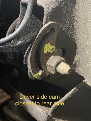

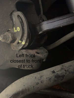

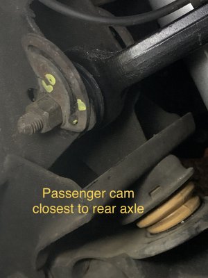

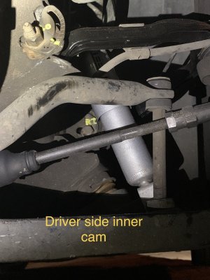

here are the cams. working from left to right. Outside being closest to the front of the truck, inside being closest to the rear axle.

That was going to be my next suggestion. Something like the belltech cams, and open the slots on the frame a little more.
View attachment 261678 View attachment 261679 View attachment 261680 View attachment 261681 View attachment 261682
Didn’t see the pictures before I replied. That’s a head scratcher for sure to be that far away from spec and maxed out. I’d say aftermarket cams is the best solution for the time being.
