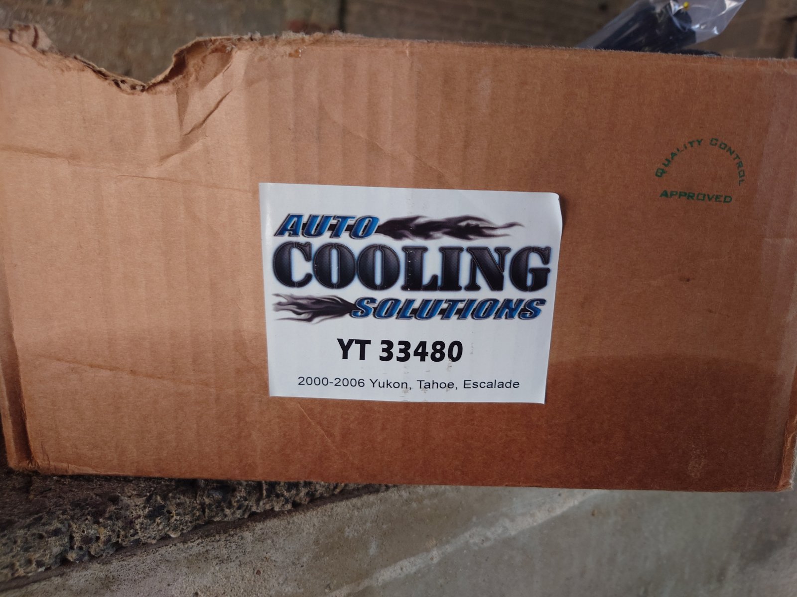

If someone look for a repair set. That was was I installed.
