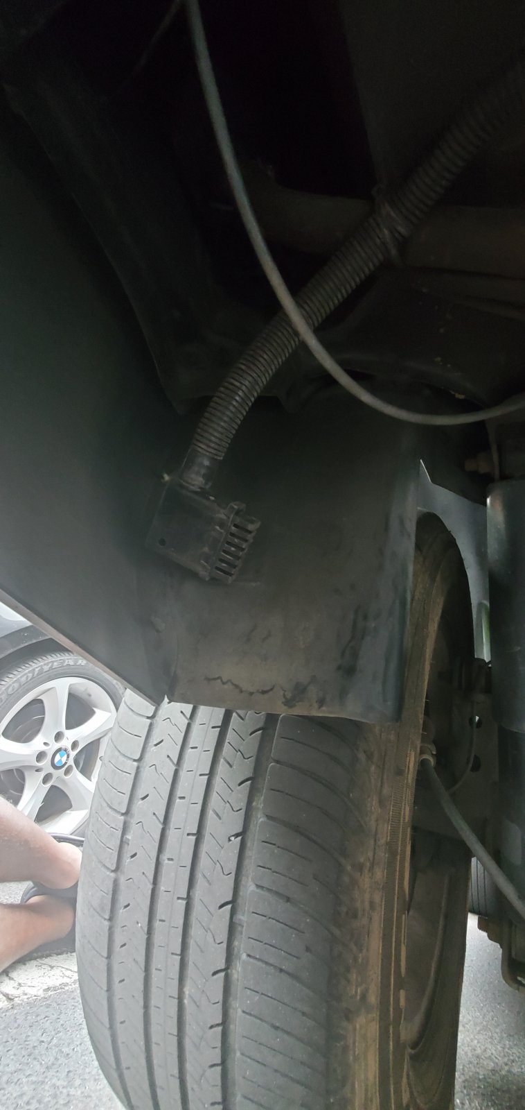

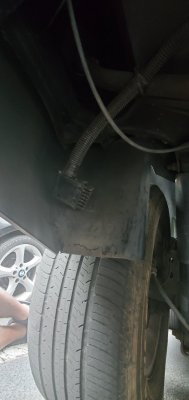

Hello new here, I was under my 07 tahoe today removing my spare tire and discovered this. Can anyone tell me what this is and do I need to put it somewhere? Thanks

@gooffeyguy was correct, it should be secured near the top of the filler tube, as in this video:
I had to replace mine last year. I secured that hose up the top of the filler neck with zip ties and it eventually slipped down. I didn't make them that tight because that flexible hose tubing is thin walled and crushes easily. I wound up running a zip tie around one of the vent fins and through a spot on the filler neck mount under the fuel door area and it's been good to go.
