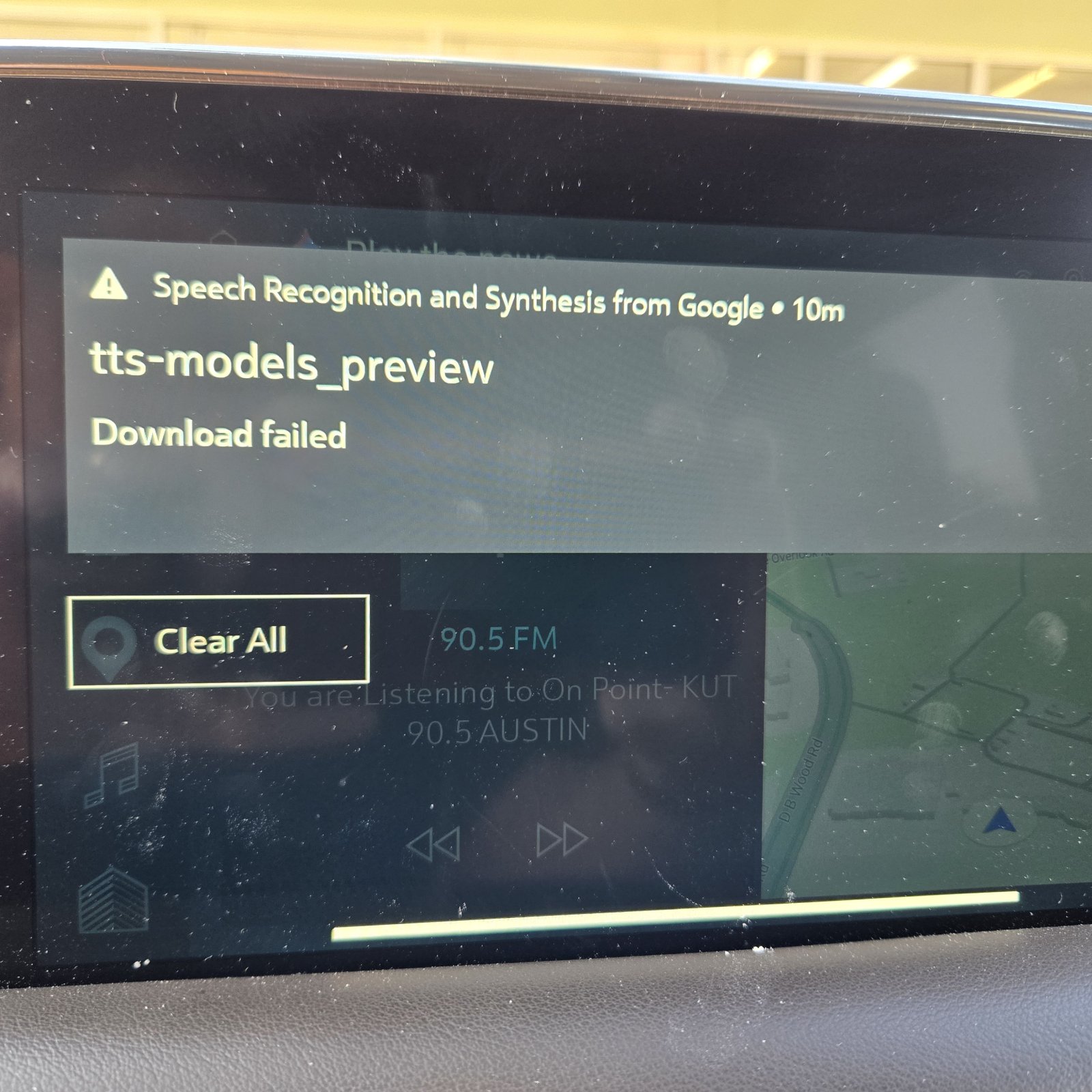

This screen keeps popping up - is it important?

Every week I seems to be getting this screen on my 22 Tahoe. I can't tell if it's important enough tp go to a dealer and go through service hell.
Any advice here?

Ignore it imo. Its failing to download something from google. If its really bothering you, sit near your router, as close as you can so the truck gets a signal from your home wifi and let it complete the download. Your probably pulling away before it has a chance to finish the download.

The vehicle has active WIFI that updates maps all the time so. I am ignoring it since there is nothing I can do about it now. Just posted the question in hopes somebody else had seen this.

I just did a deep dive on Google. Apparently the app on my Galaxy 95+ phone is the problem. I have removed the updates for the App on the ohone and may that will fix it.
