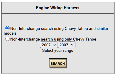

Look on www.car-part.com for pre-owned harnesses, if you're so inclined. They might be more intact. Or not.
It just keeps kicking back a "non-interchange search result", which looks like an error, but I can't be sure because it's about as clear as mud. Doesn't seem to like 2007 or 2008 search criteria.

Here's some search criteria that I used with mucho results (obviously use your ZIP):
Either one of these two selections returned many listings:

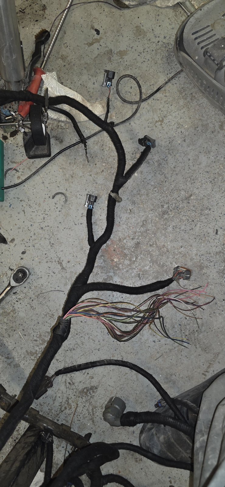

The "new" harness has the 18 wires that go to the MAF, AC limit switches, and through to the firewall just cut off. "Great", I think, "I can just slap an 8-pin and a 12-pin Deutsch on there and connect new to old", i tell myself...
Ha effing ha.
Among the 18 wires, although the same 18 colors exist on both sides, each side has FOUR pink wires, 3 tan-ish wires, 2 purple, and 2 black/white wires, all identical shades and gauges.
I have no clue which of the same color wires should go to each other, and the schematics in the Haynes manual are useless without knowing what every circuit is. Can't find anything online either .
Anyone have any expertise or advise to climb THIS hurdle?

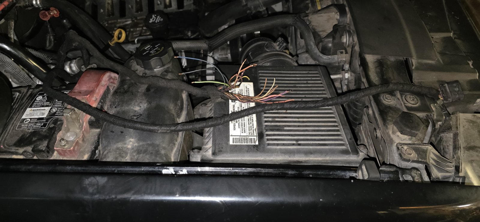

I'm in the "home stretch" of this bite i shouldn't have tried to chew. These 18 wires are the last WTF I got ahead of me (unless I eff something else up before the finish line).
Anyone have a feel for how risky it might be to wire nut the unknowns together and fire it up to see if anything's wonky?

Here's the branch coming off the harness, branching off just before the passenger side ignition and injector section:

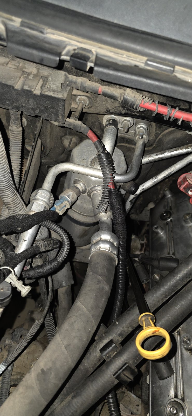

And here's the vehicle side. The MAF pigtail branches out of this bundle, as does the AC limit switch and another 3-pin connector that looks like whatever it goes to is wrapped around the negative battery cable, the rest of it goes through the firewall:

Those two ends were not connected. The harness shown on the ground is the "new" harness I got from a salvage yard on Friday. They told me it just had the 2 rear O2 sensors cut off of it, but made no mention of these 18. Unfortunately, in my arrogance and lack of forethought, I cut the original harness off of that bundle and subsequently trimmed and stripped the vehicle side wires, so I can't match the cuts up on the original either.
As far as the branch running along the firewall, with the O2 sensors and such on it, that's the branch before the one in question (moving from the ECU toward the passenger side). That one is now fully intact after splicing on my original harness' O2 connectors.
On the vehicle side bundle, I can identify 10 of the 18 easily enough: the 5 for the MAF, the 3 running to whatever is around the negative cable, and the 2 running to the AC low limit switch. The other 8 run down in a single loom along the AC suction line and look like they go through the firewall with the suction line, but I guess it's possible they don't and I just can't see where they route from there. But yeah, have no clue what those 8 go to.
And on the harness side, even with the 10 I can identify on the vehicle side, I have no clue which pins on the ECO connectors correspond to them.
