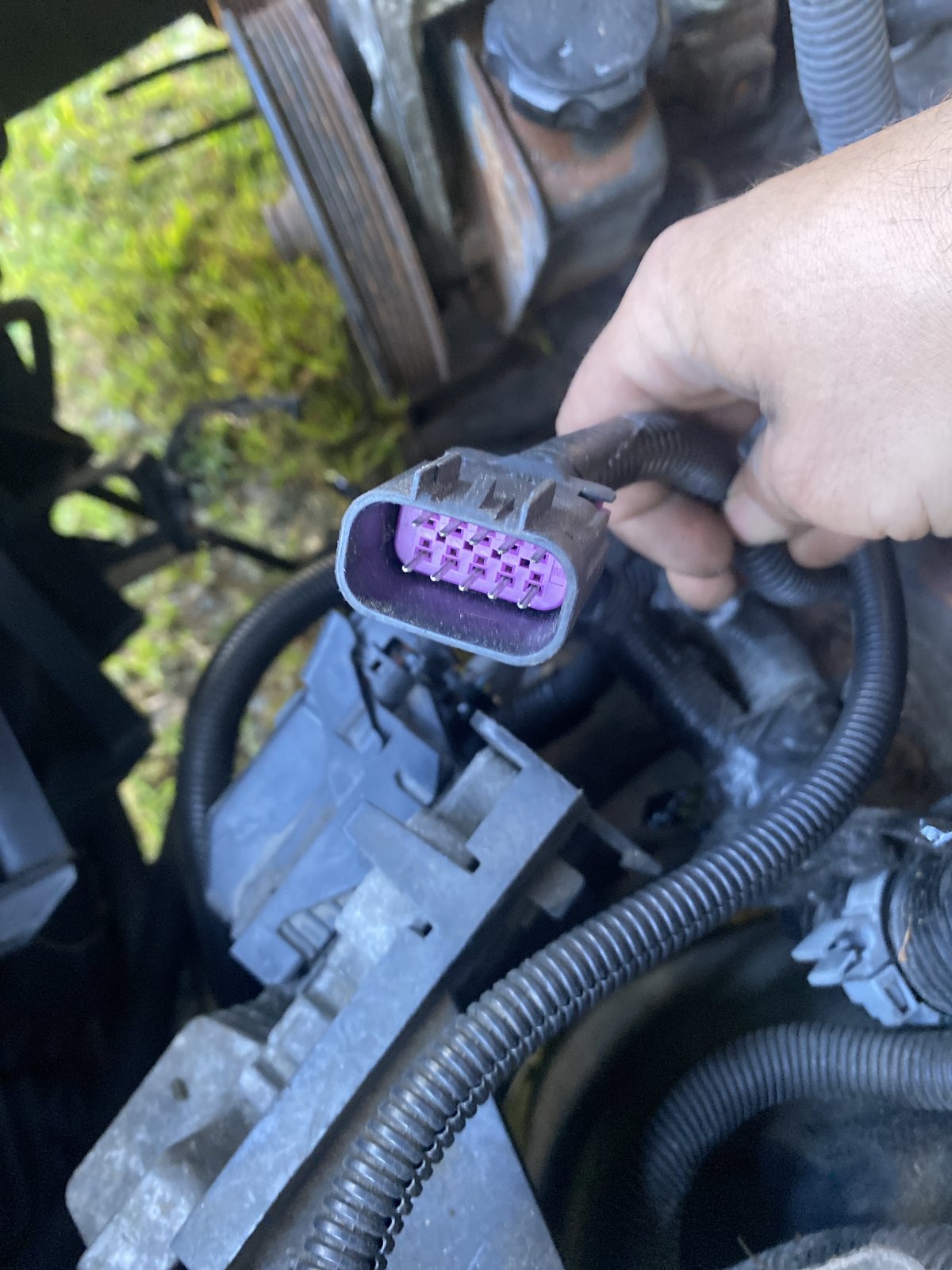

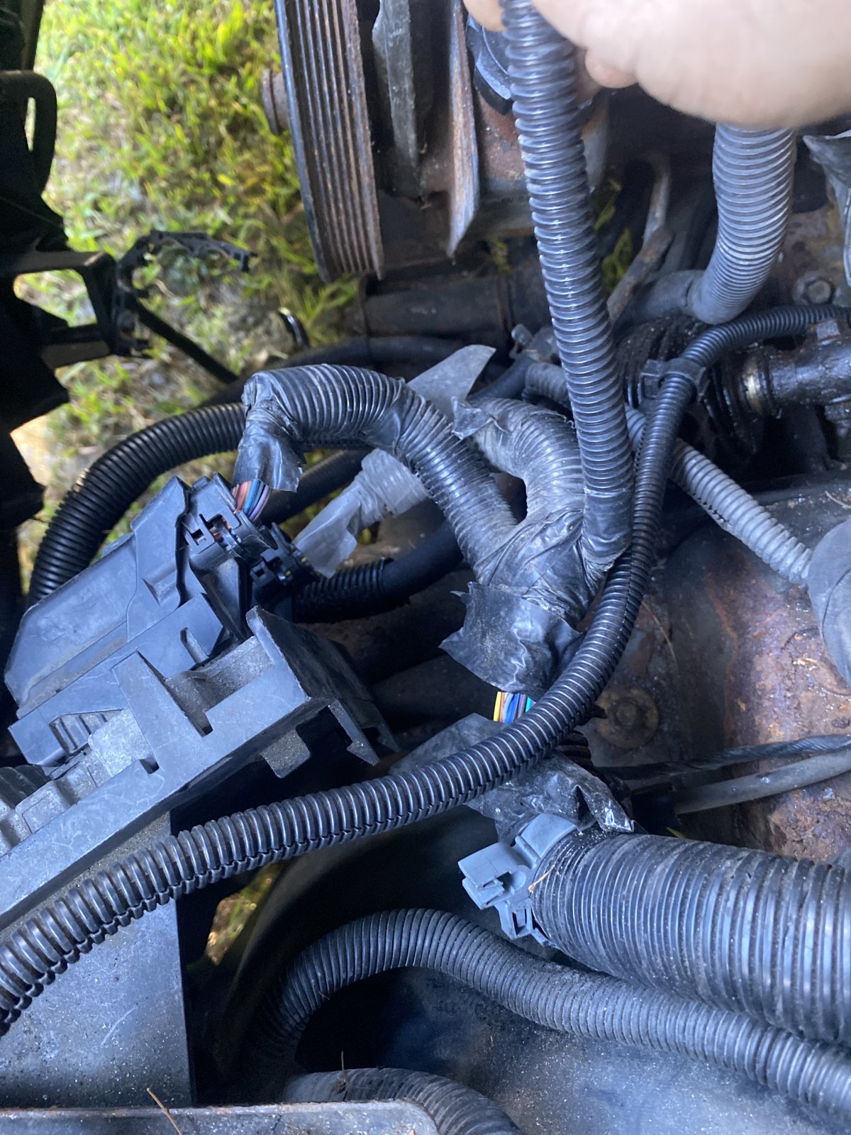

my wife’s engine in her Tahoe let go I bought a crashed 2011 not knowing they had different sensors and transmission. I removed the engine transmission and transfer case from the 2011 I have it in my 2007 but I have a 10 prong plug next to computer I don’t know what it goes to I checked the 2011 looks like it goes into the body wiring harness just looking for some info if I’m gonna have to swap steering columns or what else I have to do to get this thing going kids have school Monday and need to get this thing going appreciate any help thank you

So I have spark and compression I just think I’m missing a ground I have weak crank even with batt charger

Need to figure out what that plug is for then figure out what you're missing that it plugs into.
I don't believe swapping a 2011 drive train into a 2007 is an easy swap.
As far as i know 07/08 and maybe 09 are a direct swap but newer is not.
The engine reluctor is different i think requiring some creative problem solving and the trans internal valve body is different.
As far as i know, you can't just stick it in and have it work. More electronics will need swapped and tuned if possible at all.
Maybe im worng?

Yes I swapped everything except rearend. I’m changing steering column now because I couldn’t get it to crank with the 2011 computer so I’m thinking if I change the column the 2011 computer will work I have the whole other truck I just don’t wanna change things if I don’t have to. I got the truck cheap but I wish I just bought the right motor. I appreciate your help

The computer is probably not matched to the VIN, so no crank. Wrong VIN and wrong year.
I'm pretty sure you're trying to do a swap that is not going to work without a lot of work and figuring things out.
The basic engine is more or less the same. Sensors might be different. The 07 ECM would need tuned for the 2011 engine.
The TCM is different, the trans valve body is different.
I believe you can swap the trans valve bodies and use the 07 trans wire harness and it would work in your 07. I do not think the 2011 TCM will work in a 07.
But i could be totally wrong because i have never researched it and just repeating what i think i remember reading.
Hope someone that knows for sure will answer as i would like the right info also!

The 2011 has VVT, the 2007 does not, so the earlier computer is not going to be looking for a VVT signal while the later one will with their current programming. Besides, the computers have to be VIN matched to the vehicle.
Not sure why you would have to swap columns.
I cannot say with certainty what that plug is for, it escapes my mind.

Ok, I just popped the hood of my 2013 Sierra and the purple connector was secured to the strut mount and one end went under the brake booster and the other went under the underhood fuse block.
