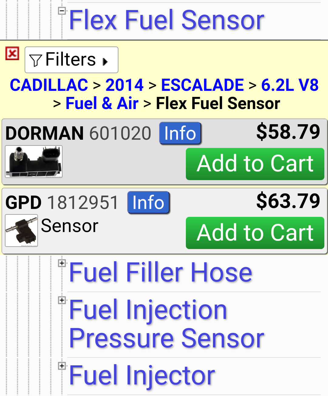

I've got one of these in the fuel line under the driver seat along the frame rail....
first I've heard of this Gen having a physical sensor. wonder if it's a caddy thing or 2014 thing.
either way that's really nice. i might have to look into wiring diagrams and see what pin the data line runs to.
