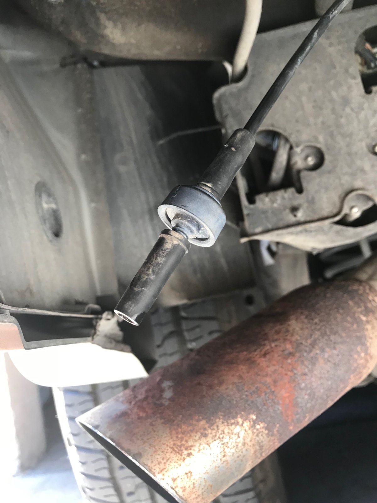

was getting my 01 denali smog checked today and noticed this thing hanging off next to the left exhaust pipe. (i have custom dual exhaust)
does anyone know what this is and where (if anywhere) it should be plugged in to?

Up here to the right
Flux capacitor..... careful.. it puts out 1.21 jigawatts.....
Looks like air line for self leveling suspension which may have been deleted...
30,549
48,004
where is it going? more pictures, looks like the air pump is still present, and I would look up, it obviously goes somewhere up above where it is hanging. my nbs didn't have air ride so maybe look for a hole in something, lol

i tried taking it to 88mph and shoving some garbage in the gas tank... but sadly i am still here and now my truck smells like ass :(
I do have air shocks so might be something related to that.. but they still seem to work fine. didnt see any holes i can plug with this.. seems to be attached to some wire cluster but i didnt get a chance to get a good look. will check this weekend

that's weird did it have a lift on the back or something like that for the disabled>?
45,012
Looks like an air or water line with an in-line check valve. Does your rear washer work? Hit the switch and see if your truck pisses from underneath.

ding ding ding.. i think we have a winner. i recently noticed that my rear washer was no longer working.. so this has to be it. where does it plug in?

HellifIknow. Depends on where that plastic hard line is coming from. If it traces to the body or frame, look for a plastic line or nipple closer to the door frame. If that line traces back to the door frame, look towards the body or frame. I'd pick up on that line and move it around the general area to have a gauge of what vicinity to be searching in. I'd go look under mine but it's a GMT900 and I'm still in bed. At least it's not an EVAP system hose!

not sure anyone cares.. but found the connector is under the electrical plug in the left back corner of the rear hatch
