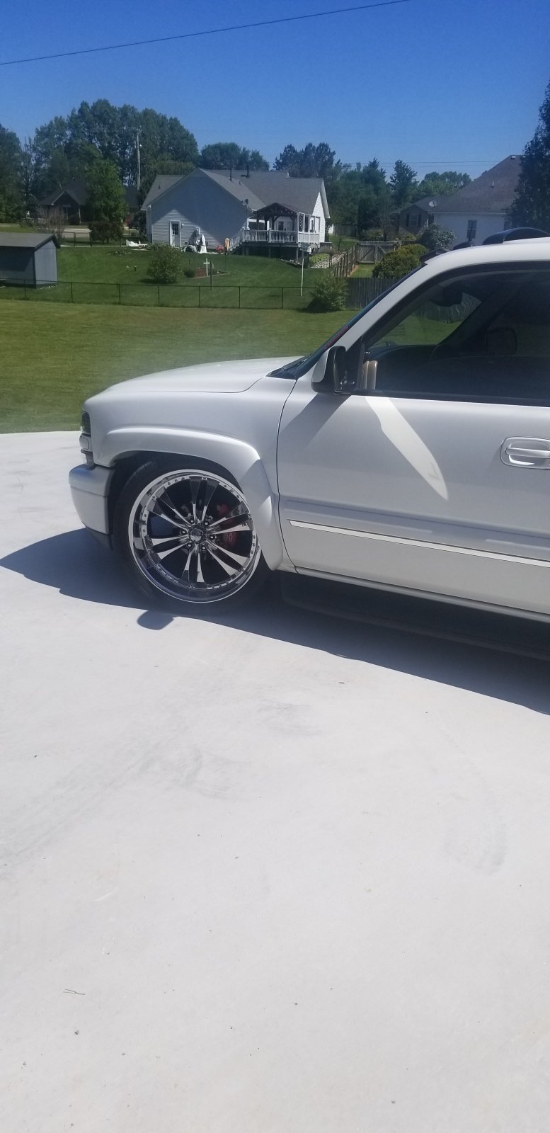

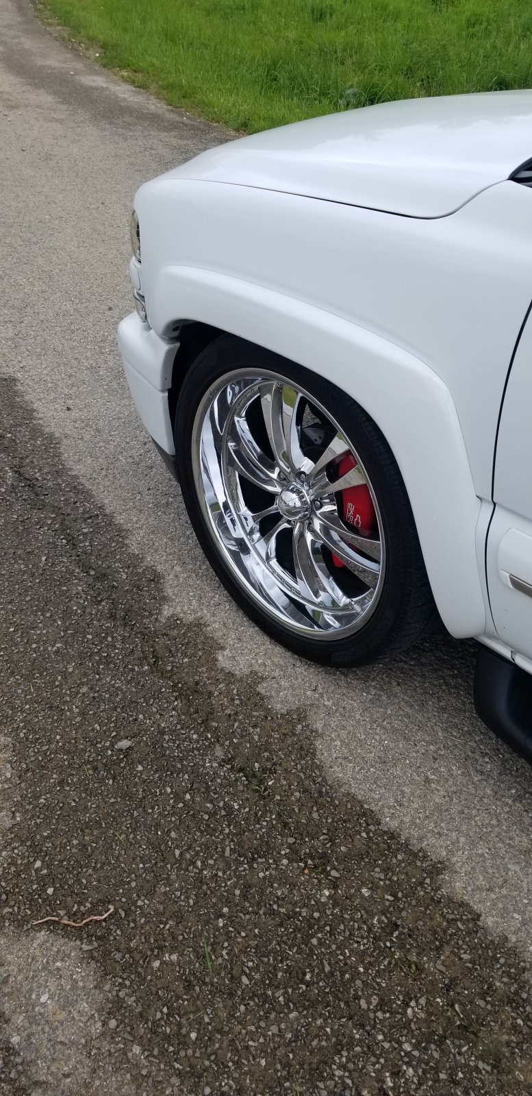

Got the 3/4 ton keys in yesterday. had to crank them up a little. I had my stock ones all the de cranked before. I was tucking way to much so turned them up a little

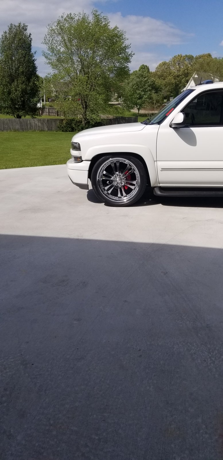

Let's see a side shot with those keys. What did that do to the measurements? Does it still rub now?
Byoung1330
Aug 26, 2018
446
296
Cookeville tn
I'm at 32 in the front an 33 in the rear. Yes it rubs but I love the way it looks lower like this. I will take a better pic today. It's in garage now an not good side shot

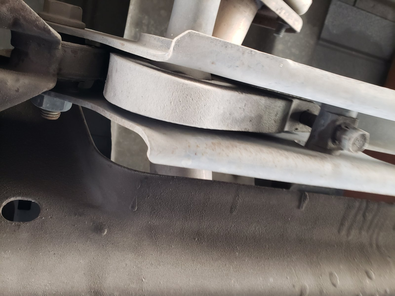

Are these the stock keys?
If so, can stock keys be adjusted for an additional 1"? Do these look adjusted?

Those dont look stock. And those keys are cranked all the way up. If you back that bolt out an let the key almost rest on the keeper that the bolt goes in it will lower the front quite a bit. Like I said its all the way raised up right now making the front of your ride high. an if they were stock they would be a rust color.

Nevermind it looks like someone painted the whole cross member an keys so they may be stock. but they are still all the way up. Bolt tightened up lifts and backed out lowers

So what you're saying is...I can still use these keys for an additional drop. The previous owner stated he originally had the Tahoe lower, but had to raise it back up to align it properly.

Yes u can lower it more with those. As I said they are all the way up. go back them bolts almost all the way out to where key almost rest on keeper an u will see what I mean. Do it an drive forward an back a couple times an look. But I would reccomend a alignment after. I had mine all the way backed out with spindles an it aligned perfectly. haven't got it aligned with the purple keys yet. Hoping it still aligns good
