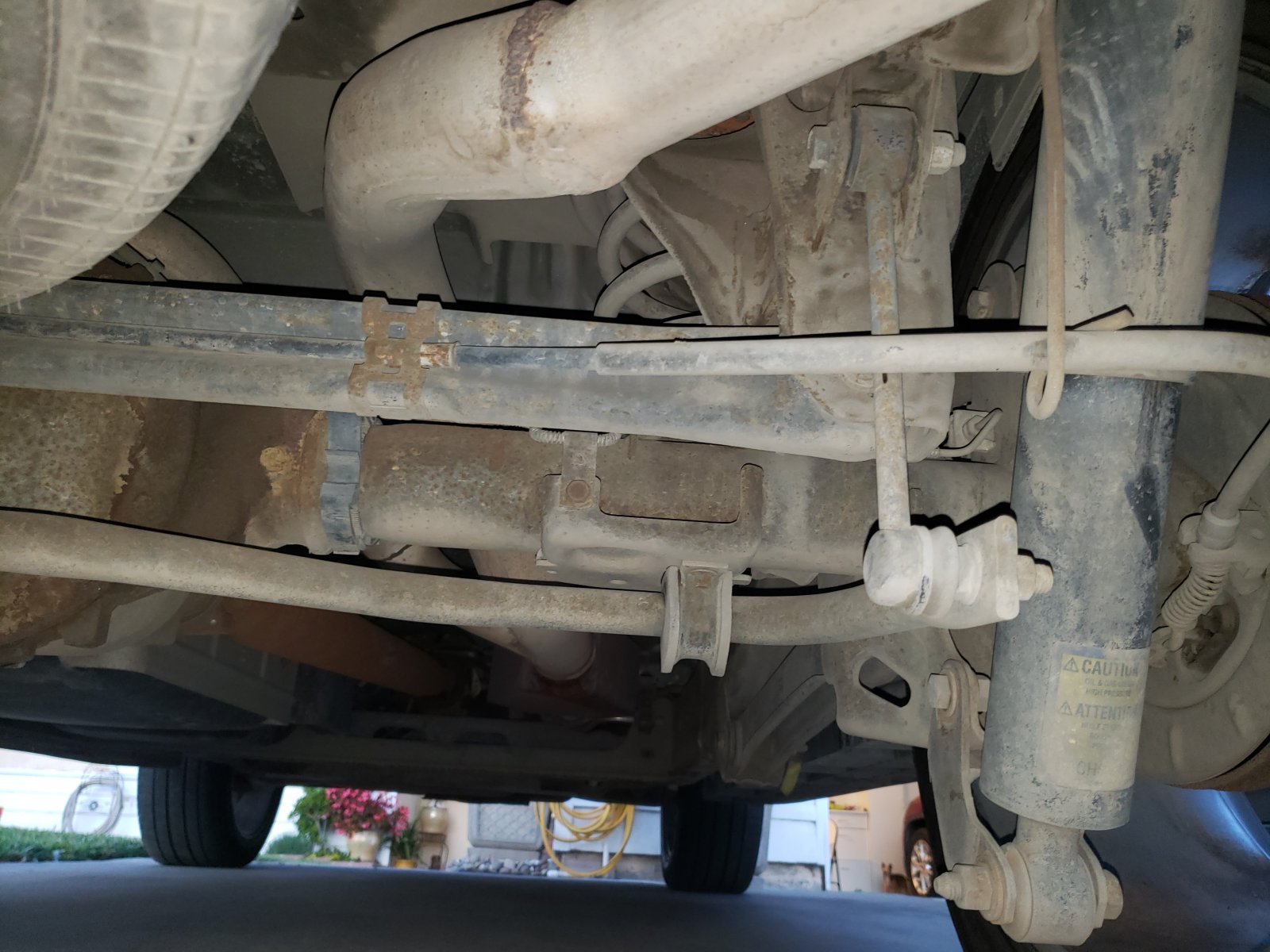

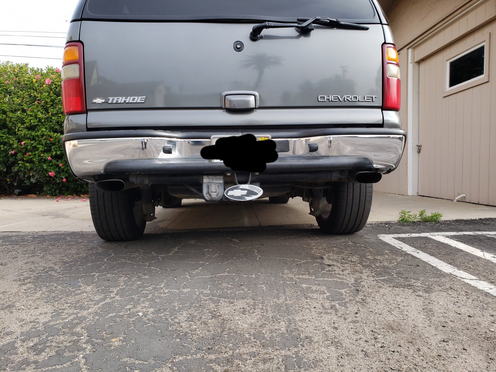

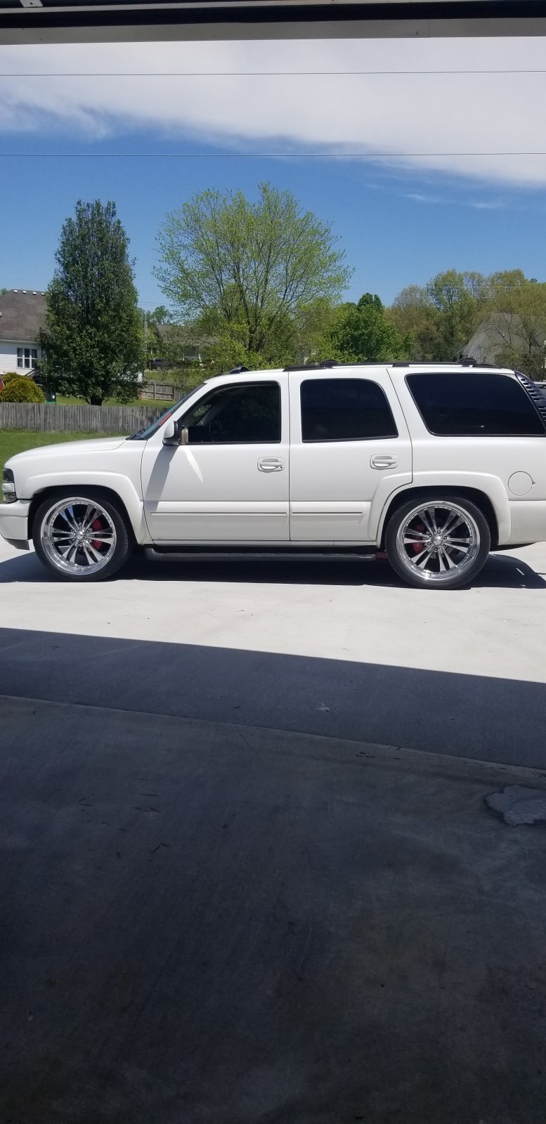

I recently bought this Tahoe. The previous owner claims it was dropped 4 inches in the rear, and unknown drop using keys up front.
I really want it about 1-2 inches lower, but I'm afraid a 2/3 drop will be a waste of money because it'll actually be higher if indeed it was dropped ad much as the original owner claims. Any ideas? 20200428_195533.jpg
2002 Tahoe LS 4.8 w/ 63k miles
OEM Escalade 22's w/ 285/45/22
Unknown suspension mods
I have only changed the wheels and painted the Cadillac 3rd light and vent caps.
Mechanically, I've only changed the oil. Tire shop inspection showed everything was ok, but it makes clanking noises in the back, and it rides like crap.

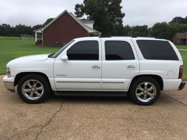

Welcome. Just curious---what are your measurements front and rear? Starting from the lower center edge of the wheelwell(above your tire)to the ground? Should be a level flat surface.

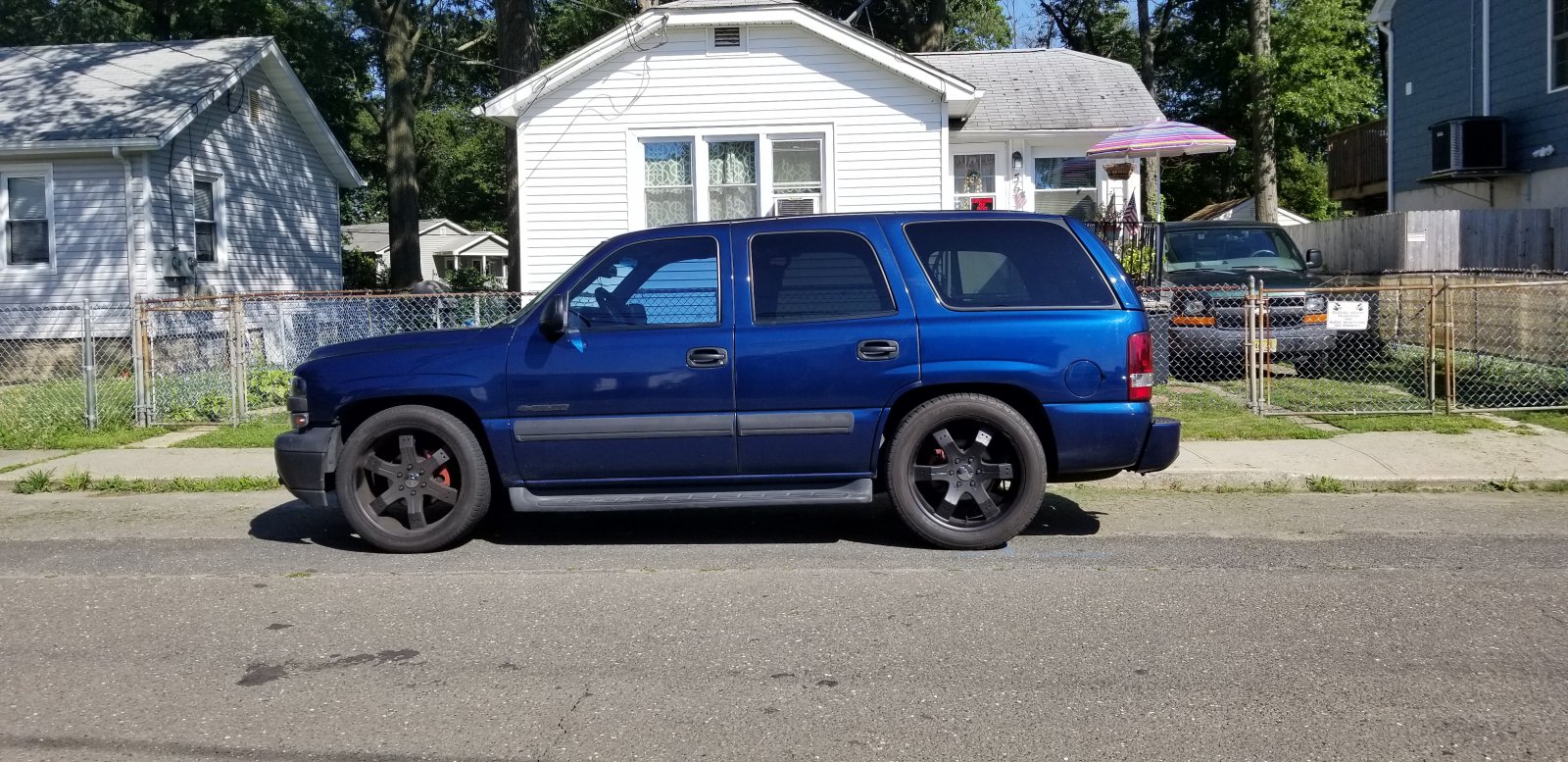

I dropped mine 3/4. It's an 03 Tahoe 4wd. With 22's the front measures 33 1/8" and the rear is 33 1/4".
I used a kit from crownsuspension.com. I got the kit with the front lowering keys, rear lowering springs and rear shock extenders.
This is the kit I bought---https://www.crownsuspension.com/lowering/3/4-lowering-kit-4-coils-2-3-torsion-keys-with-shock-extenders/
You look a little higher then me, especially in the front. You probably can adjust the front keys to lower another 1/2"--1".

Tony, I think your neighborhood needs more chain link fence. If that is your home in the background, what is that Chevy in the driveway?

Gotta keep out all the strays! It's my work van--05 Chevy Express 2500 with the 4.8. The one that was giving me all the headaches with the oil pressure.

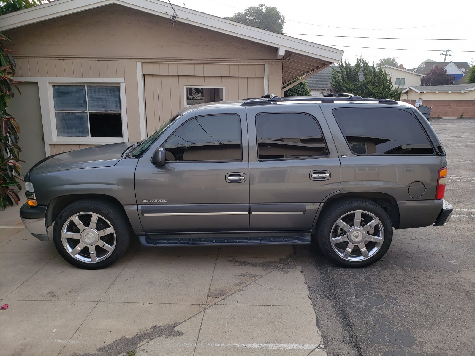

I measured 35" front and 36" in the rear. Is it even dropped?

It doesn't look dropped to me just shock extenders for whatever reason.
Tire height makes a bit of a difference.
It does appear to be lowered a little bit in the rear. Not much in the front. On the autoride trucks the airbags in the shocks provide a bit of the ride height. If you have shock extenders and altered the rod for the autoride sensor you can get a little bit of drop.

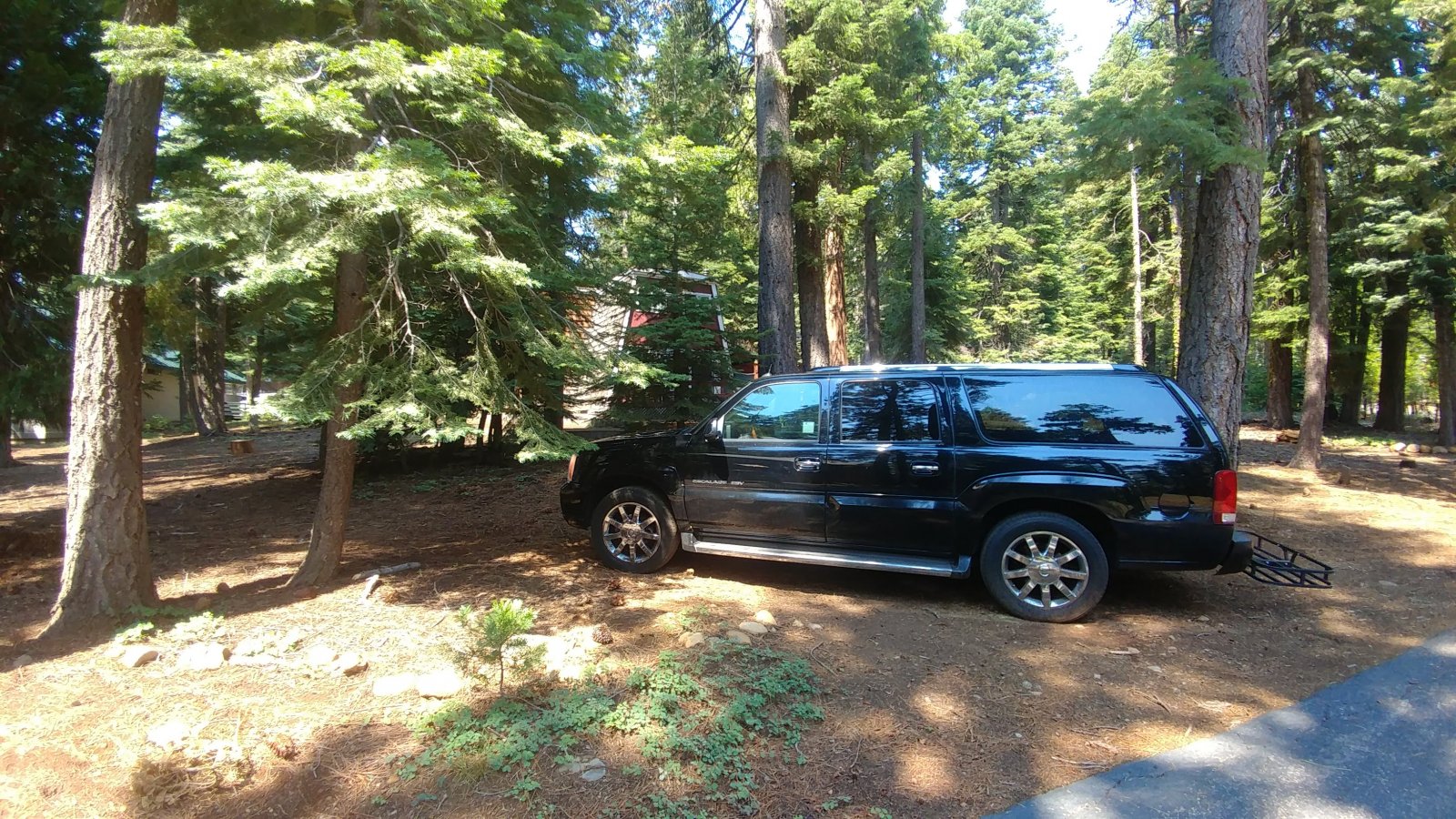

It actually looks very similar to my stock Escalade platinum, which sits lower than the non platinum and has less rake. More like a 1/2 drop.

Yes, I think it was leveled in the back about 2". No way to be sure. Probably springs. 1 inch drop up front looks plausible.
I don't have autoride. I appreciate the feedback.

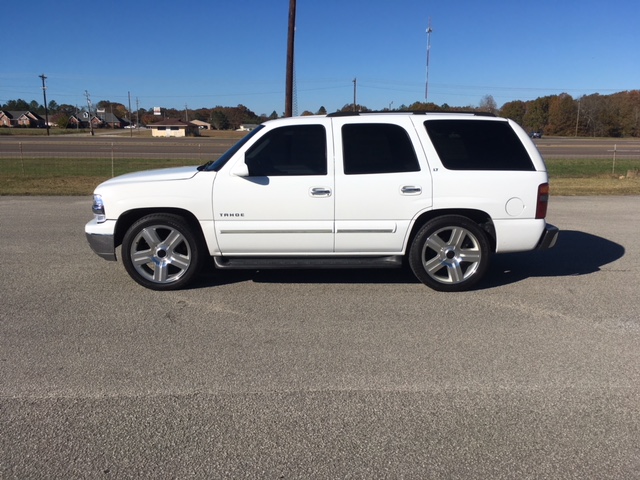

And here is mine. 3/4. Maybe more. I sit at 33 in front an 33 1/4 in the rear. On 24s. 305 35 I have 2 inch mcgaughys spindles and 4230 trailblazer coils with helper bags. Bilstein 4600 shocks.
Frame surgery spohn panhard djm rear kit. I just got some 3/4 ton purple keys in the mail an trying to install tomorrow.
