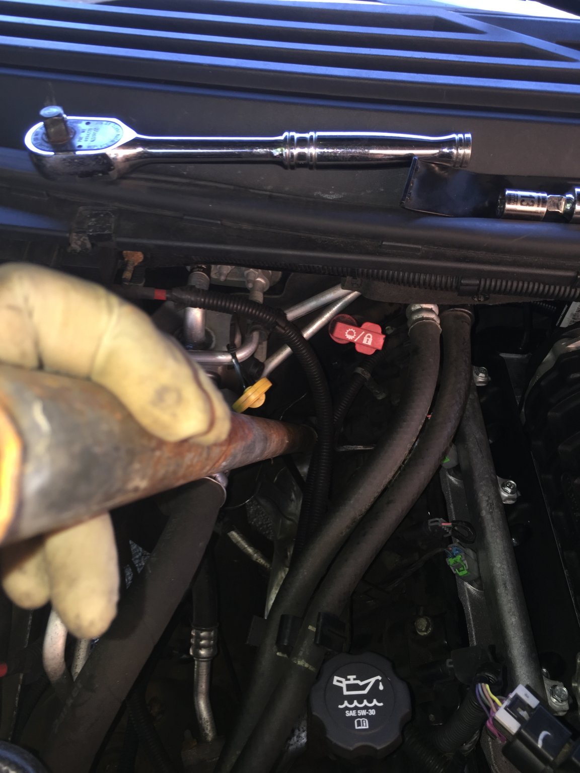

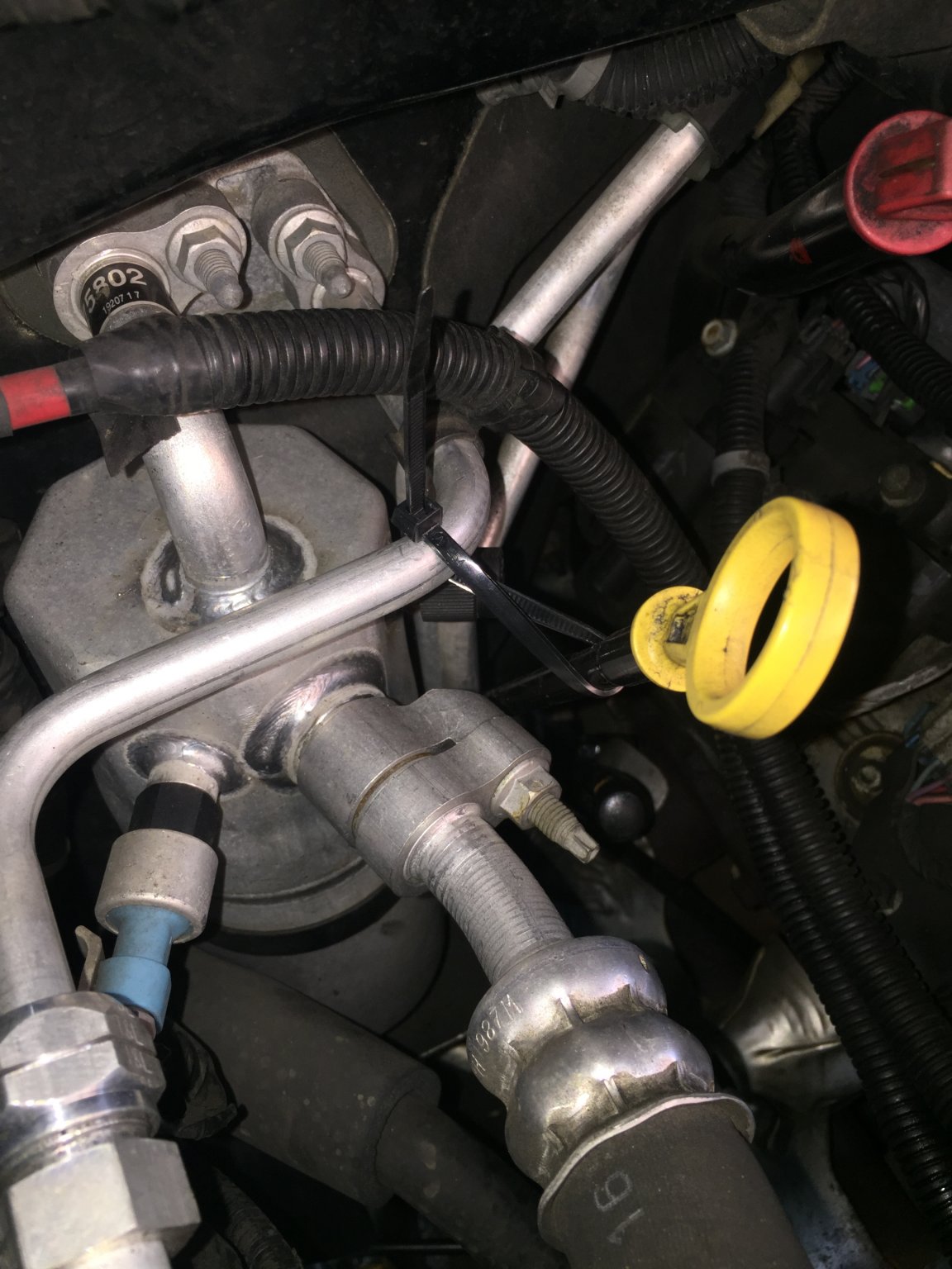

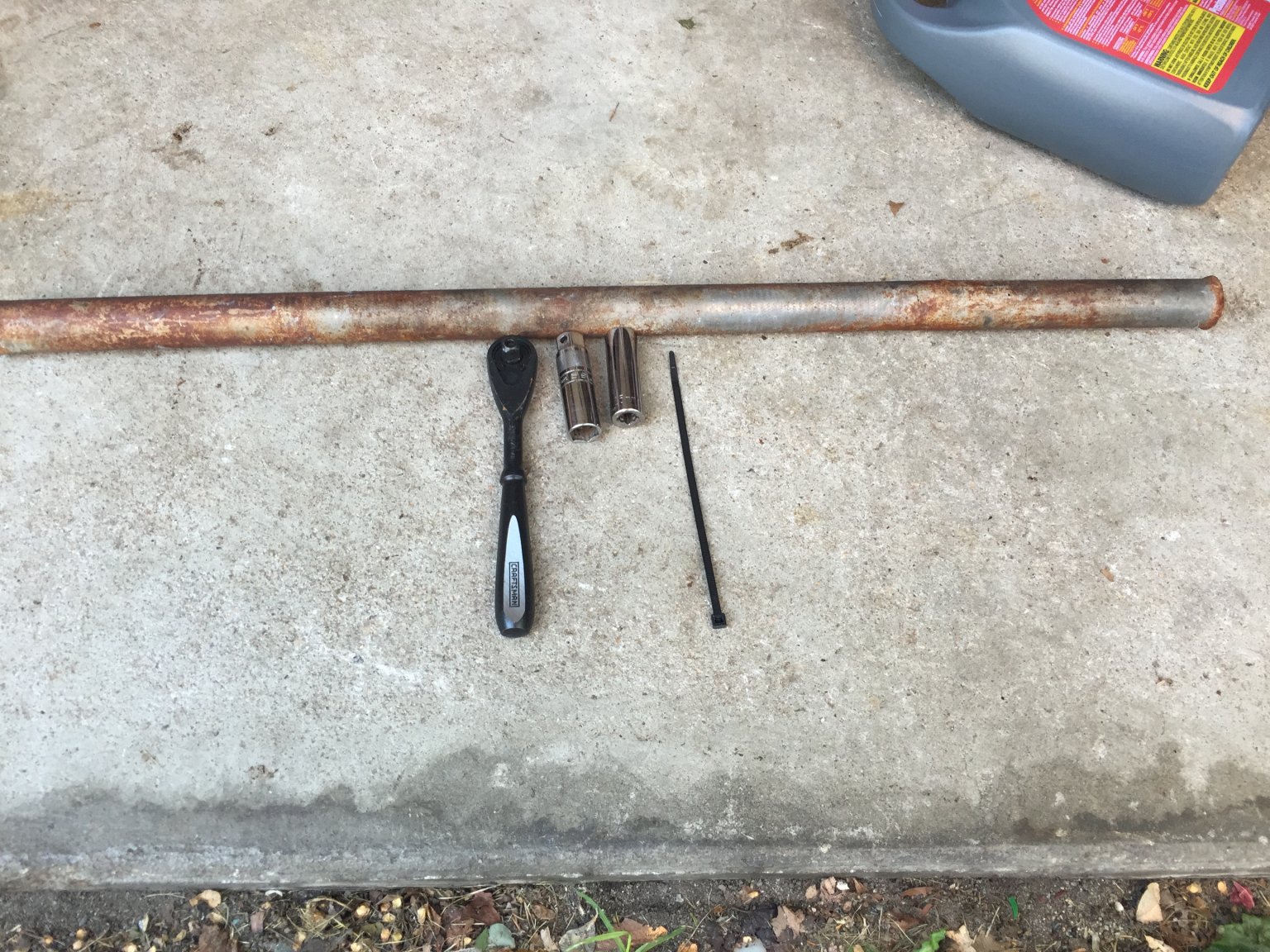

i was able to get to plug 8 easily with a 3/8 ratchet, 5/8 plug socket and cheater bar. No swivels needed. It's easier to remove the bracket for the trans dip. I Pb blasted the bolt holding it (15 mm). Once removed. I zipped tied the tube out of the way. Now I was able to fit a ratchet and plug socket perfectly with plenty of space to swing a cheater bar. Also recommend using Pb blasting the plug. Last thing you'd want to do is. Trying to heilicoil repair in that spot. Hope that helps
