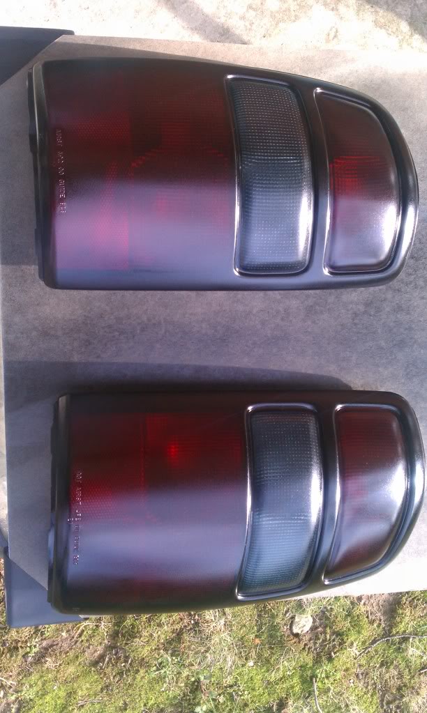

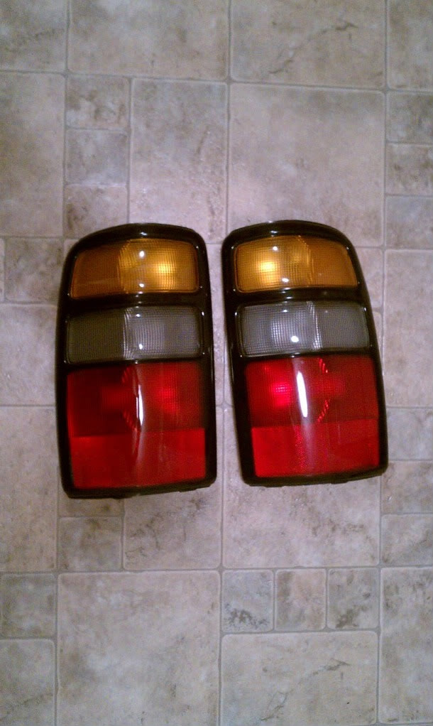

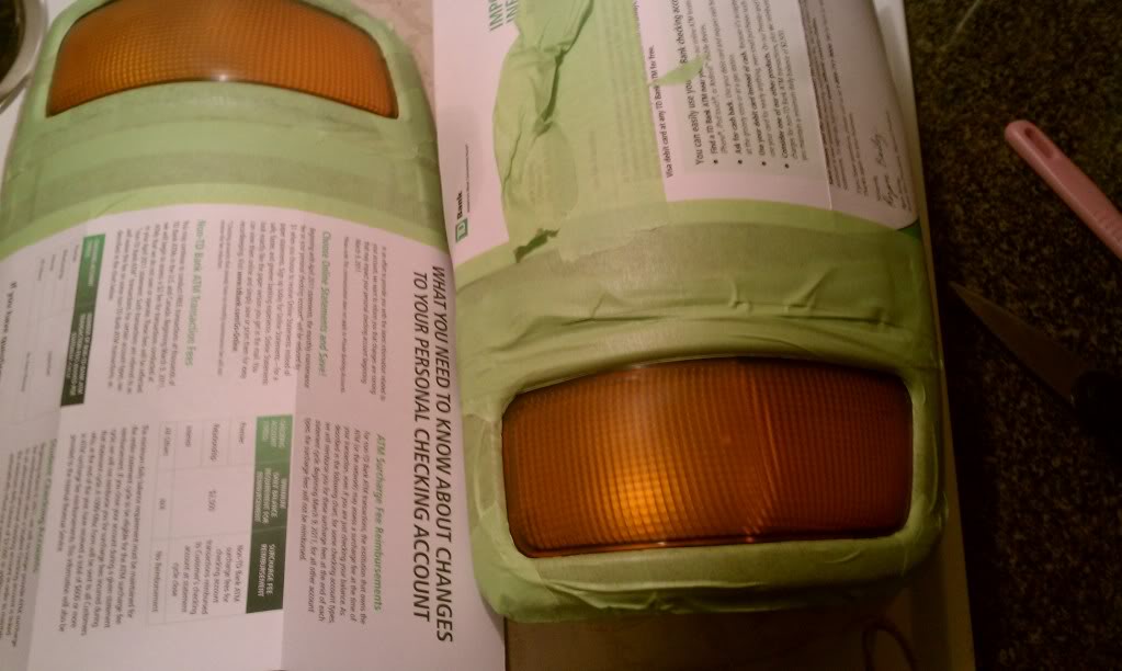

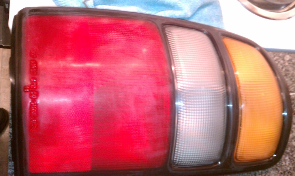

heres what ive been doin for the past couple days. i guess this can be used as a diy, if there isnt already one. first i bought a set of 04-06 black trimmed tail lights.
wet sanded them with soapy water n 1000 grit paper.

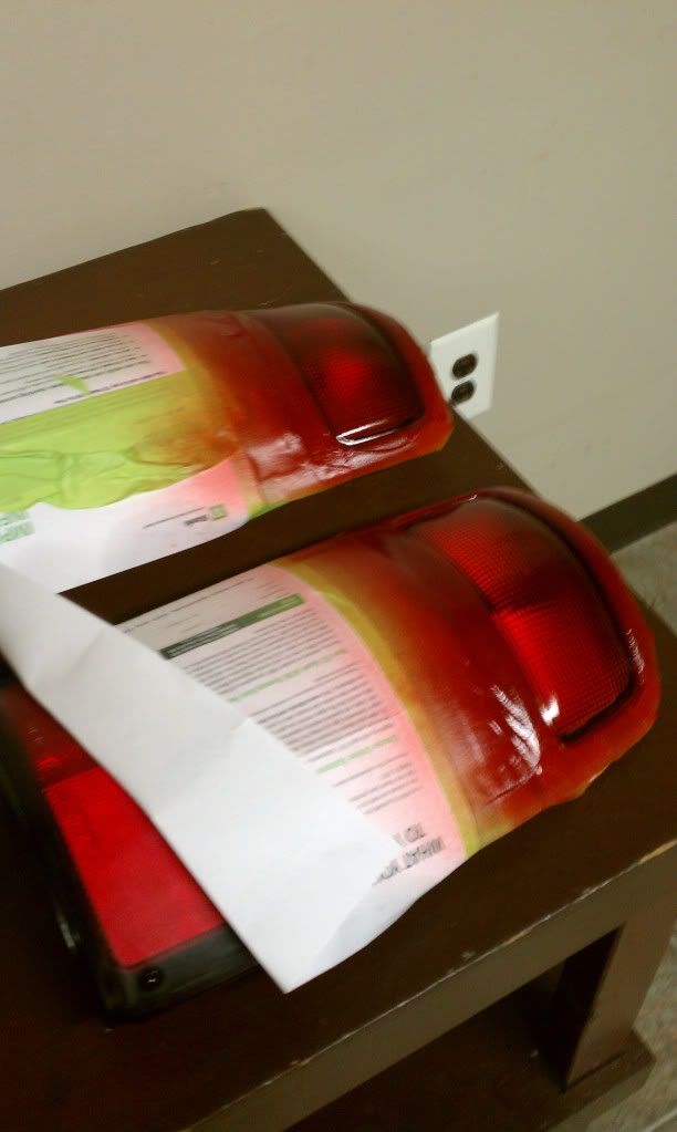

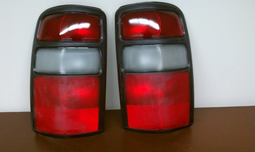

tape off the trim to spray the orange turn signal red.

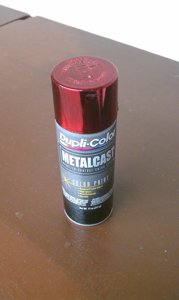

for this i used duplicolor metalcast. basically a transparent red paint.
after about 3-4 light coats it was a pretty close match
carefully pull off the tape and let them dry over night.

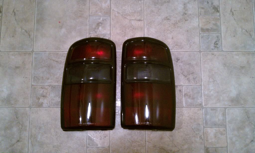

then wetsand with soapy water n 1500 grit paper now theyre ready for vht night shades
after 3 light coats...
let dry for at least an hour then use your favorite clear coat. light coat first then meaduim coats 3-4
wait until clear coat is good n dry(12-24 hours) then wetsand again with soapy water n 2000 grit paper. lastly rub on ur favorite polish. i just used meguairs scratch-x by hand it worked just fine
thanks for looking

yea u gotta do light coats and 10-15 between coats. and let it set prolly for a couple hours the wetsand before clear. you should be good
