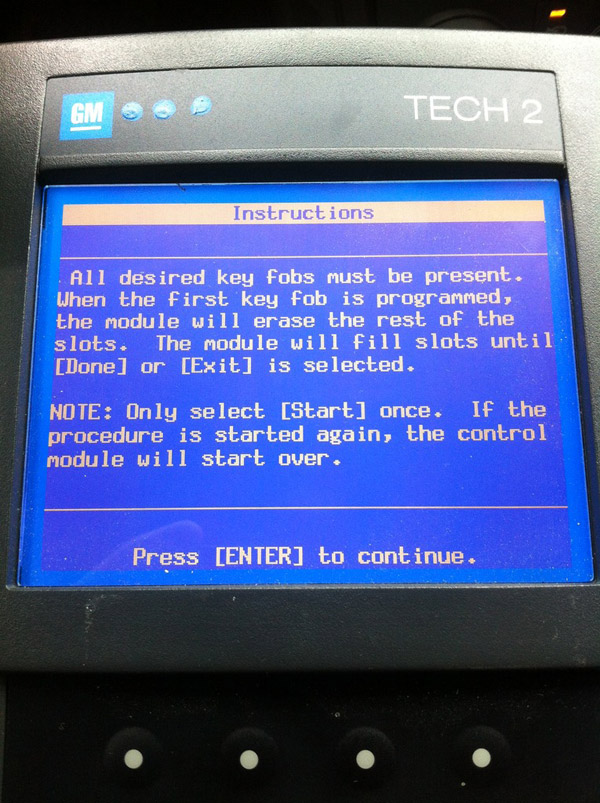

Ok. It was when I was poking around Tech 2 instructions...
What I saw and mis-remembered @Fless was:
"All desired Fobs must be present", because programming the first fob wipes out all the other fobs programmed in the rest of the slots.
So, if you want to keep using your first fob... Make sure you have it with you when the programming process is started. If not, you could add it later. But you would have to have all of them together and do the process again in order to include them all.
Here is a link to instructions for tech 2 fob programming:
