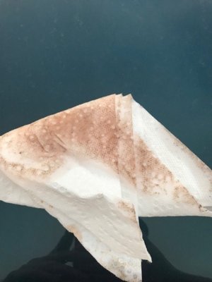

As always when you are trying to do cool shit to your truck, the Hoe inevitably laughs at you with a truck issues that needs to be fixed and pulls you away from the mods.
AS of right now I have a leak. I am about 80% sure its antifreeze. Its leaking from the back of the engine compartment onto the skid-plate. There is still fluid in the reservoir, but it is leaking a lot. I haven't been able to locate the source of the leak yet. Luckily I have a work vehicle so the Hoe is parked right now.
Anybody had this issue?
View attachment 212246 View attachment 212247
From your picture it looks to be right under the water pump.
I checked there already. That seams good. I might take the skid plate off tomorrow at lunch to see if I can get a better view. Seems to be coming from closer to the firewall.
I search the forum and seems like people where having the same issue it’s either some quick disconnects or hose connections having to do with the rear ac/heat
Yes... These little buggers right here

So after going to the Transmission shop Saturday morning (of course the leaked wasn't leaking while I was there), we were able to cancel out any tranny leaks. We were able to identify that the leak had a few places to monitor.
I went to my shop today, turns out the water pump was the culprit of the leak!! I'm also getting some other things fixed while its there.

Nice. That's sure what your picture looked like it was.
