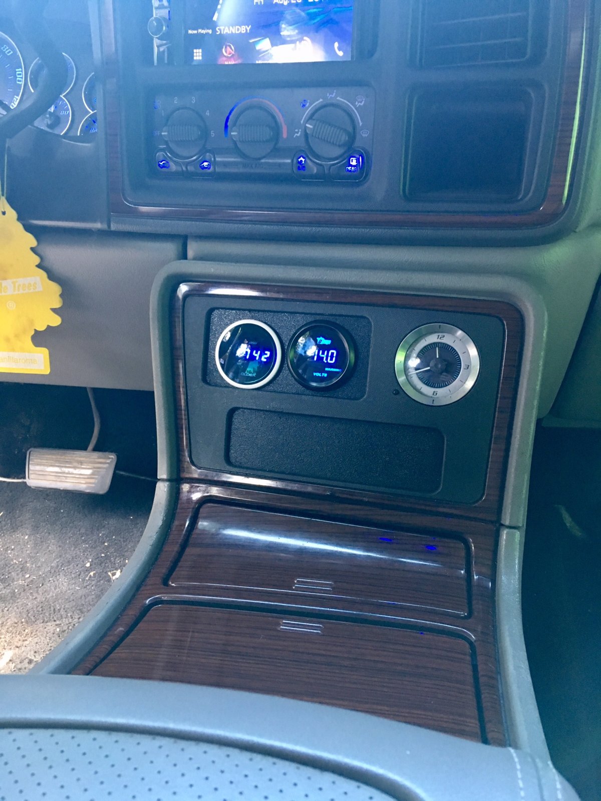

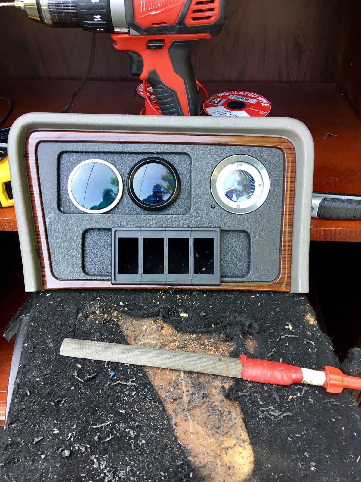

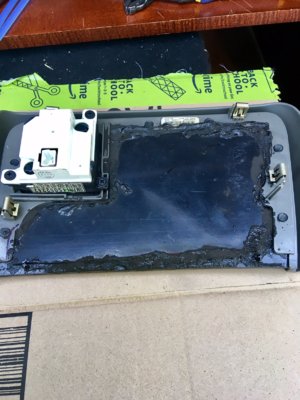

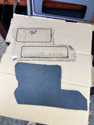

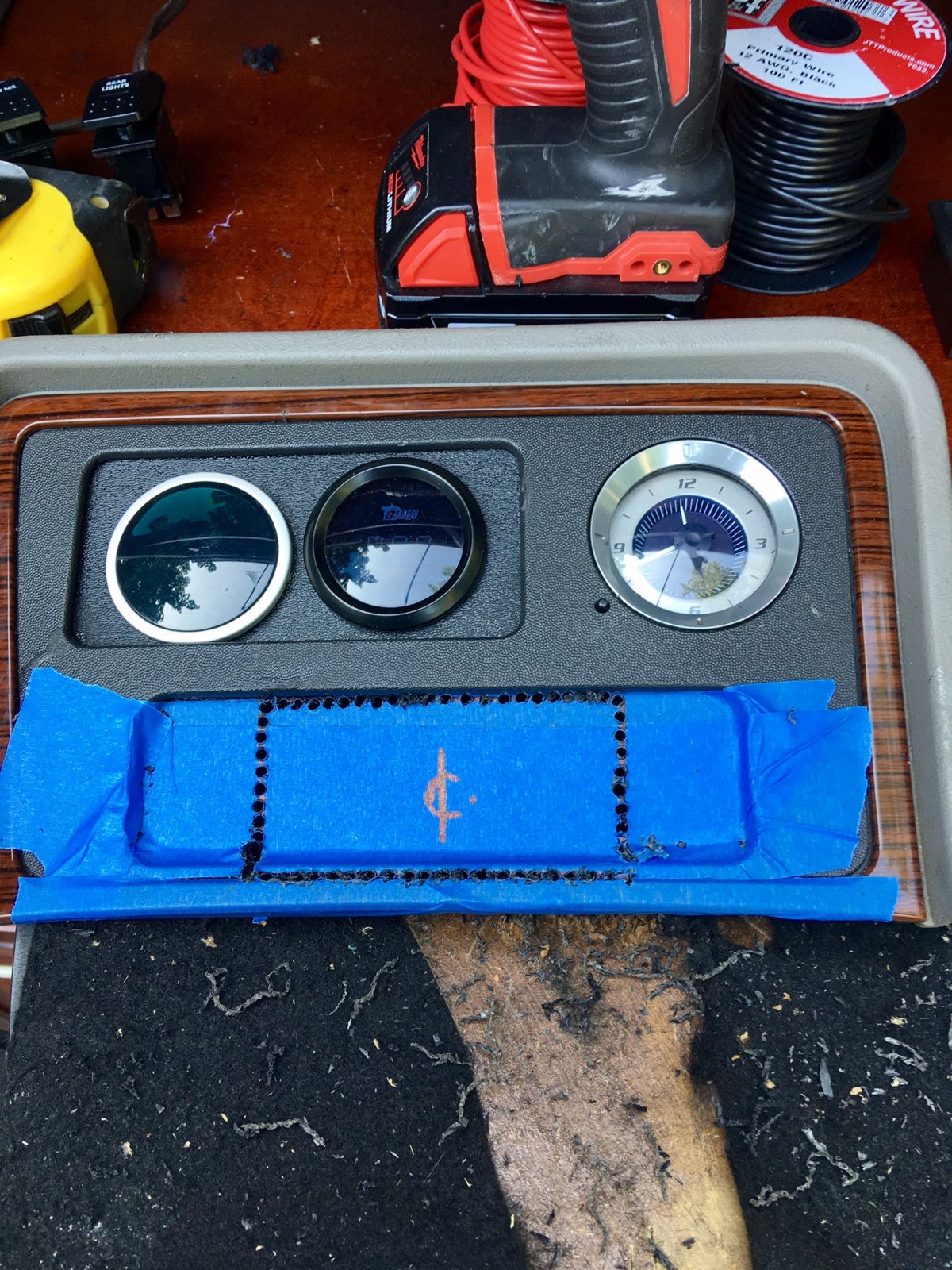

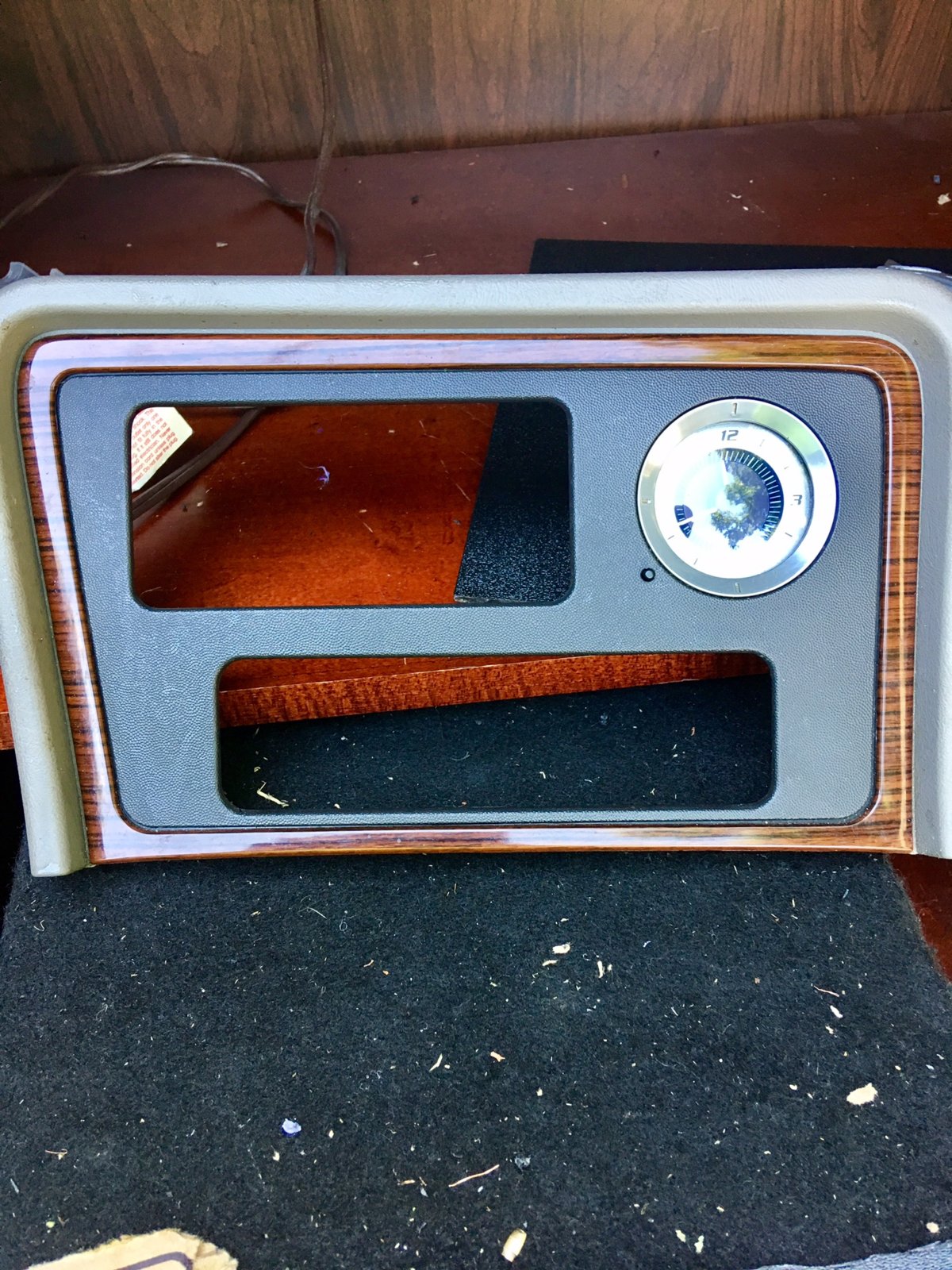

I did some more custom work to the Escalade clock bezel using a sheet of 1/8'' black ABS plastic.

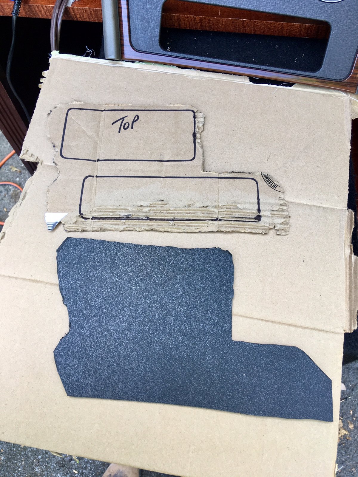

I made a cardboard stencil then transferred my measurements over to the ABS plastic

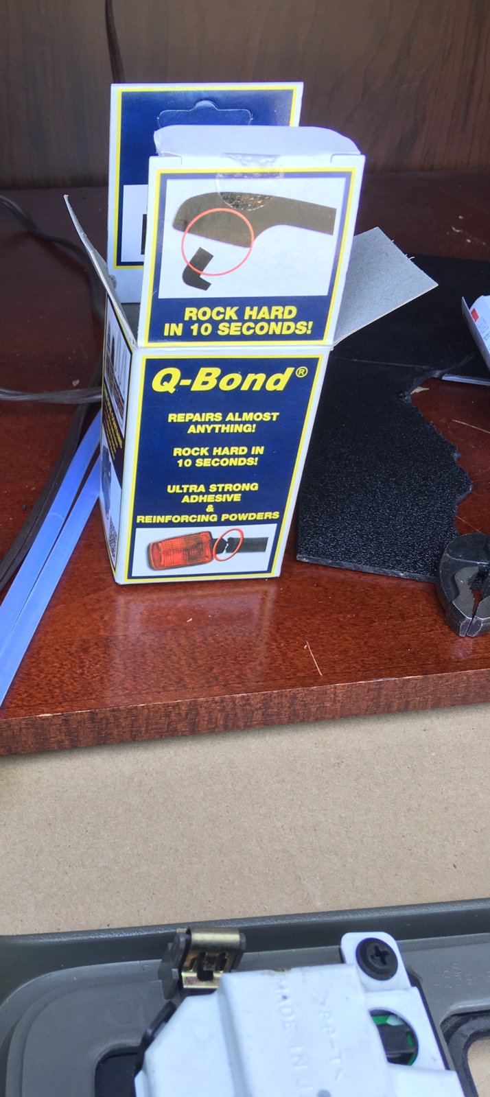

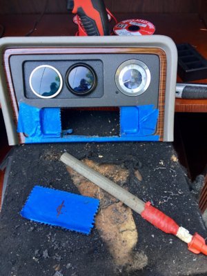

I used Q-BOND to attach everything together...this stuff is amazing! I mixed the black powder with the glue waited for it to start smoking then watched it harden into plastic! great stuff
Here is what it looks like after it drys...turns hard as a rock

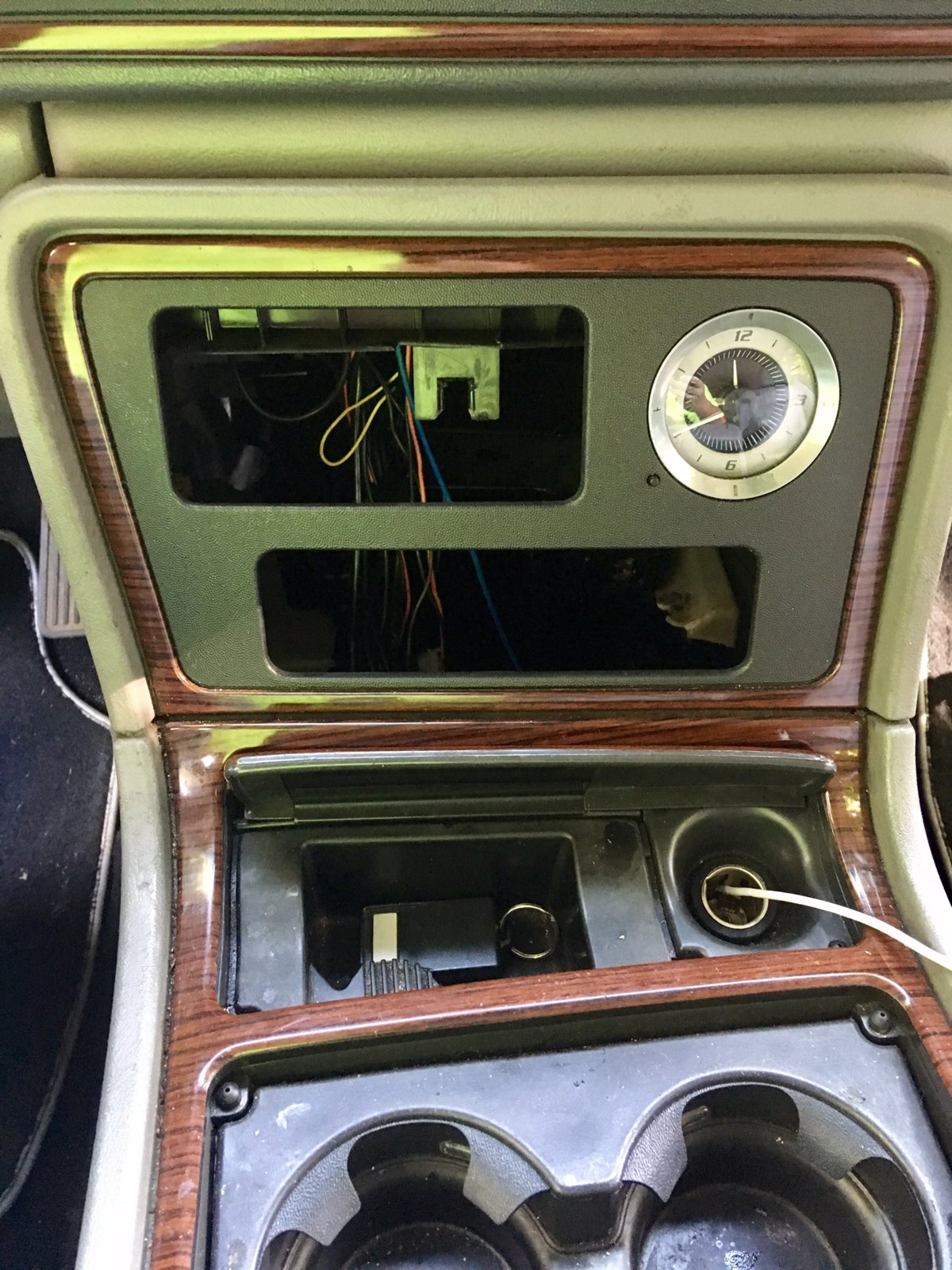

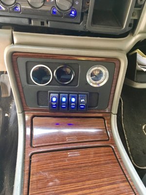

I installed 2- 52mm gauges in the bezel but I kinda rushed it and didn't line them up perfect...I'll fix it another time
Just need to find my 4 gang switch plate for my rocker switches I'm going to install on the bottom half of the bezel one of these days
Looks good. Matches the size of the click perfectly. Which gauges do you have and what do they monitor?
Thanks brother, I have a bunch of gauges but they're all M.I.A. at the moment (too many boxes & too many parts)
For now, I threw in a voltage gauge and a clock until I locate everything...the holes will fit any 52mm gauge regardless. I was tired of looking at the open slots...I still need to add a piece of ABS plastic up by where the traction control hole is

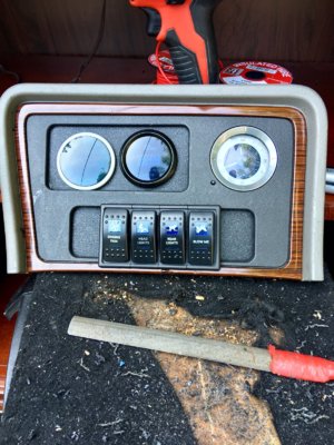

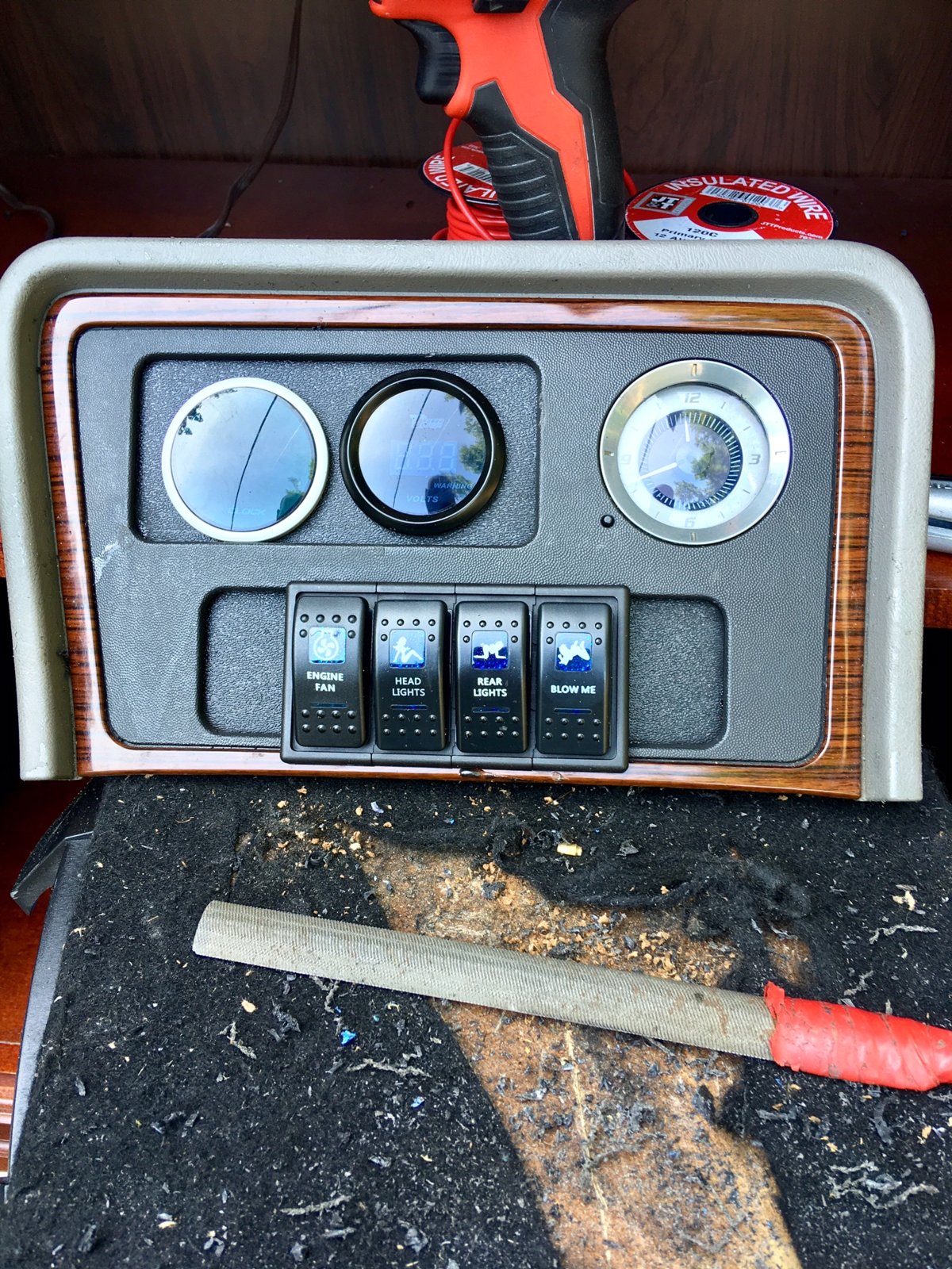

Perfect weather for modding today...I'm going to attempt to install and wire up all my rocker switches today
I'll try and knock it out quick the way Mcgregor should have knocked out that cocky little ***** Mayweather last night lol

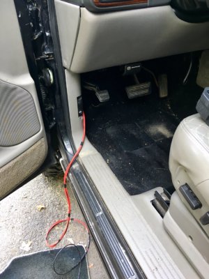

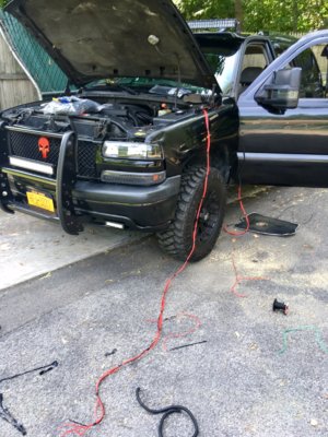

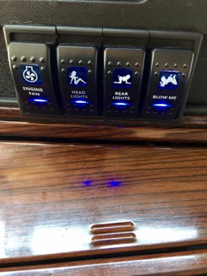

So far the only thing I was able to get to work was the rocker switch for the electric fans, I ran out of spaded lugs
Nothing made me happier than my brilliant neighbor driving over my wire as I was pulling it in through the firewall! lol wtf is wrong with people

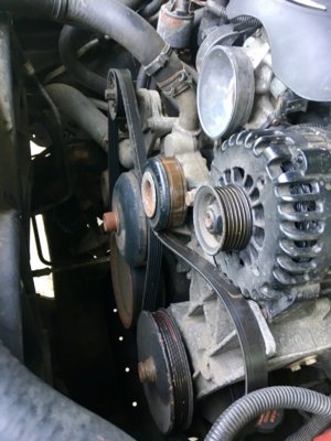

while testing the amperage on the new fans, I dropped the multi meter in the engine bay and managed to throw the belt off of the pulley lol...yea, it was one of those days

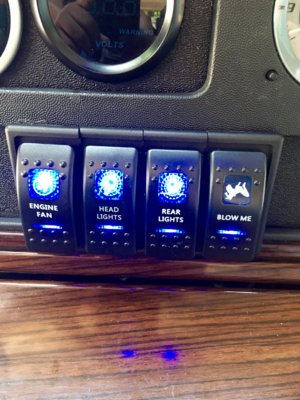

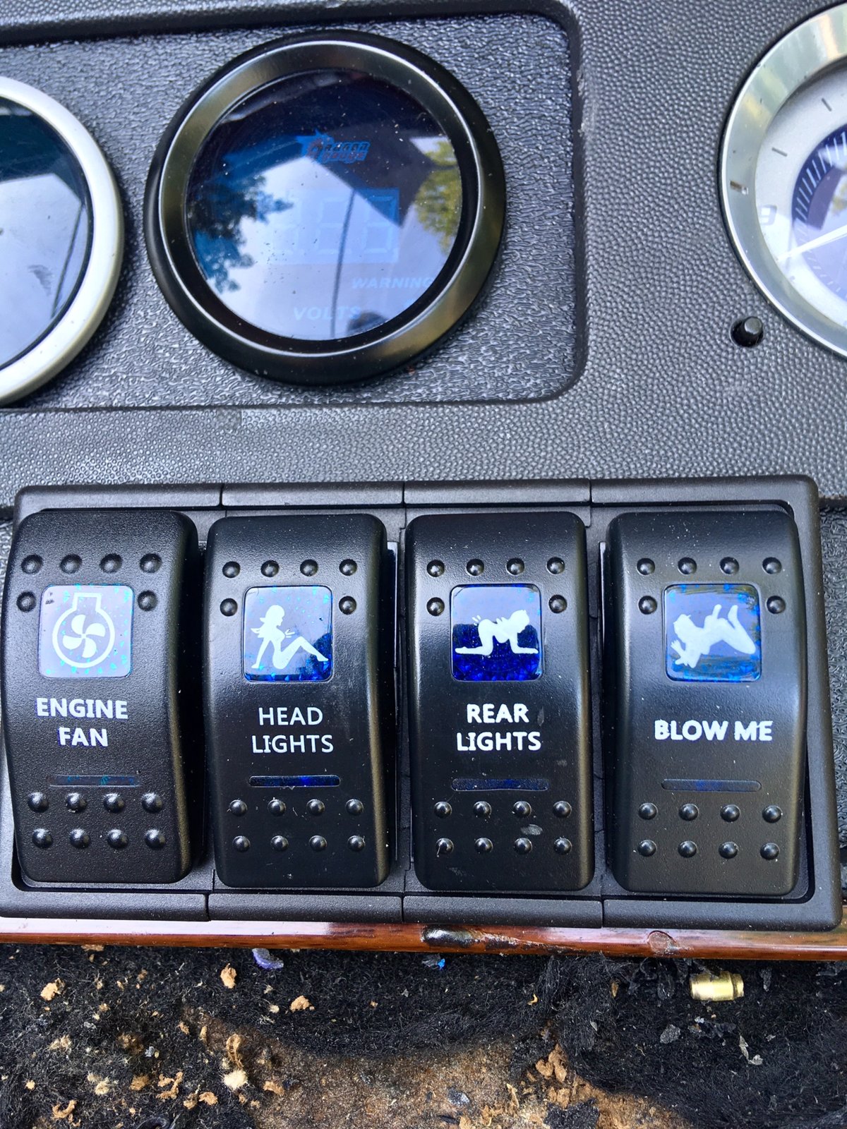

lol @ rocker icons
i like it
the last one for LED light bars, train horn or ?
Headlights= 22'' led light bar mounted on the push bar...Rear lights= 2- 6.5'' led light bars mounted on the rear bumper(for people who drive up my ass or people driving with high beams on behind me)...Blow me= 52'' led light bar on the roof(for oncoming traffic who drive with high beams on)
