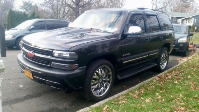

What's up guys, I've been meaning to do a build thread on my '01 Tahoe LS for a while now but haven't gotten around to it. First things first, I just wanna say what a good group of guys there are on this forum who have helped me and suggested things to improve my hoe...thank you
A little bit about me, I'm a NYC fire fighter and a union electrician, yea I like to double dip pension wise :D I've always been a car guy...I eat, sleep and shit cars! This is my first Tahoe but I've always liked this body style and finally found a cheap one on CL for $1k
Ok, enough rambling...Here are a few pics of how I bought it

I'm sure I'm forgetting something, just because you don't see it mounted on the truck means they're sitting in a box waiting to be installed and pissing my wife off at the same time :D..here is what she looks like as of now...after installing the leveling kit and some new wheels and tires
