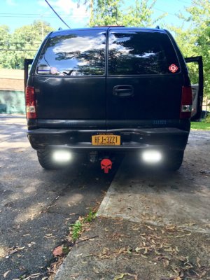

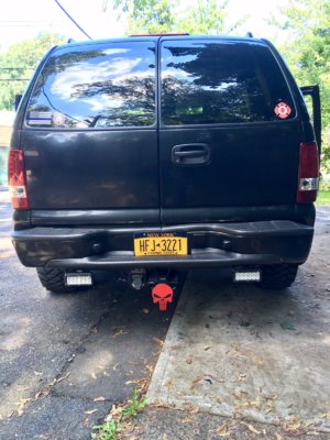

Going to remove the smashed rear bumper on the Tahoe today and replace it with the Escalades rear bumper along with new 6.5'' led light bars
Did some research and it looks like all I'm going to need is a 15,18 and 21mm socket to remove the bumper...I already looked to see how bad the rust was, let's just say there's going to be a lot of cursing involved lol

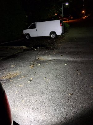

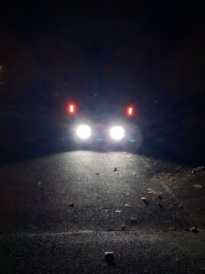

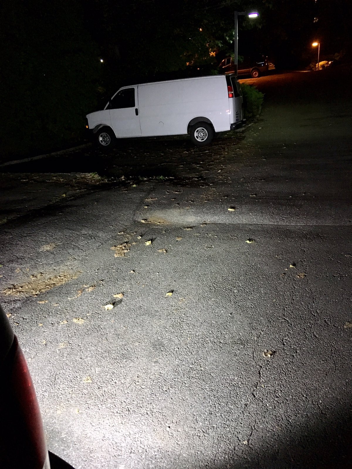

Well as I mentioned earlier, there was a whole lot of cursing involved in removing the rear bumper but the damn thing just didn't want to come off...I sprayed the nuts and bolts with lots of WD-40 but 4 out of the 10 just kept spinning and wouldn't back out
Looks like I'm going to need to either cut them off with a sawzall or get myself a torch. I got sick and tired of messing with the nuts and bolts after 3 hours so I moved on and installed the rear led light bars...I took some pics during the day and they were bright but I just got home now that it's dark out and these things are insanely bright!
I'll take some more pics in a little while when I go get gas
