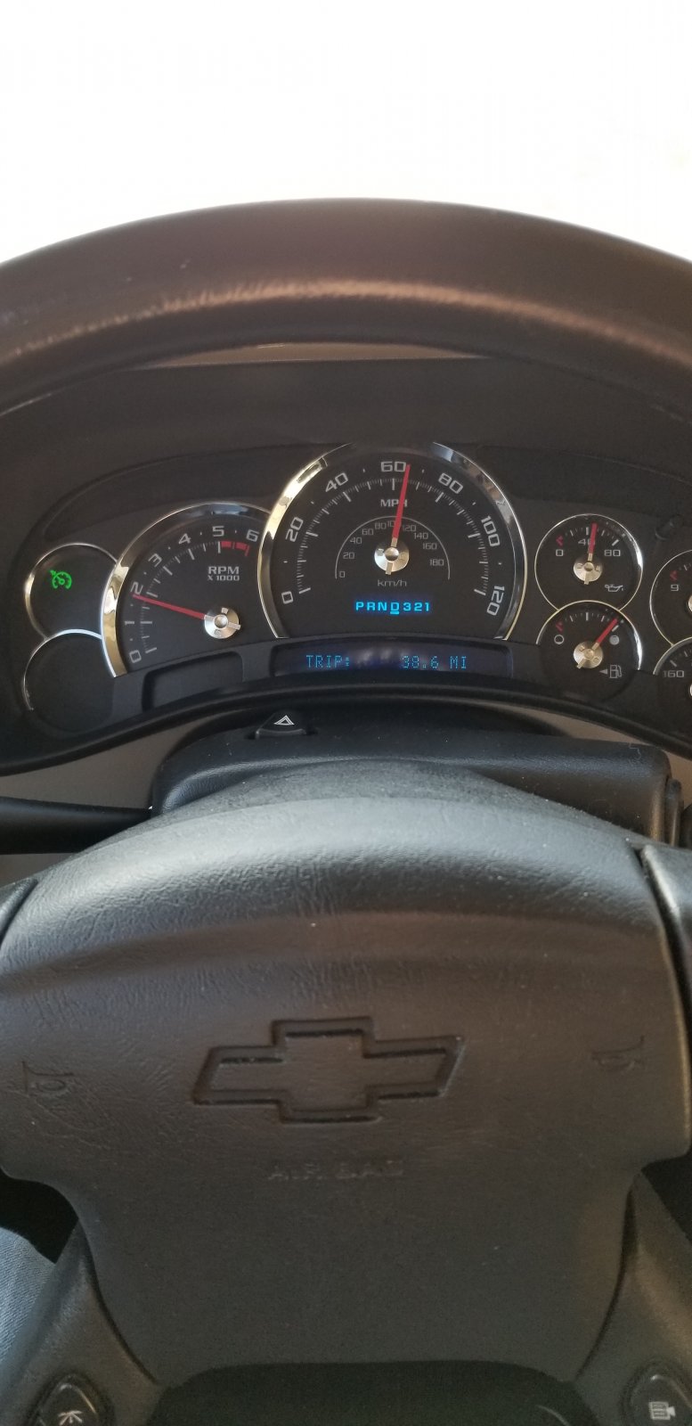

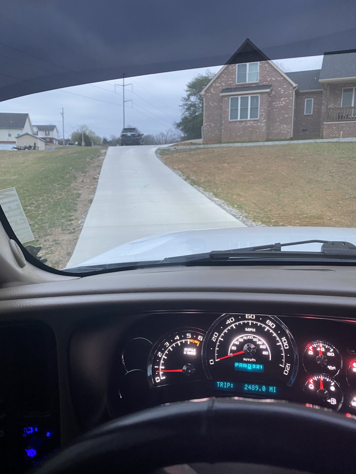

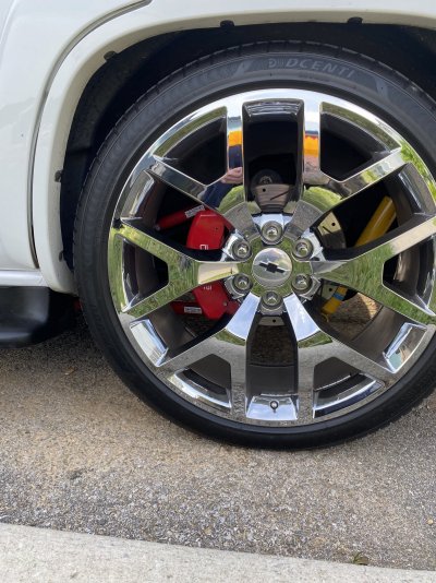

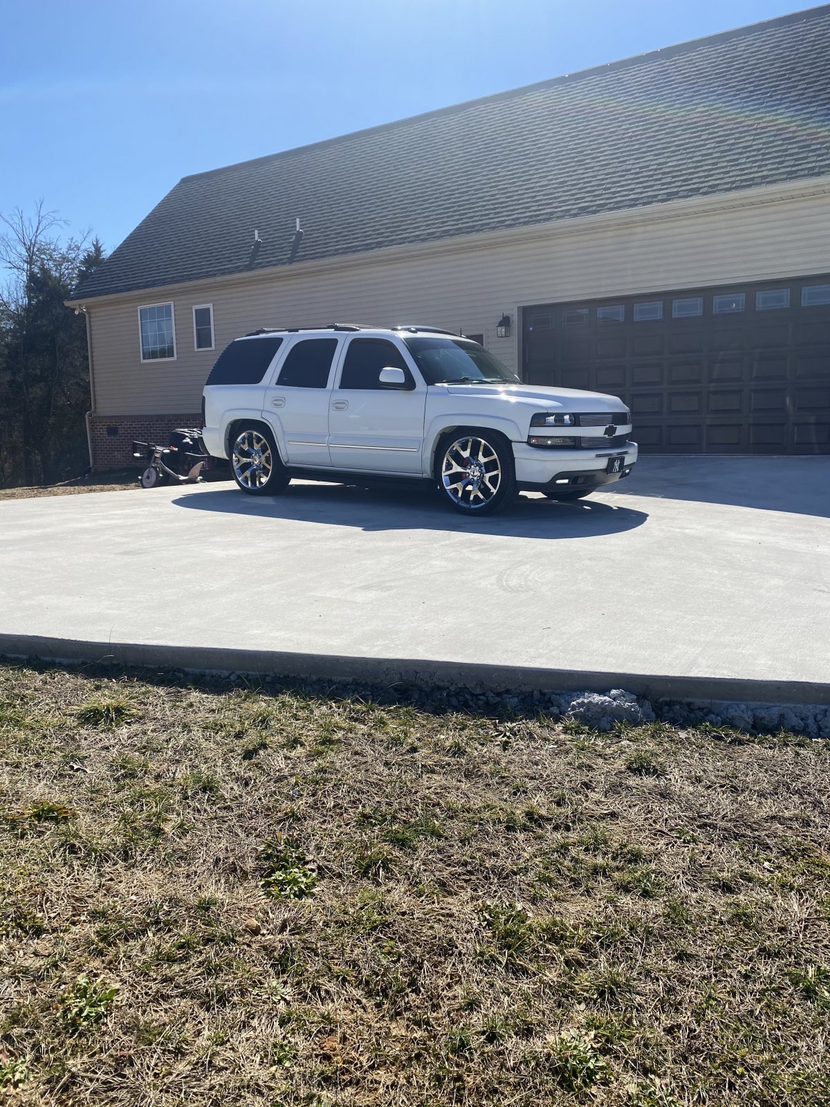

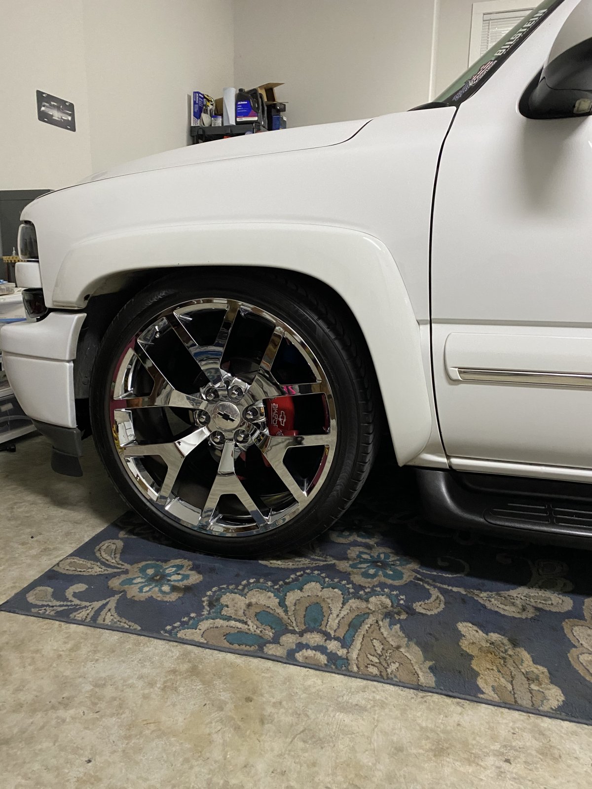

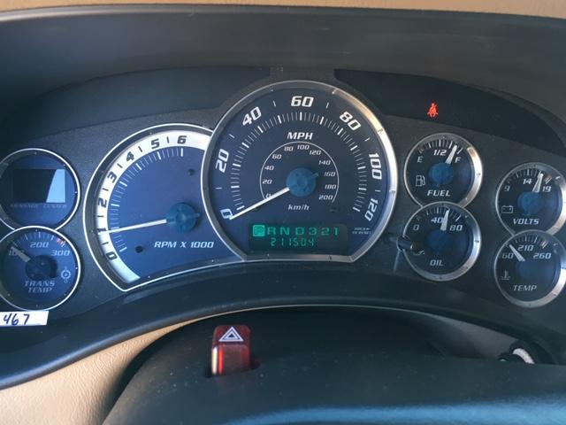

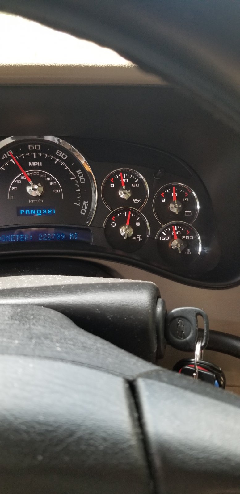

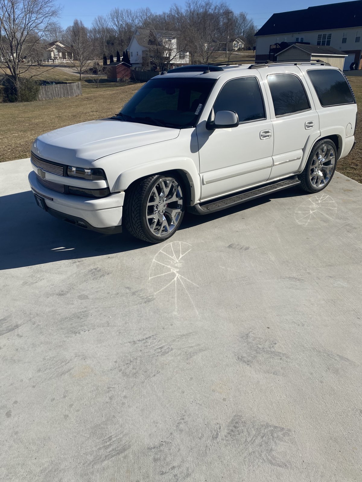

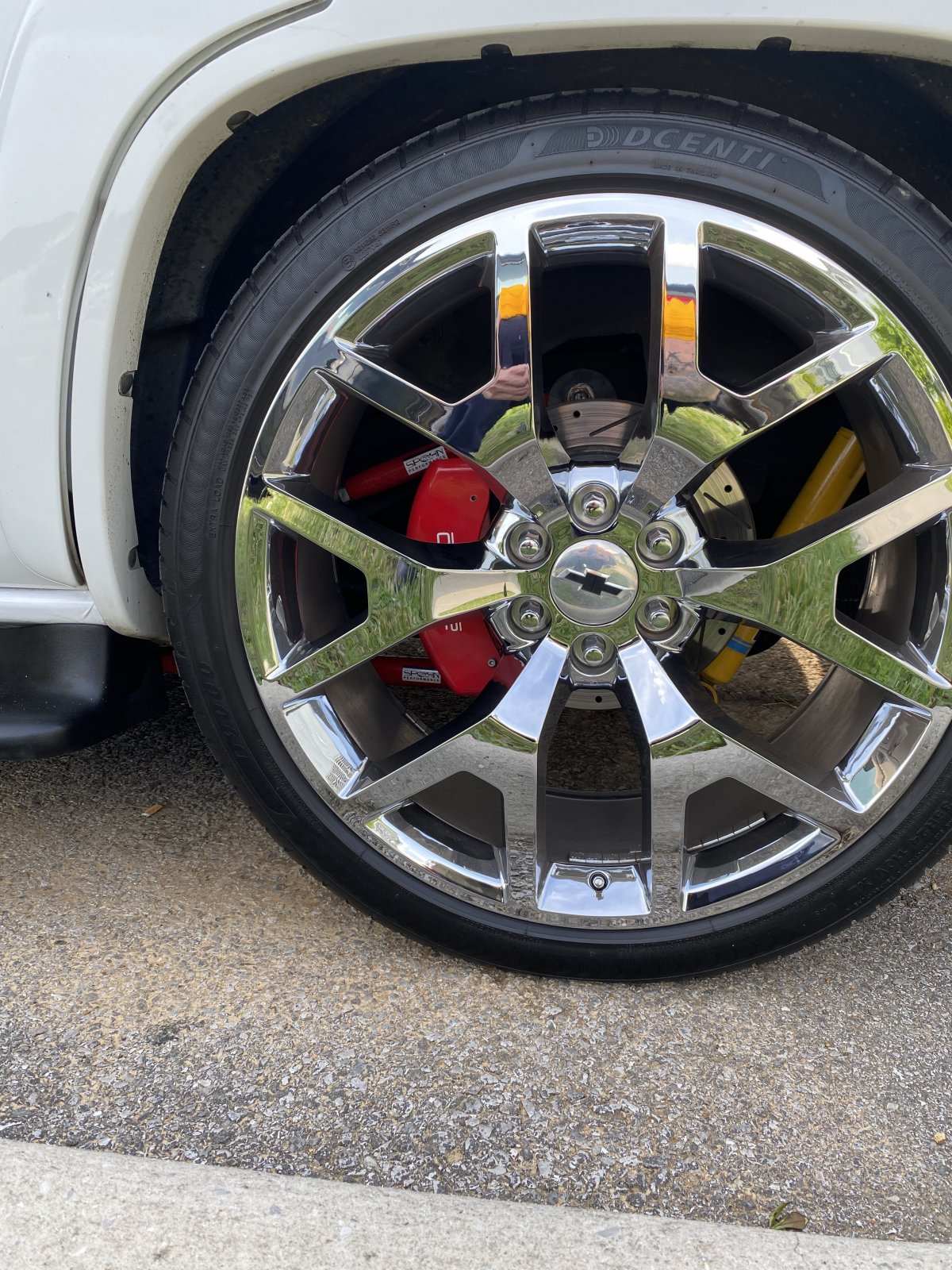

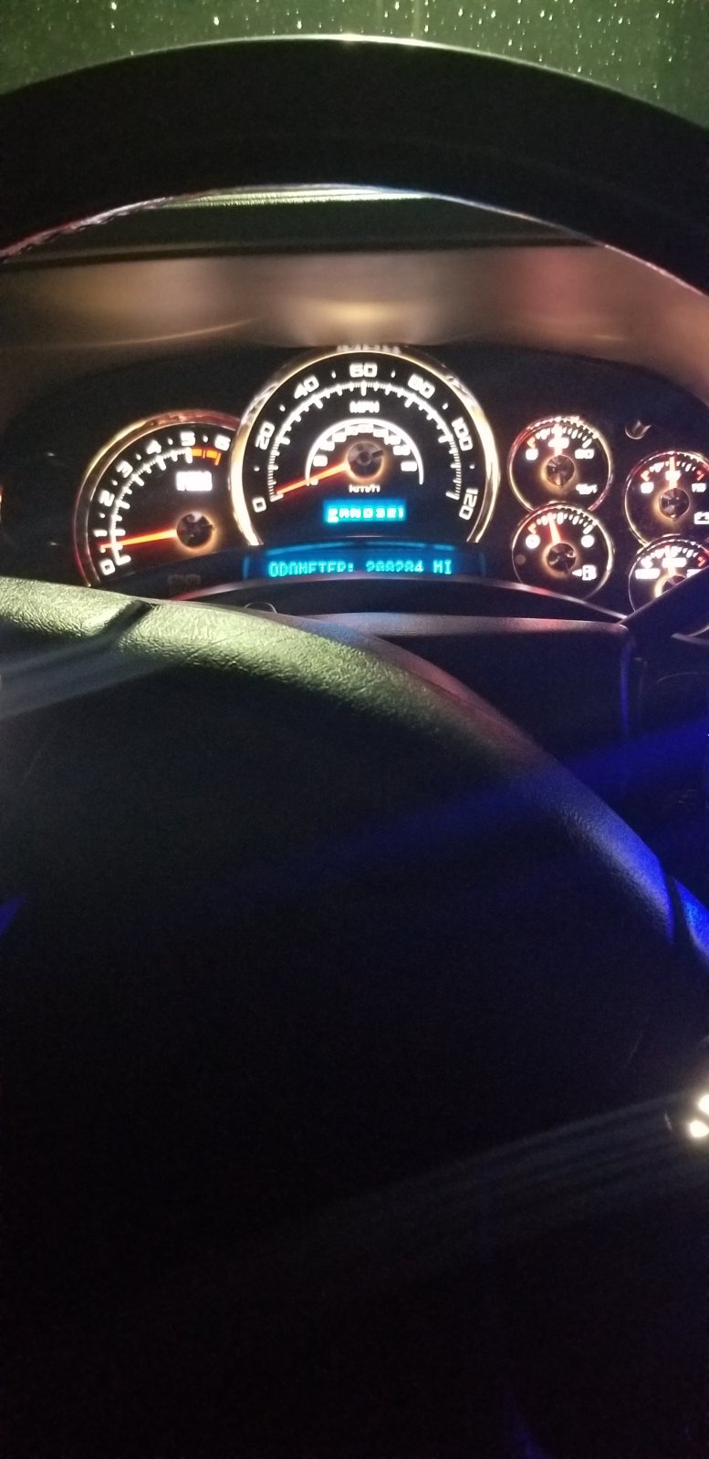

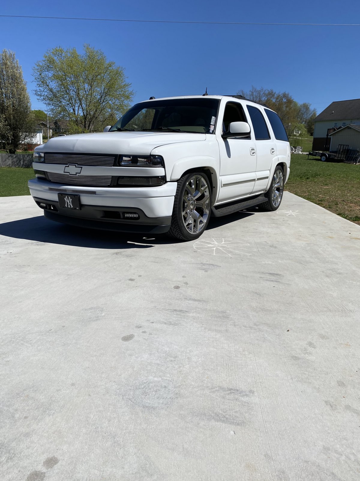

Here’s my 2004 Tahoe. 2wd. Almost all the motor has been gone through though. New parts. CAI, flowmaster 40 turned down in front of axle. 24 inch snowflakes 295 35 tires. Has bilstein 4600 All around. Spohn Panhard with spohn adjustable upper and lower trailing arms on the way. Just purchased a week ago. Drilled and slotted rotors. Brembo brakes. All brand new suspension. Moog and ac delco professional upper arms and lower ball joints. Mcgaughys spindles with 3/4 ton purple keys. Rear has 4230 belltech coils with 60748 helper bags. 1 1/2 coil cut for more drop. Free travel mod. Djm rear trailing arm and sway bar kit. HD hood and grill. Don’t have bumper pad. May do that not sure yet. Also has full led conversion on dash and all panels inside. Not a single halogen light in this thing. Escalade face with chrome bezels. Red needles. Probably a lot more im missing. View attachment 277274View attachment 277276View attachment 277277View attachment 277278View attachment 277274 View attachment 277276 View attachment 277277 View attachment 277278
VERY sharp truck!

Not my style per say, but very clean! Definitely like the cluster, can you post more pics of the mods you did? I'm sure I'll find some inspo with the custom stuff.

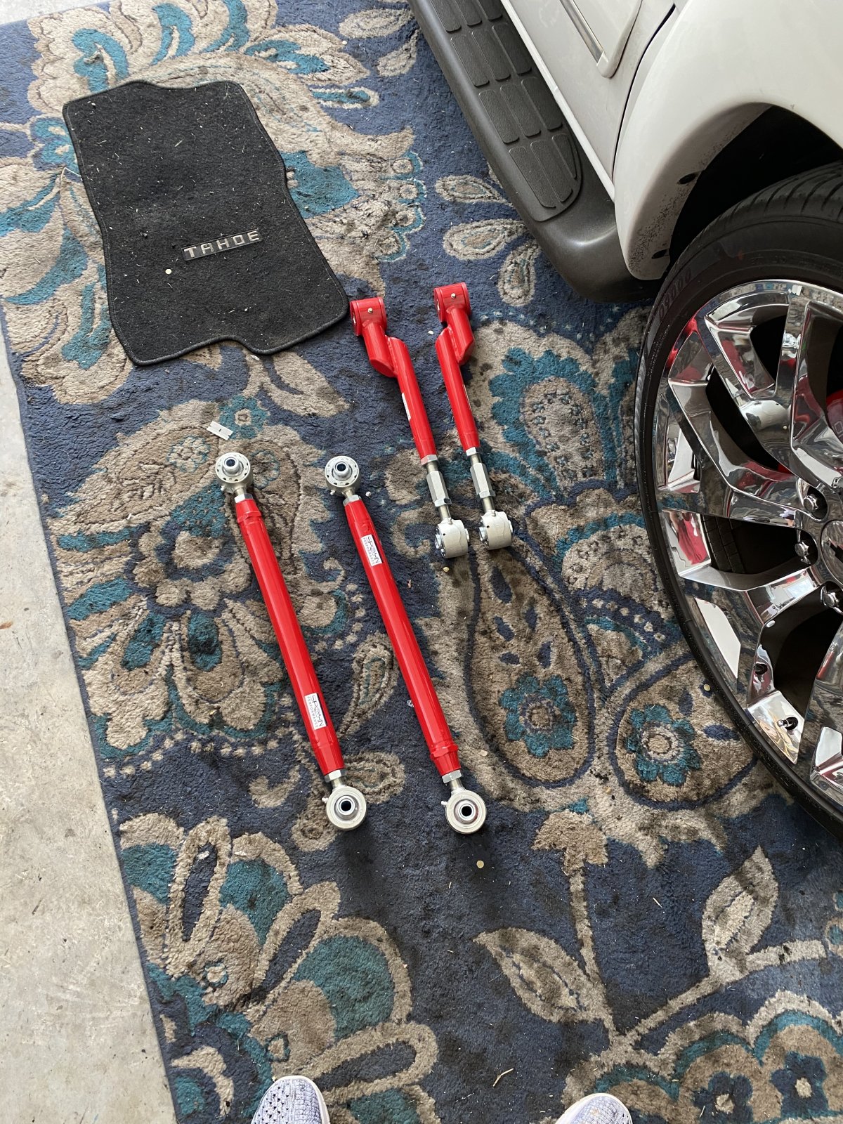

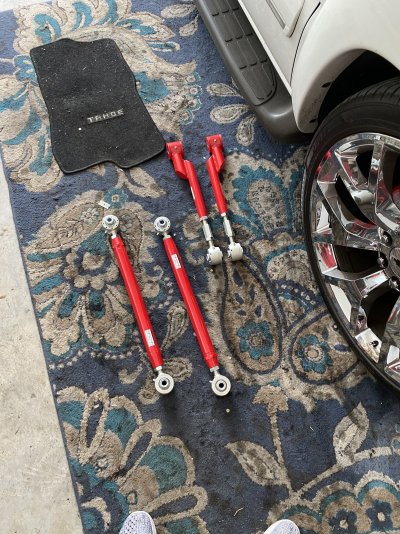

Did you get the Spohn stuff on yet?
I already had the Panhard bar. Got it about a year ago. It was so hard getting the control arms. I bought them off a seller on eBay. Carid. They said it will be about a month before they ship. So they held my money for a month then they messaged me an said they cannot get the parts from the vendor (Spohn) So I was mad. Then I called Spohn directly an talk to someone N they was like don’t know why they told u that. However we do make the parts after they are purchased so it will take a month before they ship out. So they took my payment. Month went by an they never shipped. They kept telling me it will be this week. It ended up taking almost 3 extra weeks after the month they first told me but I finally got them. I cannot tell a difference since I’ve installed them. I only wanted the look really lol. Cuz u can see them behind the wheel. I did adjust them where my wheel was moved forward in my fender from being lowered. One thing bout them is they are very noisy when u hit bumps. The factory arms have rubber bushings an these have delrun bushings. I know the material because im a engineer at a factory that molds car parts so delrun is a hard plastic. So that’s a big difference from rubber. But I like them
