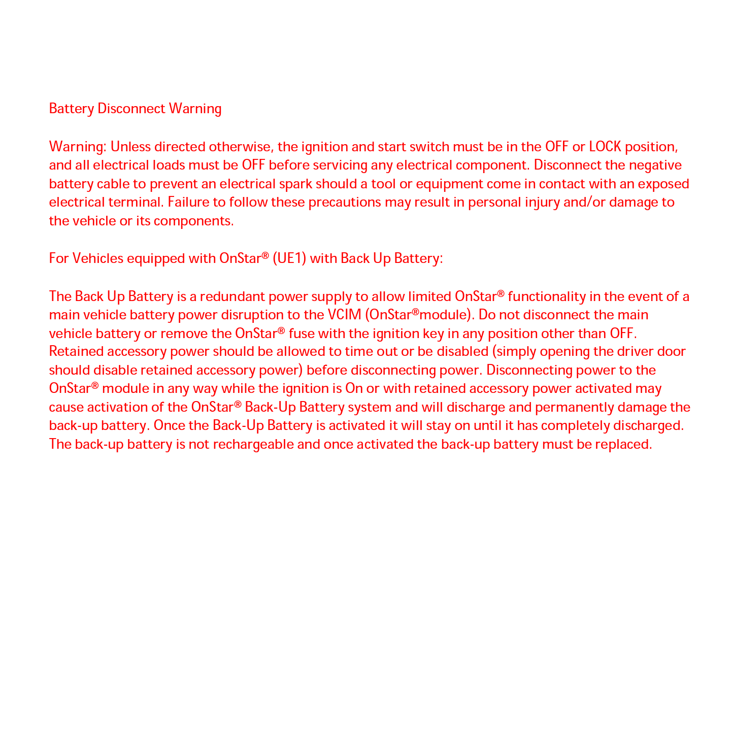

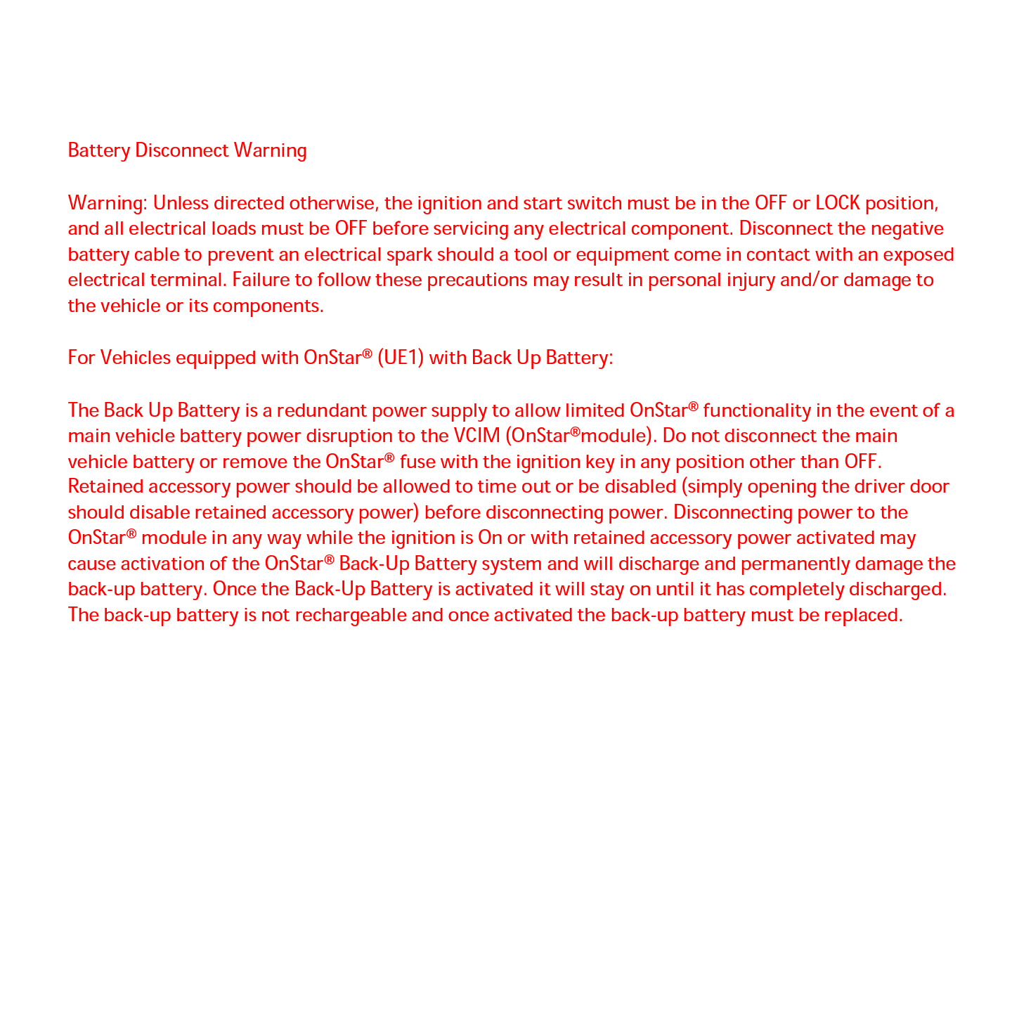

Perhhaps the wording from the dealer was out of sort or he misunderstood. I found a gm bulletin last night that specifically addressed that removing power from the onstar module will cause the module to go into a backup battery drain that cannot be reversed and will require an entire new onstar module. One of the vehicles listed was yours, the module including incorperated backup battery is behind your radio.
I know for sure they put a new bcm in and flashed it to solve the guys problem that sounds exactly like yours. Perhaps they figured the failure of the bcm was caused by onstart backup power supply draining since they are tied together electronically.?
You are correct, there is no battery inside the actual bcm, sounds like the wording of the issue was either off, or got lost in translation. There was indeed a keep alive onstar battery source that drained that was designed to allow onstar to communicate with you and the functions of your vehicle in a crash though.
Hopefull your ecm fixes it, but you know where to point the mechanics as another possible issue if it doesnt.
