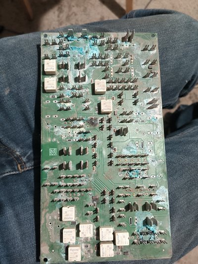

UODATE: Bit not out of the woods as of yet. First off all thank you all so much for the quick and very intelligent and knowledgeable responses and advice . I found a short to starter relay circuit and chased wires for awhile. Found that my starter fuse had. Short to ground, all pins on the relay gave proper reading or no readings as per diagnostic checks , for the life of me I could not find why the fuse has a short to ground .. I sat for awhile and researched and researched till my brain could not comprehend what I was reading. Then I started talking to myself... I said self one of the wise members of your forum suggested fuse box, and you blew it off as surely that couldn't be the issue. Well I did .some digging and yes I completely forgot that you can split a fuse box carefully. OMG STEVE look what I found! So I have one on the way been checking all wires on the meantime and when it comes in I will let y'all know. Sorry for the book. And thank you all again.... MERICA
haah you posted before I did, houston I think you found the problem
