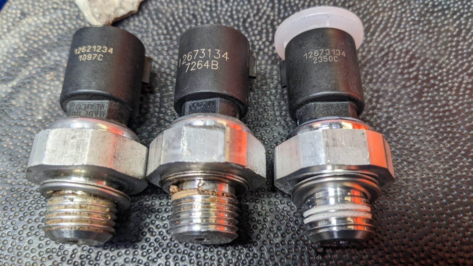

that's literally the exact same "oem" sensor I bought off Amazon and had to change it a few months later over wackyness. I'm 99% sure it's counterfeit or at least from a bad batch. sort by 1 or 2 star reviews and scroll thru.
here's a pic.. left is the original from 2011 middle is the Amazon, right is new from a local dealer. they look exactly the same except for the font on the laser printed part number is different.
I no longer trust it to save 20$ local dealer will. usually match or very close to gm parts direct price if you ask them too
