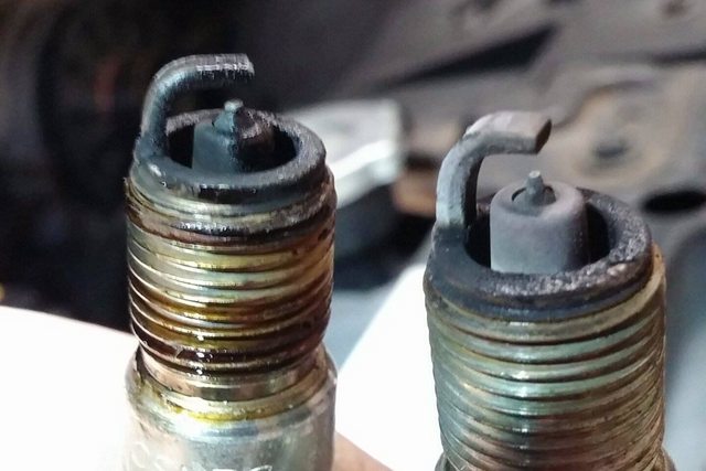

Pulled #4 plug and it was pretty gnarly (#4 on left, #2 on right). Checked all 7 others and they all pretty much looked the same as #2.
Replaced the plug with new NGK unit and gapped to spec. Still missing. Then put in new Delco cap/rotor and still missing.

If it smells like fuel on the plug then do the injector balance test by the way use Delco or Autolite platinums. And never gap them. Taken care of by the factory already for a reason.
