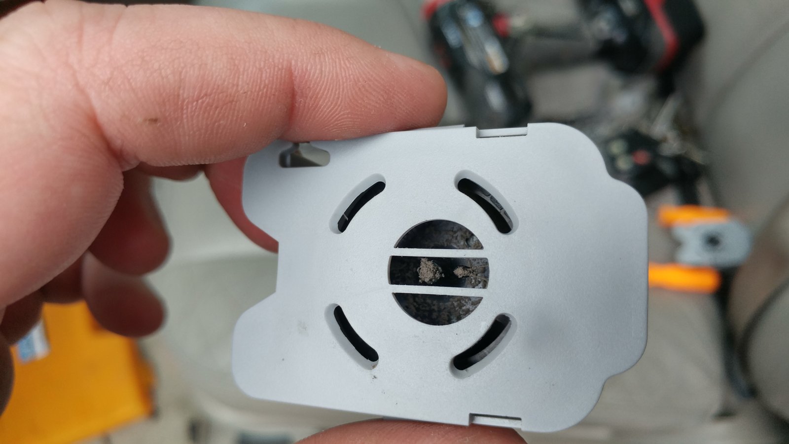

I just picked up my new to me 2005 Tahoe this morning and discovered the rear one on mine was buzzing. Merely blowing out the built up dust didnt fix mine. They ARE serviceable for anyone handy enough or inclined to give it 20 minutes of your time. The hardest part was coming to the eventual conclusion that the only way to get them out is through the hole itself. I thought wrongly that there would be a way in through either a some light or the vents.
For anyone interested here's what I did.
1. I took my ghetto fabbed trim tool (aka bent butter knife) and pried off the plastic cover.
2. Widen the opening by carefully cut the headliner about a quarter inch in four places equally around the opening.
3. Pull the aspirator and wiring through the opening with some plyers...two pairs and some wiggling got mine out fairly easily.
4. Unsnapped the wiring connector.
5. Carefully separate the top and bottom "housing" to the aspirator.
6. Separate the fan and electrical board from the bottom piece...there's a couple black pieces that just took a light push to release it.
7. Carefully bdnd back the thermometer to allow the fan to slide off.
8. Using some compressed air blow off all the dust, I washed all the pieces besides the electrical board, and inspect for any damage. The mating surface on mine between the fan and the lower "rubber seat" was a bit rough causing a clicking. It took some gentle scraping but after a couple tries the clicking went away. You can test it by just pitting fan back in and hitting it with the air. A little petroleum jelly on the shaft...hehe...and she was good to go.
9. Reassemble.
10. Connect wires and jam it back in.
11. With a little wiggling around get the aspirator centered above the hole.
12. With even pressure snap the cover back on...the headliner should flex enough to allow counter pressure from the roof.
HTH
Darren

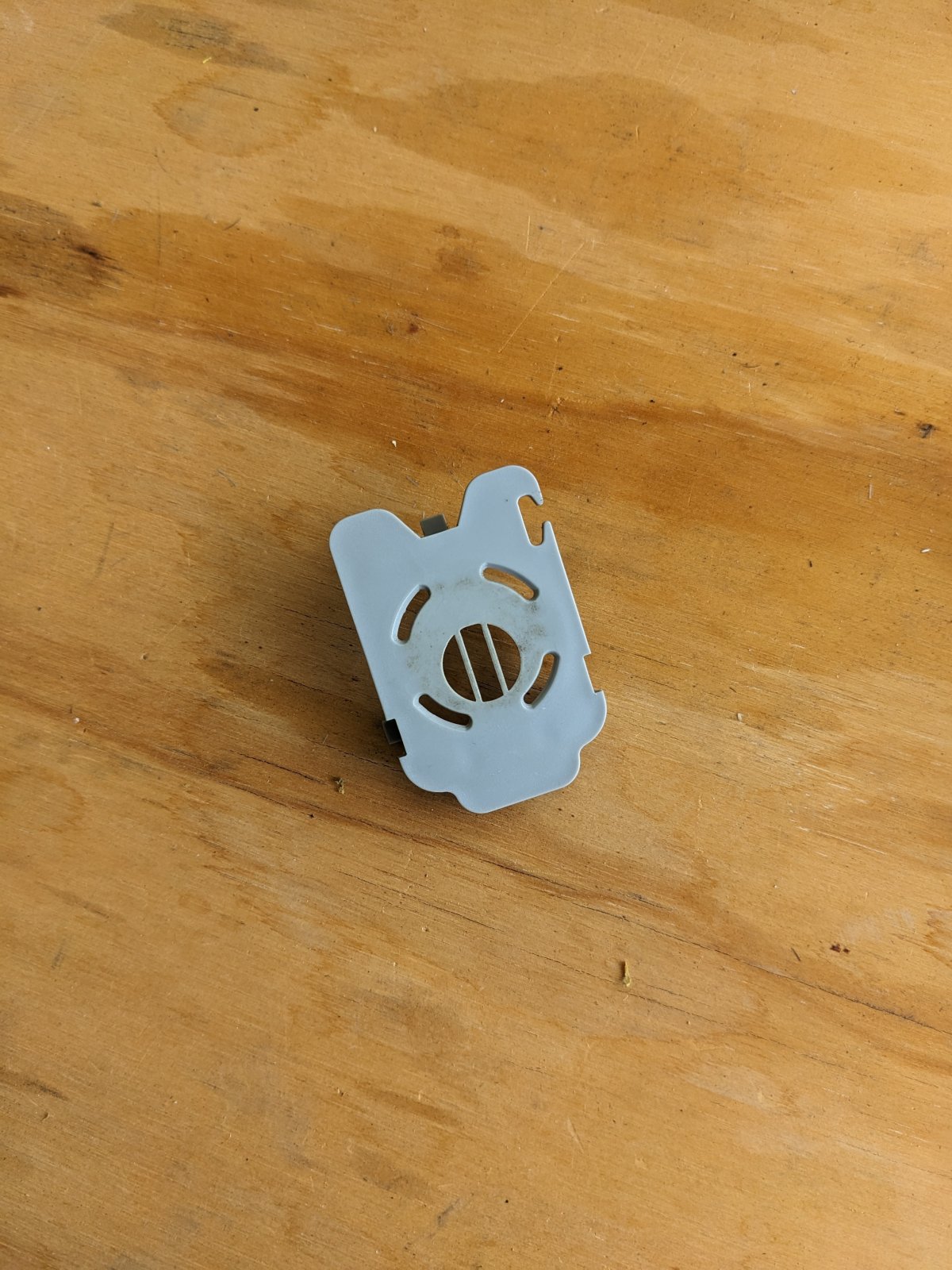

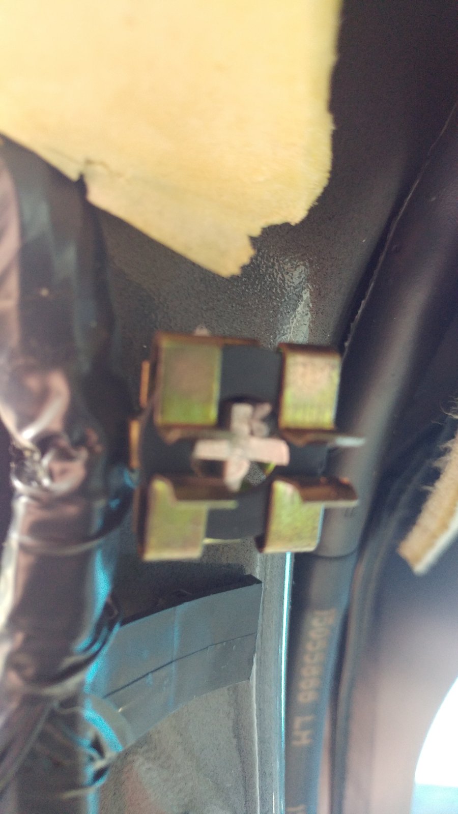

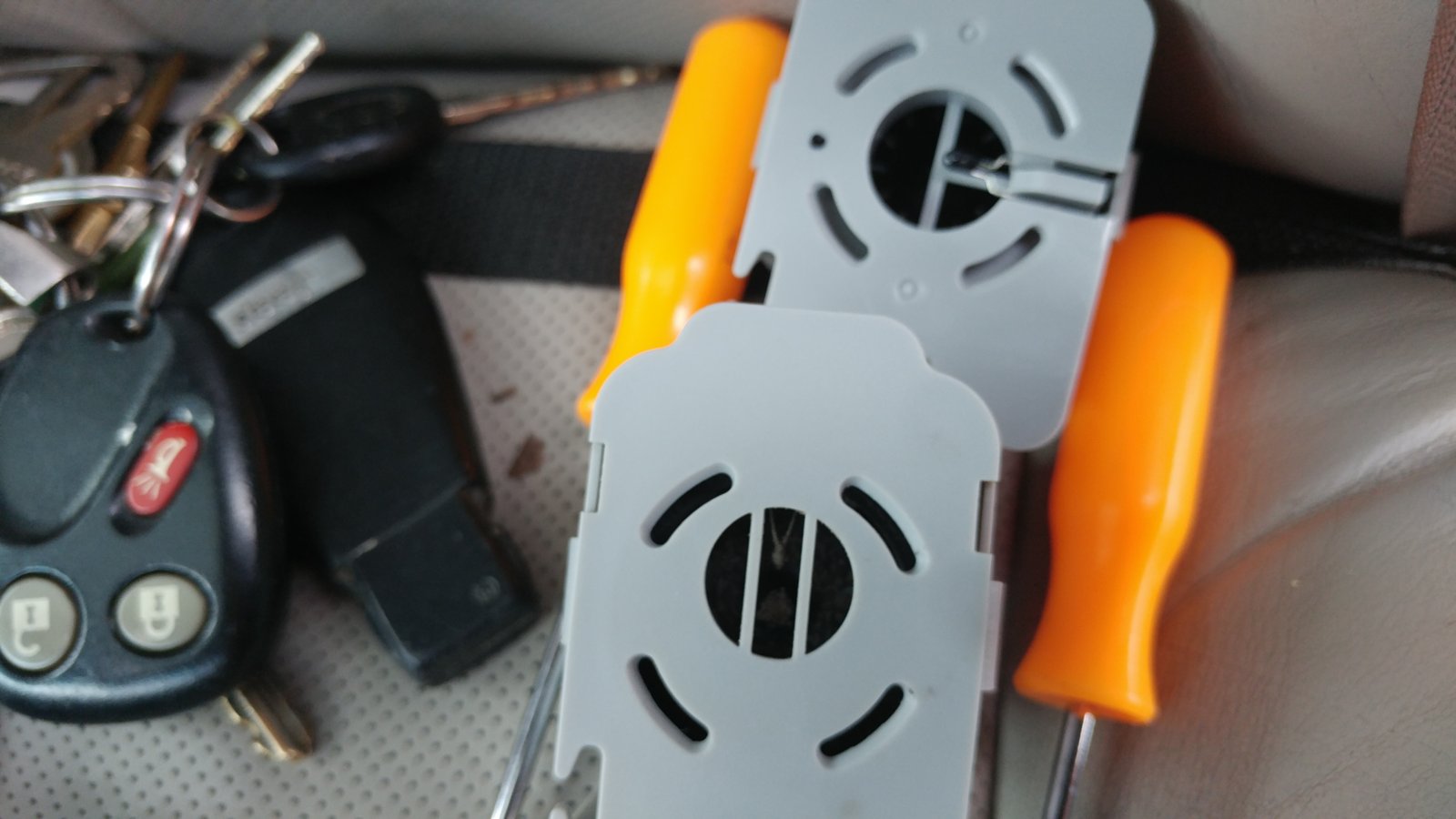

Replaced mine today. Hopefully no more hum. Old one was full of dust and junk.
New one looks slightly different.
Screwed up the a pillar cover though damnit... Hopefully plastic weld putty will hold it in there.

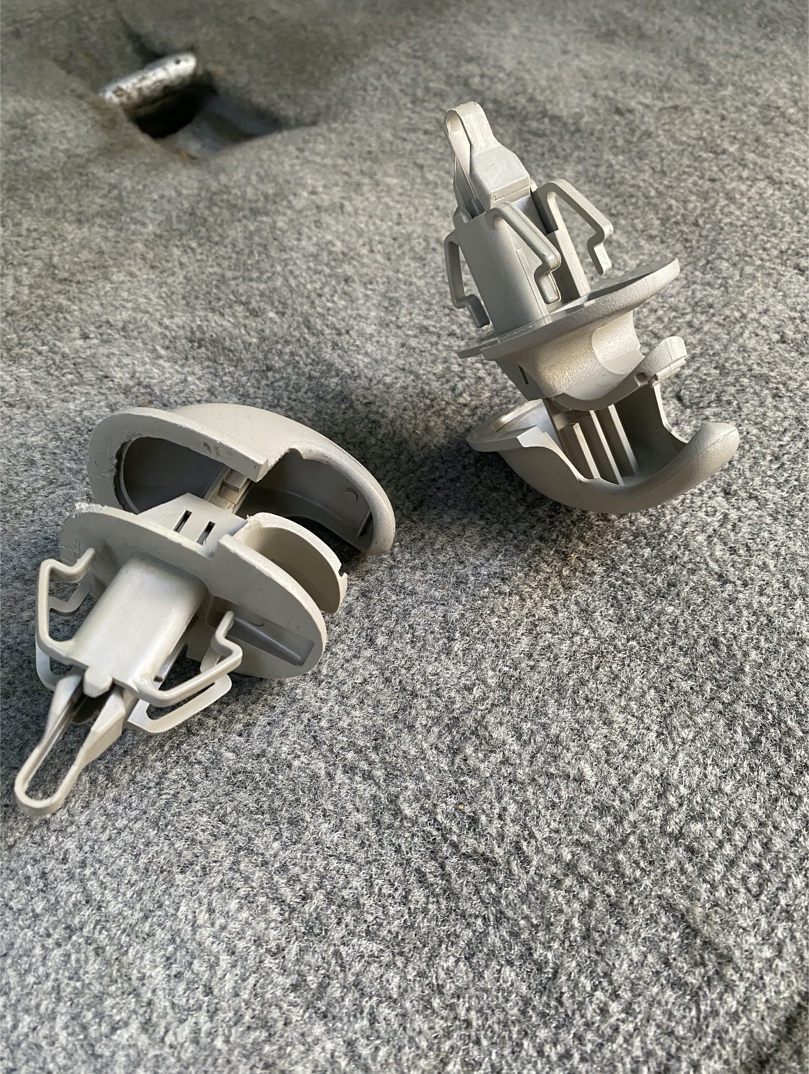

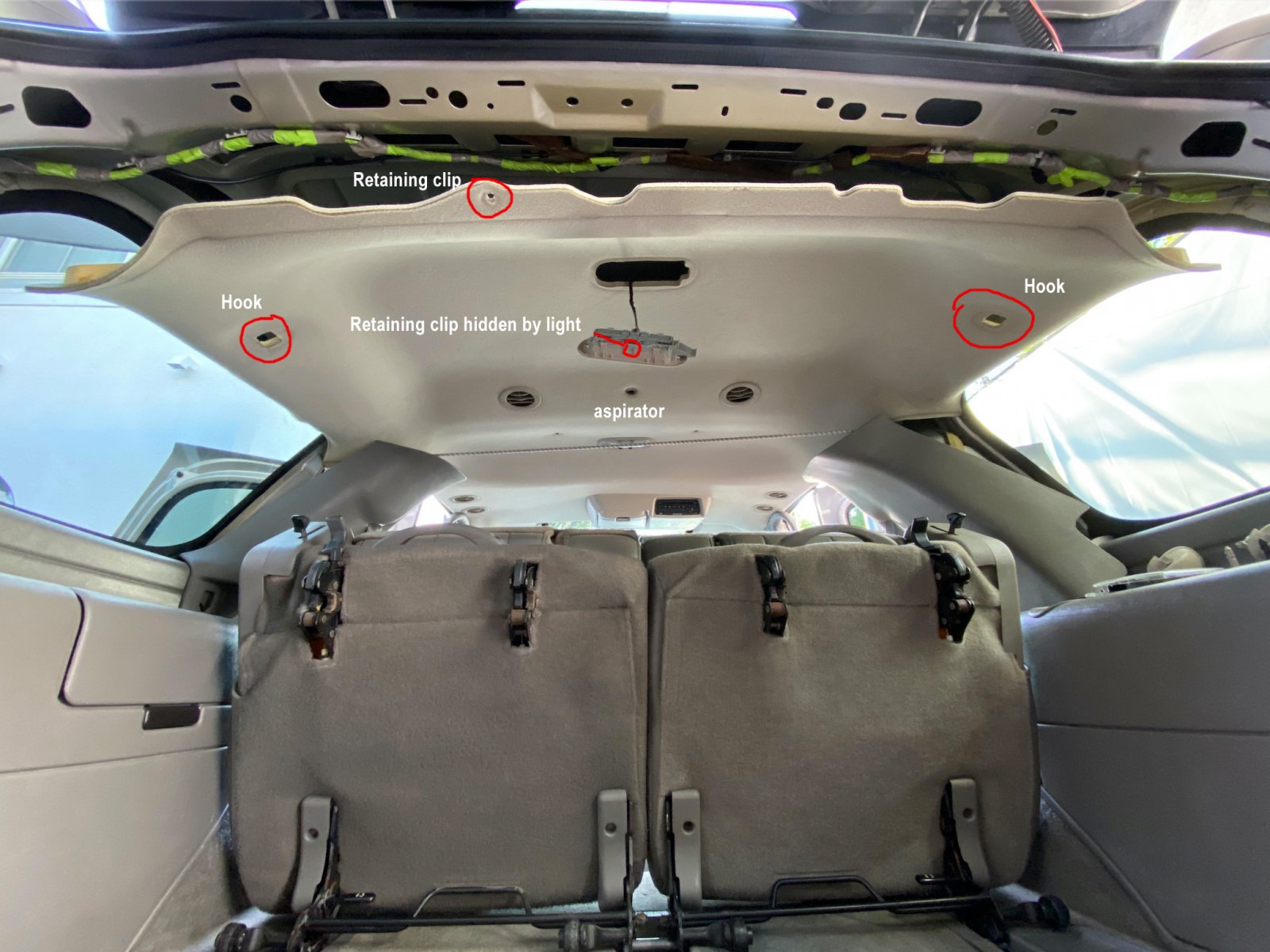

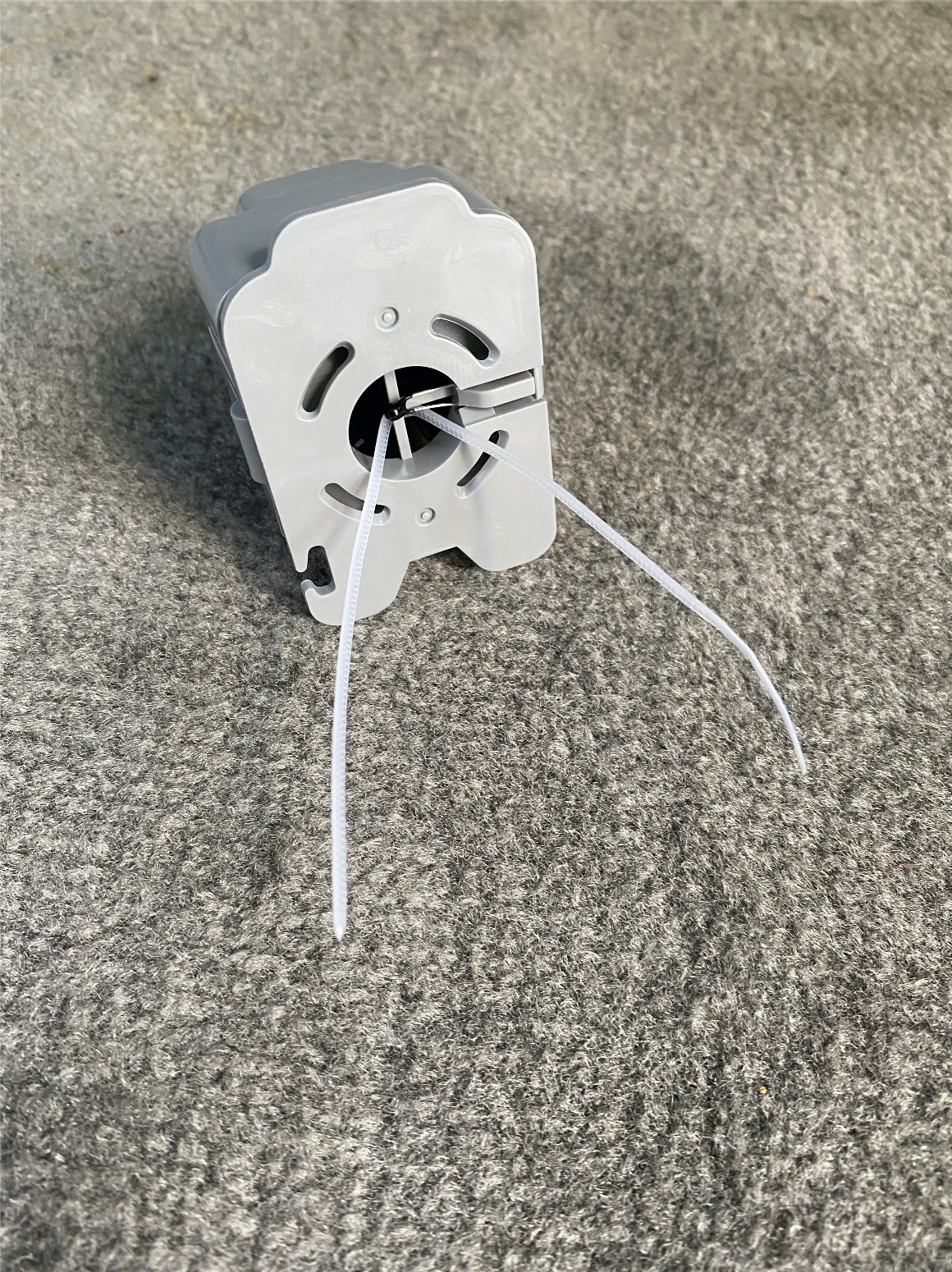

So does anybody have a tutorial for removing the REAR ceiling sensor?
Genuine GM Parts # 22834330 Cabin Air Temperature Sensor Aspirator

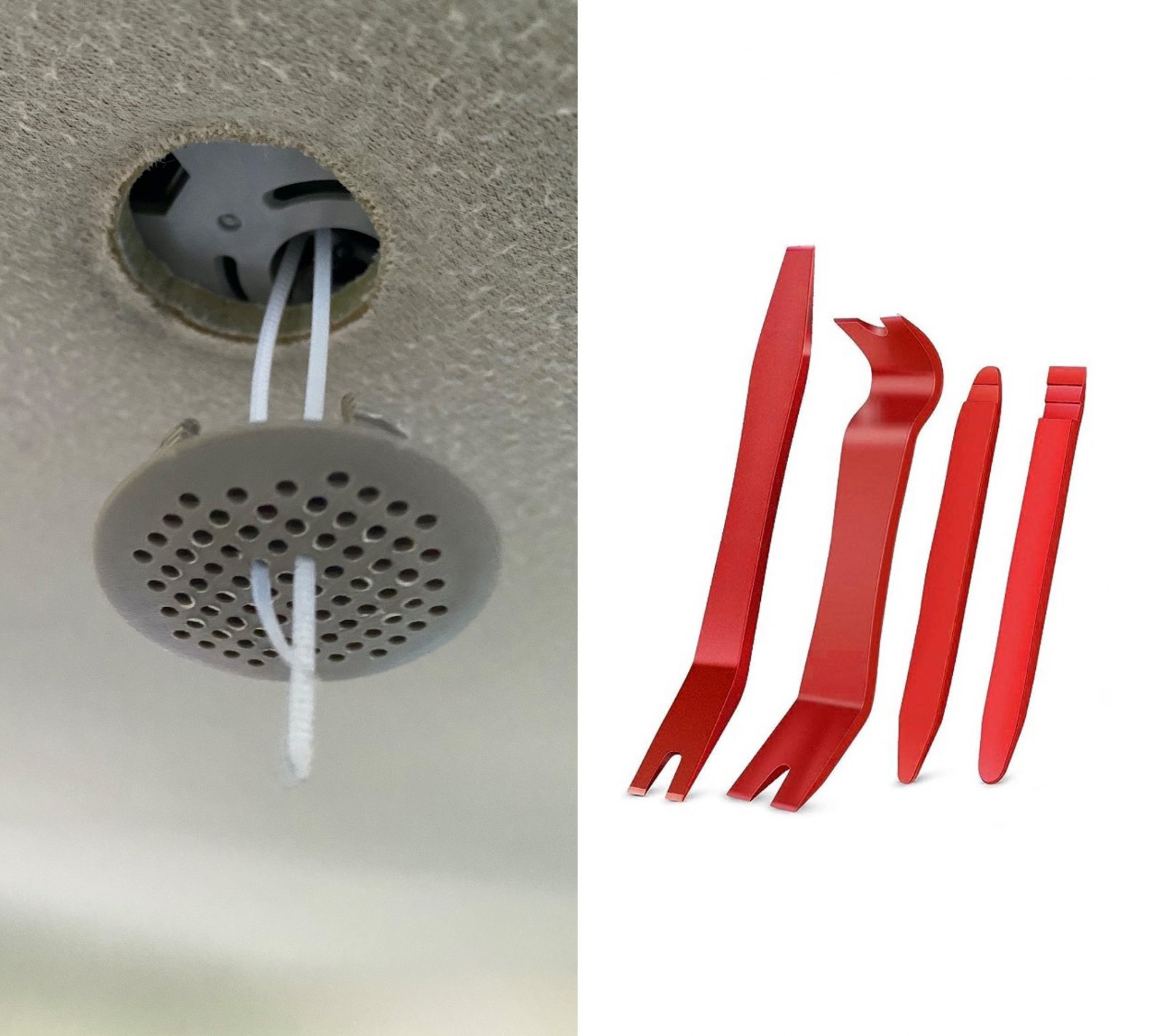

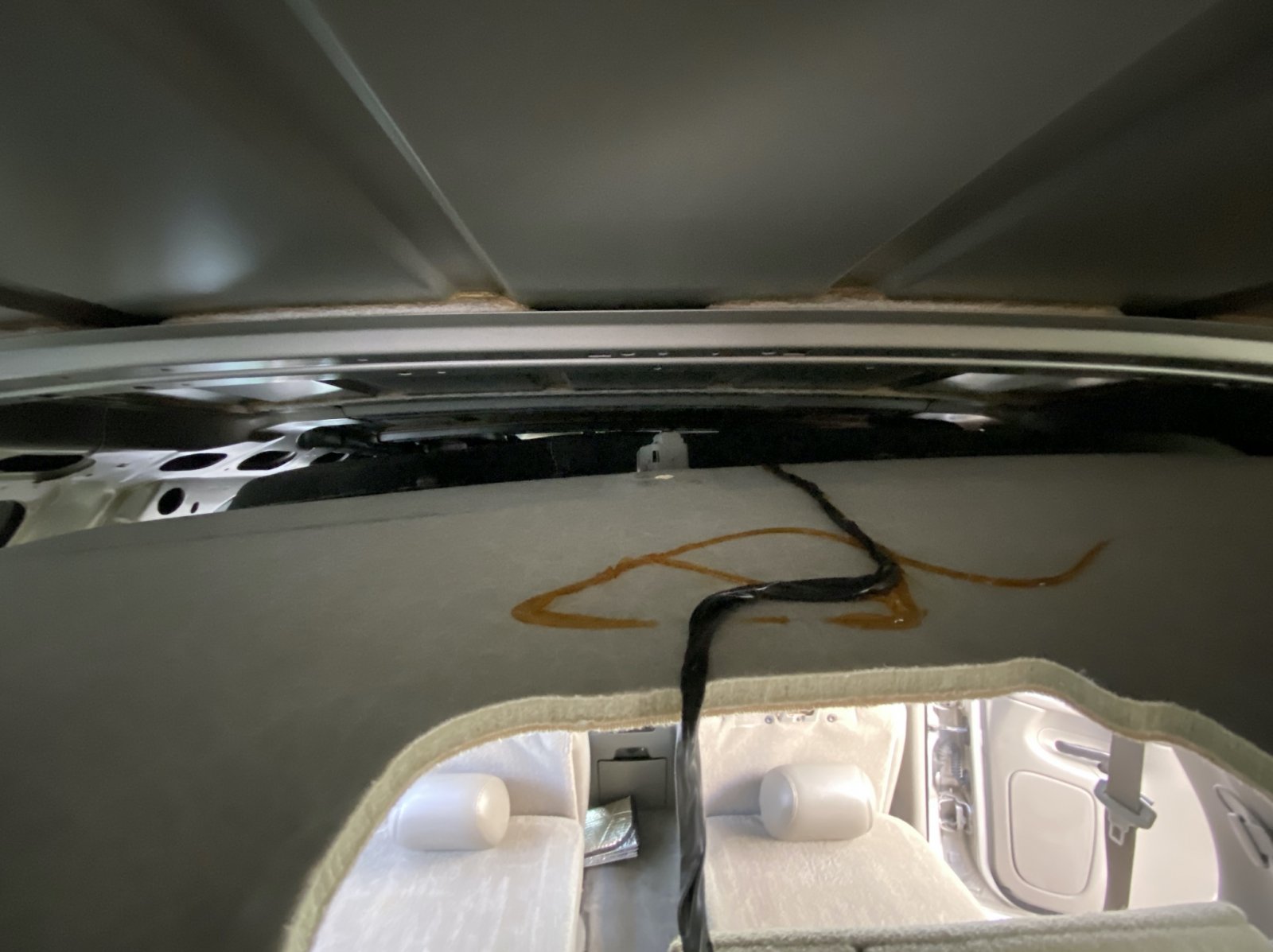

Here's how I accessed the rear aspirator. Use a panel clip removal tool to remove retainer clips in the headliner. (See last photo, 2nd tool from left is most useful) I don’t know if this method works on Suburban, ESV or XL’s rear aspirators. There’s a video earlier in this thread showing how to replace the front unit.
Let’s go!
Remove the upper plastic trim at the rear of the headliner by pulling straight down.
Remove both D pillar panels by pulling in and forward simultaneously.
Disconnect speaker wires. Set panels aside.
Remove the rear cargo light lens and then light housing by sliding it sideways and let it hang.
Remove both coat hooks by pulling and prying along the seam that joins each hook. Each hook is two pieces that when eventually pulled apart will release as an anchor and allow the headliner sides to drop. I used two small flat screwdrivers and gently worked around the seam perimeter. Refer to photos for expanded hooks.
Un-fasten the C pillar panels down to the seat belts by pulling in toward the center of the vehicle.
Use a bungee cord to keep them leaning toward each other as shown in photo.
Remove the grill from the aspirator with pry tool.
Remove the remaining two round retaining clips (circled in red) along at the rear and center of headliner with pry tool. The headliner should now drop easily at the rear.
Reach in through the rear being cautious not to bend the headliner too much thereby creasing it.
Unplug the old aspirator and plug in the new unit. Check for power.
Position the aspirator over the opening while another person attaches the grill from underneath. If going solo, you MIGHT be able to reattach the grill and hold the aspirator while accessing them from either side. If not, use a zip tie as shown in photo to hold the aspirator in place, secure grill and gently pull out zip tie. Take care to use center most grill holes to help orientate grill snapping into slots on aspirator. Remove zip tie, it’s the prudent thing to do!
Replace center clips in headliner and side hooks followed by the light assembly.
Push C panels back in place, reattach speaker wires, replace D panels and lastly upper plastic trim between the D panels.
Viola! Now celebrate this little victory with a frosty beverage.
Happy Trails!
