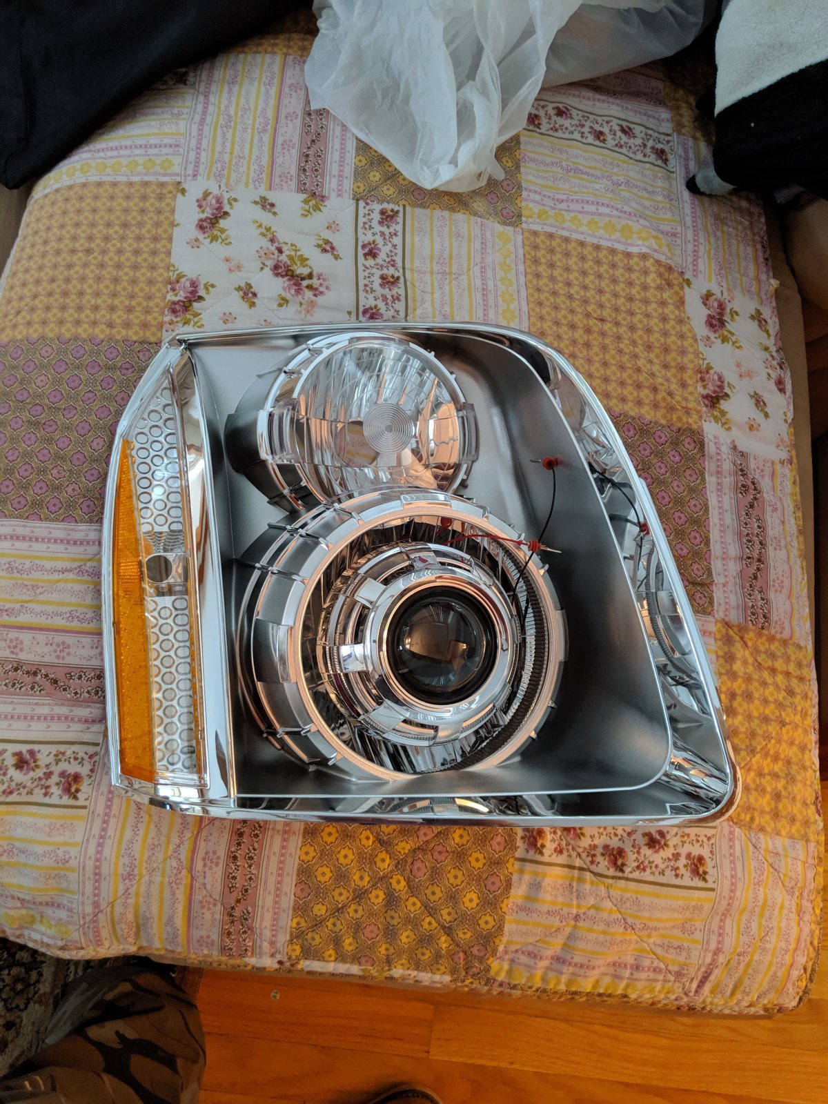

Looking for some input from guys who have done retrofits with hids. Ordered new housings and the morimoto mini d2s 5.0 Apollo 3.0 shrouds and a 55 watt kit all from the retrofit source. Got everything installed just fine but when I fire the lights up my drivers side works but my passenger fails to ignite. Tried swapping bulbs ballast igniters different relays everything. Same results. I have my drl disabled. Am I missing something

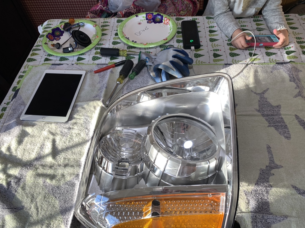

What headlamps did you buy? Do you have any more pictures? I'd like to see how you attach the projector to the stock reflector. I'm looking at the same kit from Retrofit source. Thanks.

On the back side of the orange reflector there is three or so tabs that I cut off and it came right off.

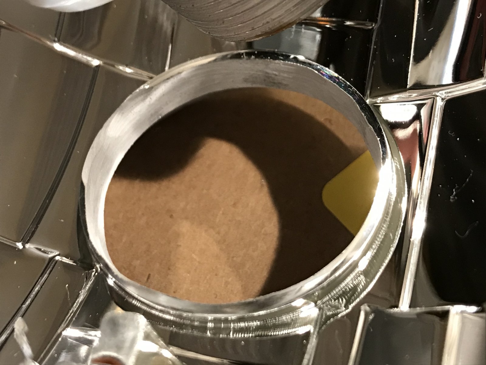

I'm going to ask this here first since you used the D2S 5.0 like I am. Did you use the rubber "gasket" between the projector and the reflector? I bought the tool to tighten the lock rings with and I've tightened it to the point where I'm scared to go much more and the projector can still be wiggled a little bit so I'm nervous that they'll move after hitting bumps in the road. They seemed to be more sturdy without the seal but I still fear that once big bump and it'll move and then the nut will be loose. I didn't grind down the lip on the reflector side because it doesn't look like the reflector is even on all sides so I wondered if that would cause problems also or weaken the plastic too much. I thought about taking the seal out and putting epoxy or something to attach the projector to the reflector another way once I get the beam level but if that doesn't work there'll be a huge mess left behind.

Maybe I just need to crank down on it more. I’ve got it pretty darn tight right now, at least I think I do, and I can still twist the projector a little. I feel like putting in the bulb and igniter might move it.
I attached a picture of the lip inside the reflector I was asking if you ground flush or if you left this one alone.
