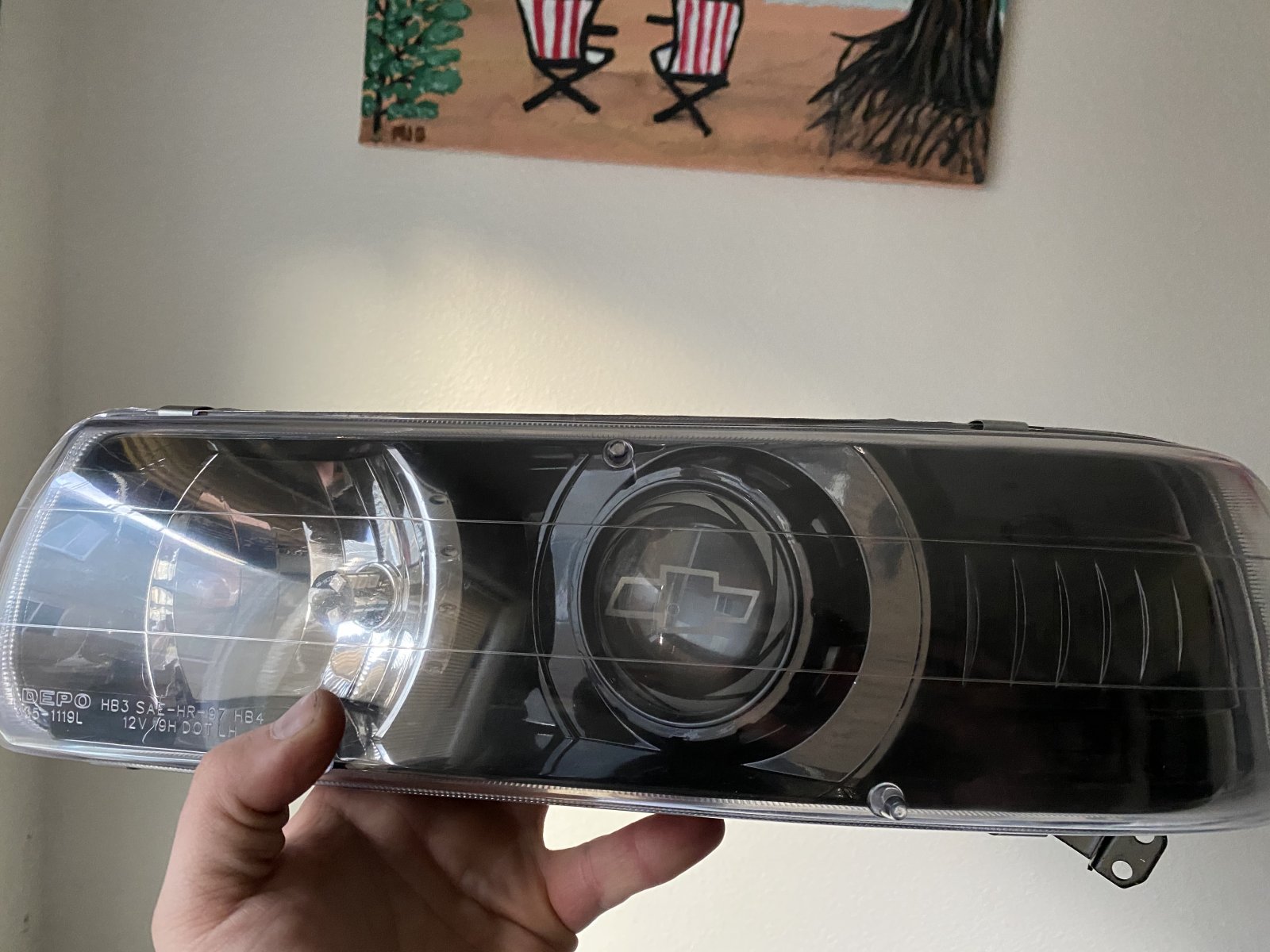

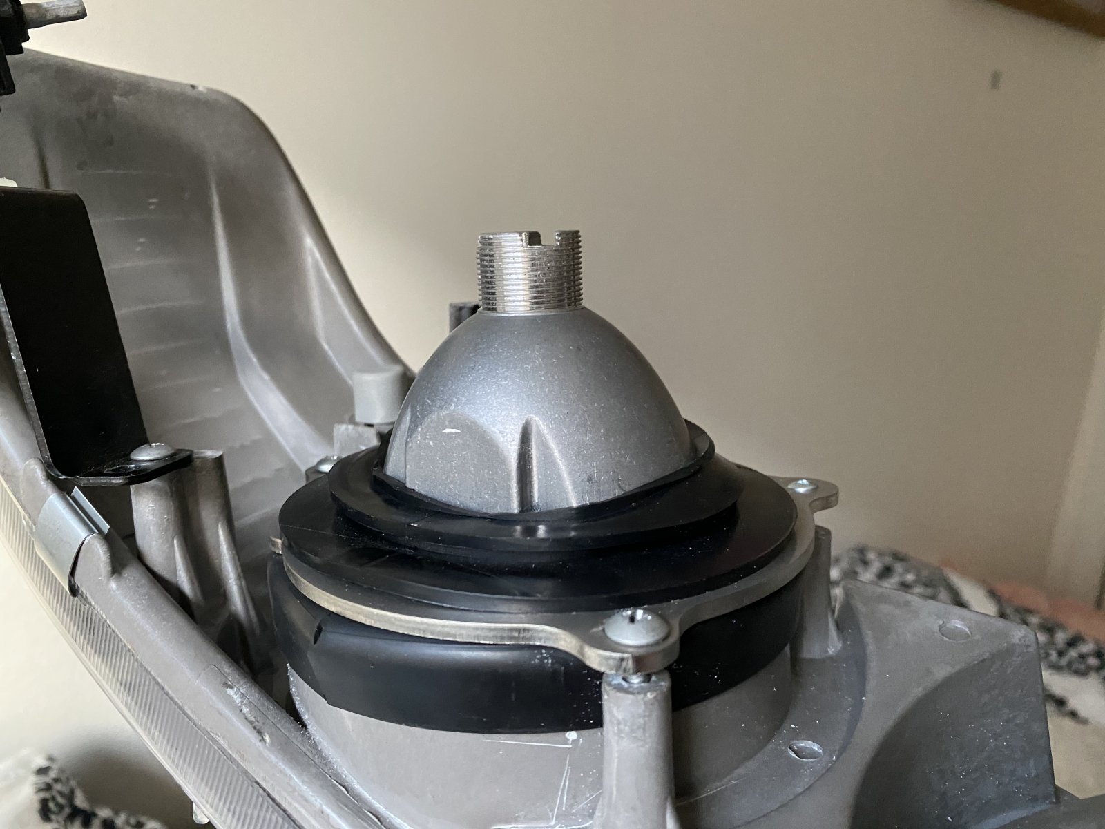

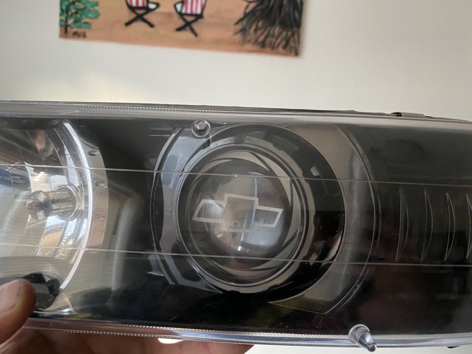

So I got tired of messing with the depo shrouds and just used the Gatling guns blacked out. Sealed up using rubber pieces so it’s all bolt up. Make it more accessible if needed for servicing or adding anything like rgbs.
52,954
View attachment 246965View attachment 246966 View attachment 246969
Looks good. I like the engraving on the projector. I see a gap on the rubber though so I’m thinking they’re gonna fog. I used RTV on the Anzo u-bar retrofits I did and I think they’ll come apart pretty easy if I need to. Way better than the permaseal that was on them.
05Single
afraid of the dark
Feb 26, 2015
8,244
11,648
Thanks , glad I got the etching, love the look. And there will be small gaps . Thoses will be filled with most likely some retrorubber I have left over
