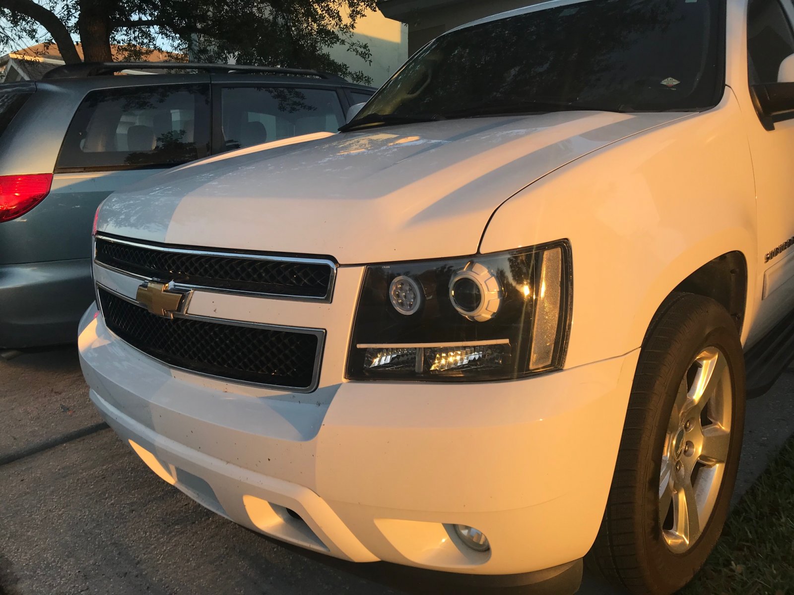

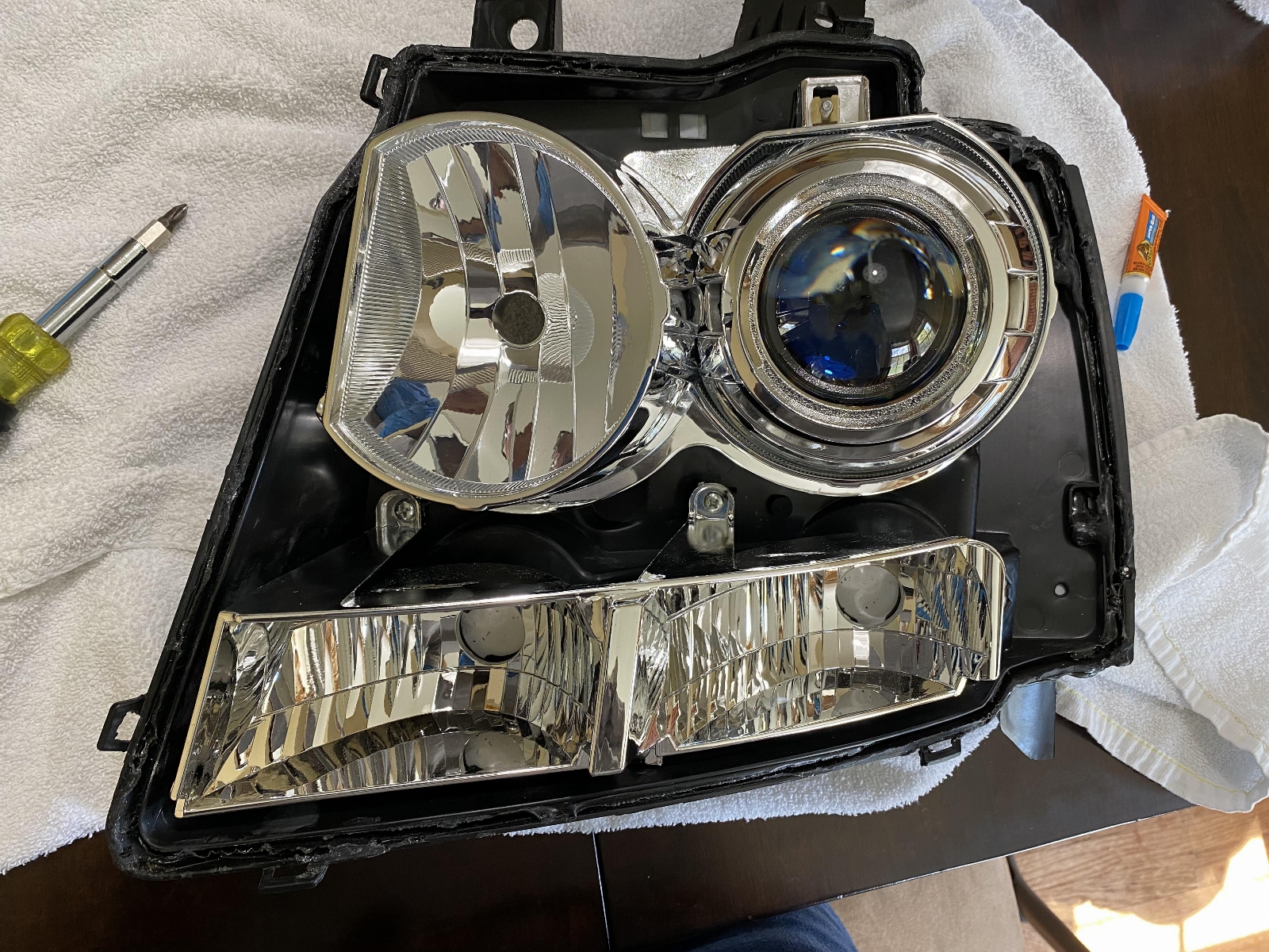

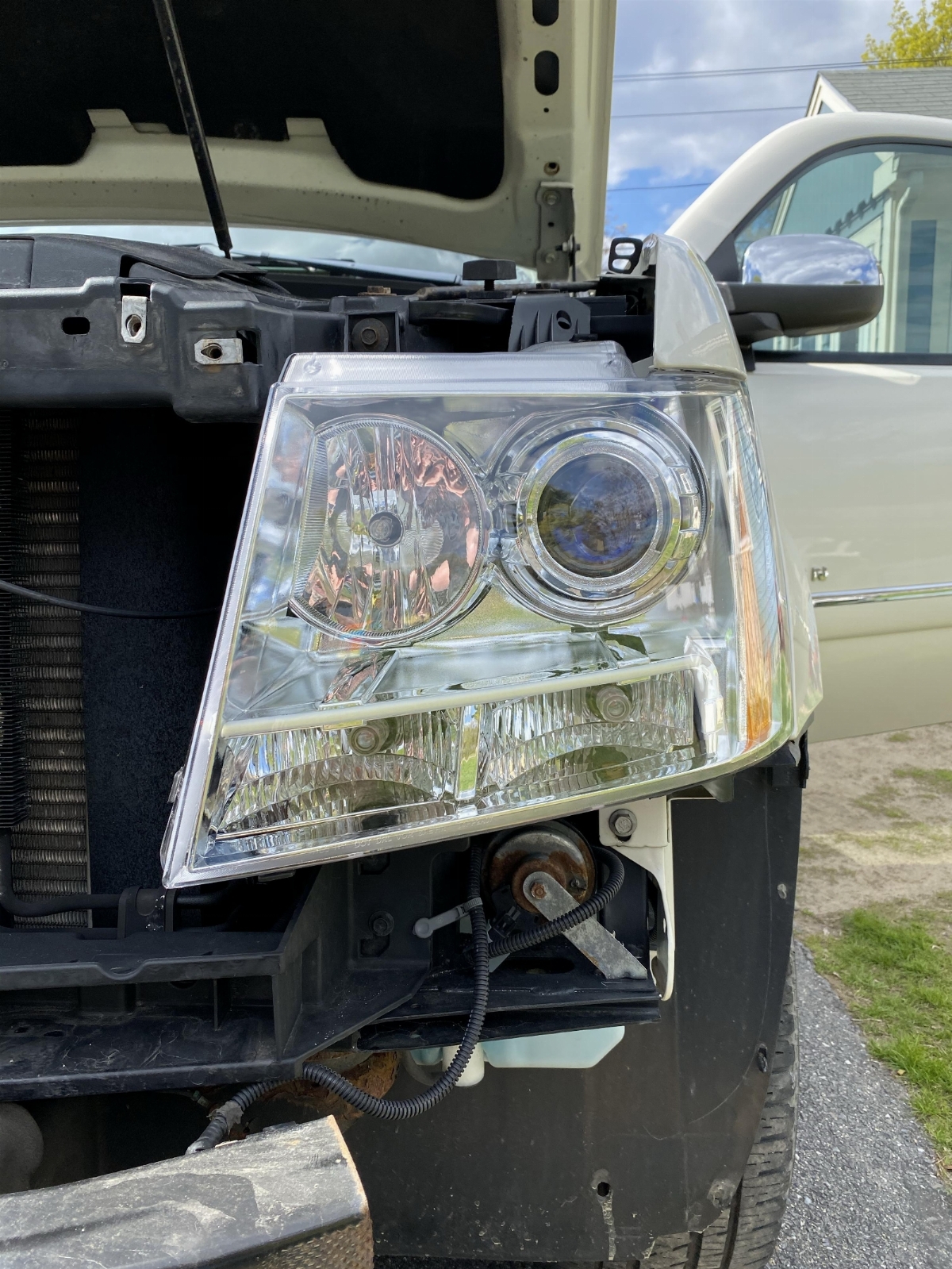

2010 suburban. Ordered amazon replacement headlights. Opened up and installed Morimoto d2s 5.0 projectors. Apollo 1.0 shrouds. 55 watt ballast with 5500k bulbs. Also installed Morimoto 3157 dual amber bulbs in the blinker and old drl location. Both wired to parking light only. Installed profile pivot led strips that are white for drl and amber for turn signal.

Looks damn good! Must have kids huh? :D

Sure do. Four now we had to get rid of the Tahoe and go for a suburban a while back. Just traded my Yukon for a grand Cherokee for the wife so I inherited the suburban. Had to do something about the headlights. They were awful. This was nowhere near as easy as retrofitting a Yukon. A lot more cutting and time involved but happy with the results

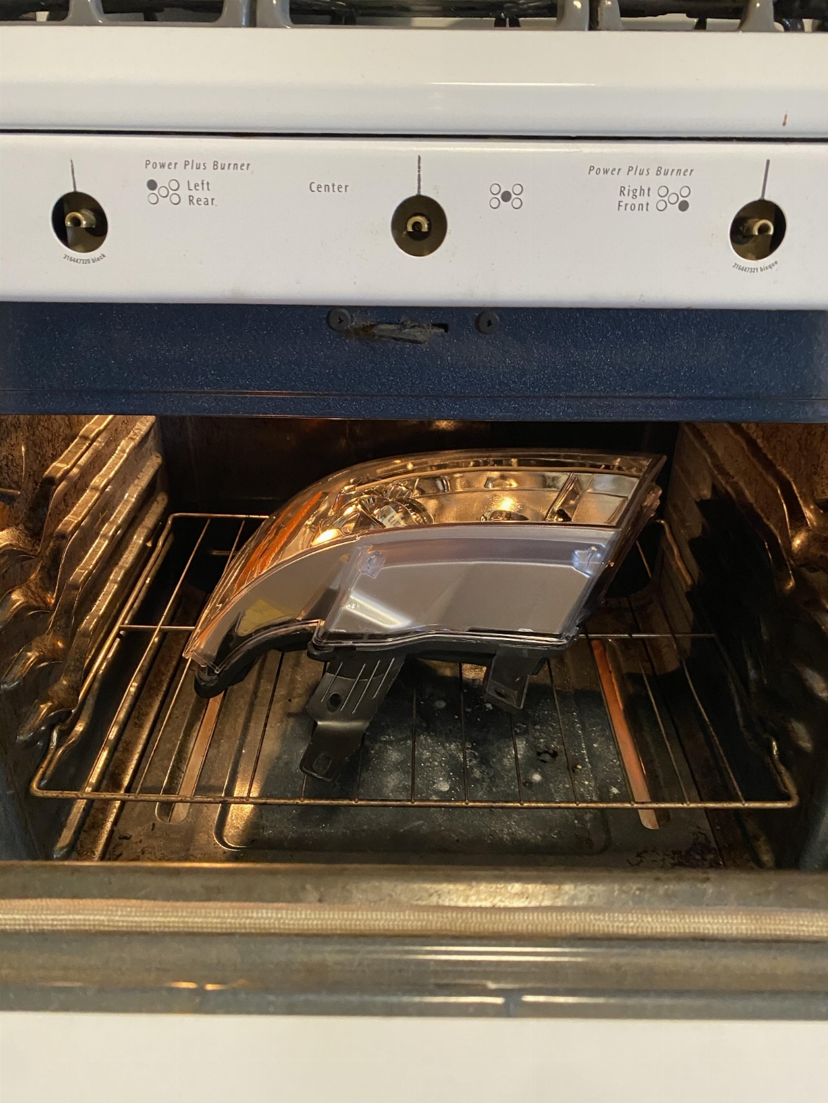

Missing knobs on the stovetop are always a dead giveaway. :D
