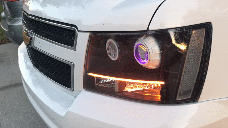

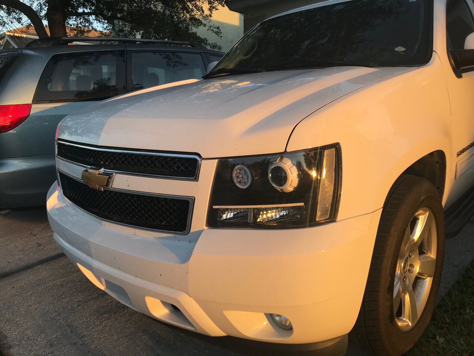

Finally finished this up a couple of weeks ago. What a job; I have total respect for folks who do this day in and day out.
headala
headala
Jun 10, 2019
37
23
If I had it to do over again I would:
  • Make sure I was buying quality aftermarket housings with butyl sealant. Mine were a bit cheaper than Depo but were lower quality, and had permaseal. Hours and hours of work to save a few bucks. And the adjuster slips on these quite a bit.
  • Put in the latest generation of LED projector, rather than the D2S. Yes, maybe not quite as good but so much easier to wire and to not have to cut the frame behind the low beam.
  • Map out how I was going to wire all of this beforehand. I ended up using quite a few relays and it became quite complicated. And I'm still working on tidying it up.
  • Use a template for drilling holes in the reflector for the bolts. Spend a few bucks, get perfect holes and rotation, sell it to someone else to use.
I'm happy to help anyone who wants to do their own, or answer any questions.
