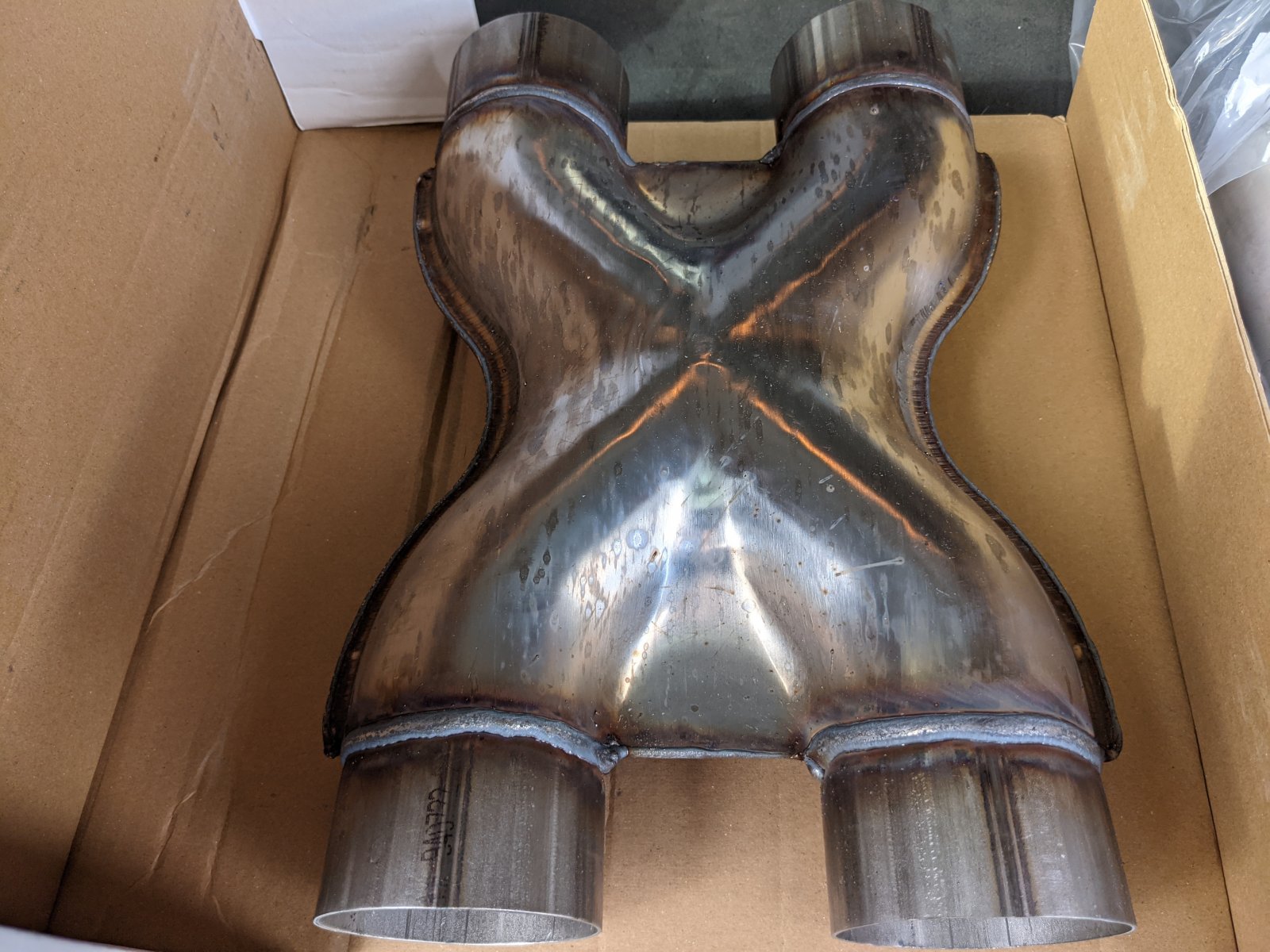

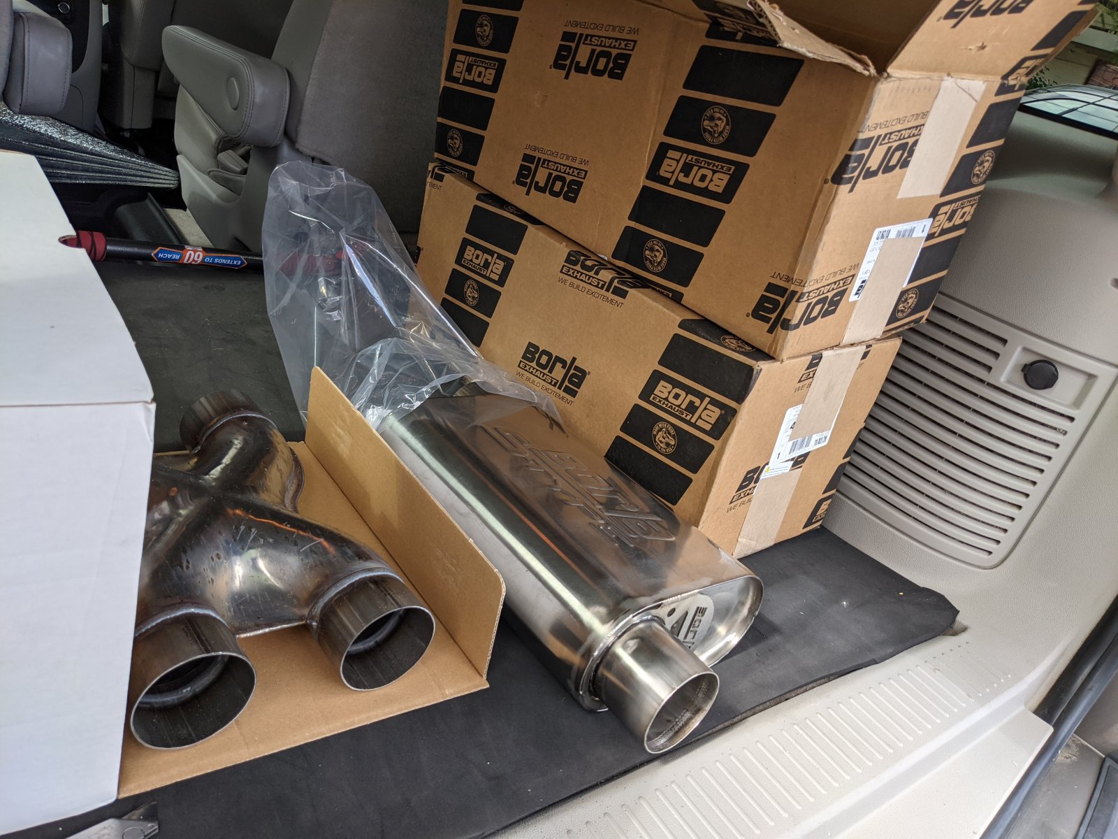

Just when I thought I was done spending money on this hoe.....
